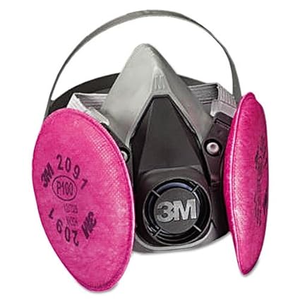

                            Nice, your lungs will thank you. Now you have the big expense add one of these to your amazon purchase. I have the first one and its only $14. dont wear it all the time but do when making lots of dust when milling stock or sanding projects.
                            https://www.amazon.com/3M-Facepiece-...ords=dust+mask
                            https://www.amazon.com/GVS-Elipse-SP...ust+respirator
