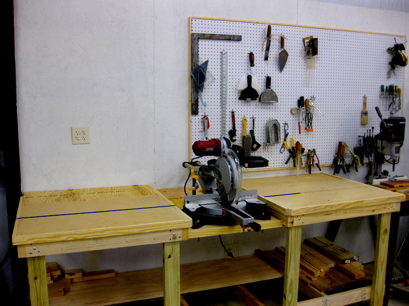

          I needed a CSMS for the new shop and my old 10" CMS wasn't able to cut some of the wider boards I've been using ... I decided I wasn't going to use it for fine furniture fittings so decided to go with a cheaper Harbor Freight #69684 ... HF 12 inch CSMS
          I got it for $129 on sale and bought a better blade from Amazon for $34.
          You are correct that a 12" takes some space ... the pic shows my setup ... 8' from end to end and 36" deep ... I've been happy with the saw but it is LOUD ... I'm deaf so it works out alright in the end ...
