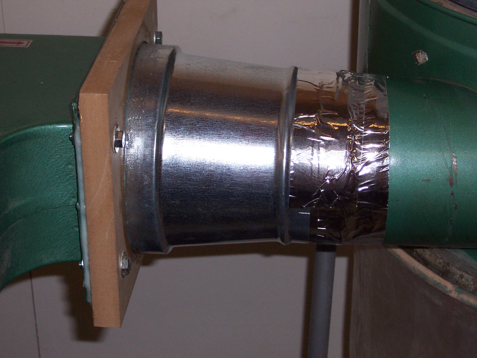

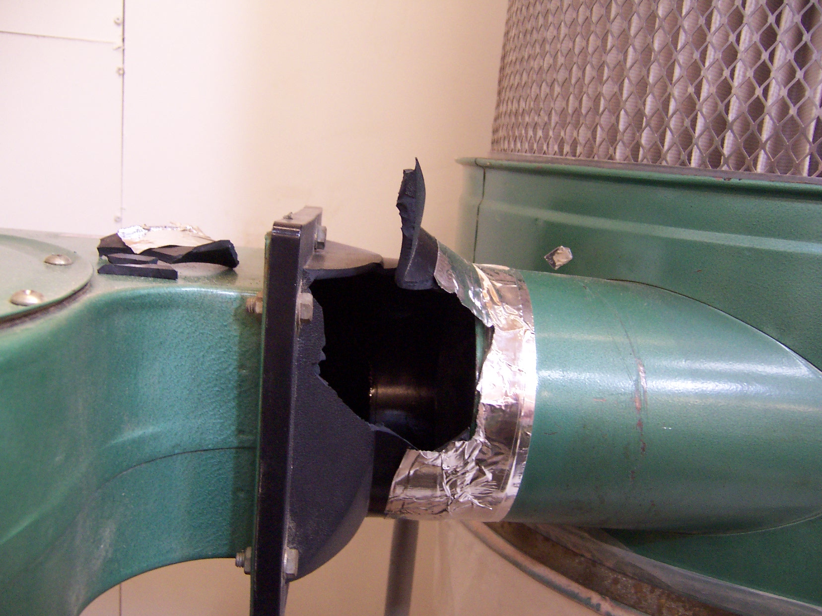

    I was setting up to drill holes for a mortise, and when I opened the gate at the drill press and powered up the dust collector I heard something travel through the tubing then KABOOM! I have found most of the pieces of the connection but still have not been able to determine what the missle was. All the drill bits are accounted for. Looks like I'll be building a two-stage system aka Thien seperator for my dust collector.

        Larry, you have reconfigured your DC unit in almost the exact same way I am planning to do mine -- the principal difference being that mine will have the motor unit flipped over, with the inlet pipe running down and under the floor. Other than the problem pictured above, how are you finding this arrangement? Do you see a noticeable improvement in airflow with the impeller housing connected directly to the inlet ring like this?

          with that damage you will need to look at the fan blade to make sure it isn't damaged as well. things like that are what the cross bars in the inlet are to reduce. I've read a number of comments about removing them and i wouldn't because of the increased ability to to what you see here.

            Not sure how you will be able to connect the fan housing to the filter ring without that broken fitting. I guess you can either epoxy it back together and tape it really well. Maybe HF has the spare part? Whatever, it would be interesting to know how the fan blades fared. I have had chunks of ipe get accidentally sucked up and scare the holy **** out of me but (TG) no explosions like you experienced.

              I'm beginning to think this woodworking hobby is more dangerous than I ever thought it was. Did you by any chance anger the gods of oak,cherry,maple etc? I've contemplated removing the cross bars in my DC because the planer would plug it, but you have just removed that temptation. Thank you. I stopped using the DC for shop cleanup because of occasionally sucking up something not intended.
              Glad there was no personal damage other than possibly temporary cardiac arrest.

                    Dang, did you check if you threw an impeller blade? I hope you can purchase that part. Otherwise, a little fiberglass and epoxy will fix her right up

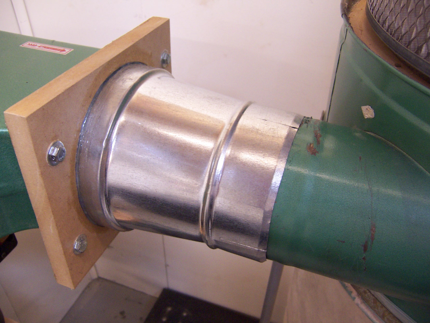

                      First - thanks to all for the repair suggestions, second - thanks to all who had a humorous comment/suggestion as it helped to ease the pain. Below is my solution; I used a 6" to 5" sheet metal reducer and made a new flange from 3/4" MDF with lots of caulk. So far it seems to work well at least as good airflow as the original plastic one.

                        Ah. Nice. VERY nice. Thank you ... now I know how I'm going to do mine!
