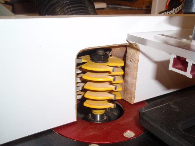

    Supposed to have 5/32 fingers which is what they measure but the spacing between fingers appears to be 11/64 (1/64th more than the fingers) which makes a loose fit.
    Does anyone know if there are some small spacers to remove between the five wings? They call it an "adjustable" bit...
    Going to have to take it apart later.
    Now that i've taken it apart and made some caliper measurements I know why this bit is a third the price of others...

    Well the nominal 5/32 wings should be .156" but measured about .162 and and the resulting slots cut around .172"
    The fingers should on a good day measure the same as the above spacing between the fingers, but measured about .142. All measurements around +/-.005 grouping.
    So it appears that the wings are a bit oversize and worse not quite planar. Taking it apart, there is a thick spacer between wings and one or two shims (.01 and .02 shims) so I'm going to have to find some .030 stock and make some shims to make more fat fingers to get more snug fitting joints.

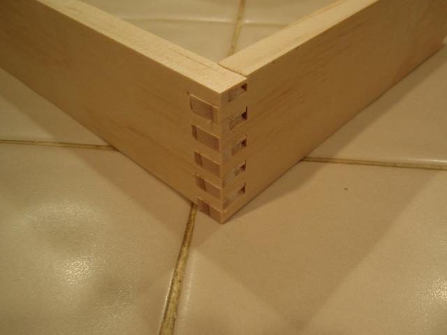

        well, I got the $25 bit all shimmed right, they all fix snugly.
        Looking all over for some shim material, turns out some old expired credit cards i had were about .029" so i cut them into shims.

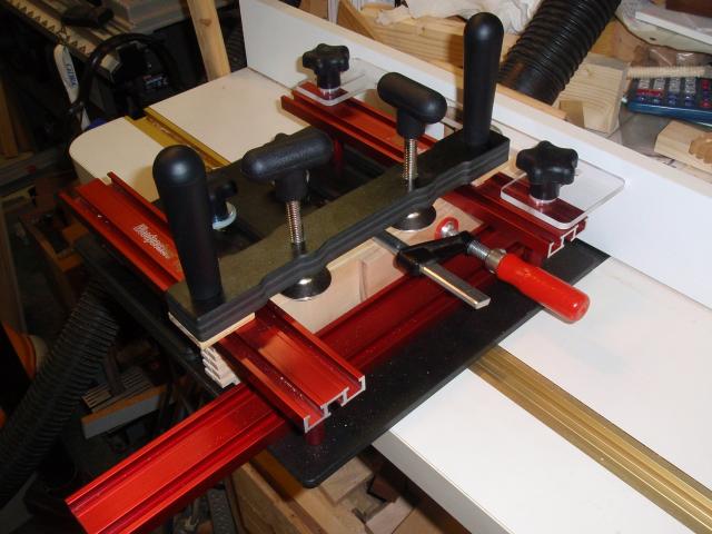

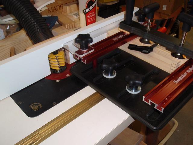

        The New Woodpecker coping sled is nice. And i built a new router fence for the occassion, including a good dust port. Once i got it all adjusted, i was able to cut four 3/8" boards at a time - used the extra clamp to hold them together with a backer board as you can see.

        Because of the extreme height of the bit and the height of the workpieces (1.75"), I had to shim the clamping beam of the coping sled up by 1/4" - you can see the shims between the black beam and the red extruded T-tracks the beam rides on.

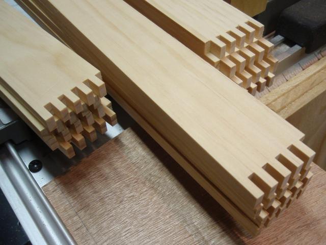

        In that last picture, the last test fit I missed getting the boards to match height by .010".
        To fix that I had to raise the router bit .005", half the difference. That was 1/3 of the 1/64ths (which is .016) marking on the Bosch 1617EVS height adjustment knob... very touchy - but it worked.
