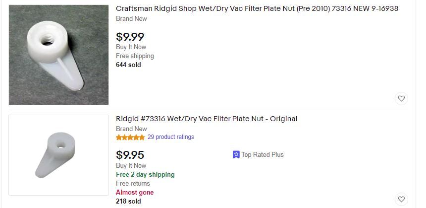

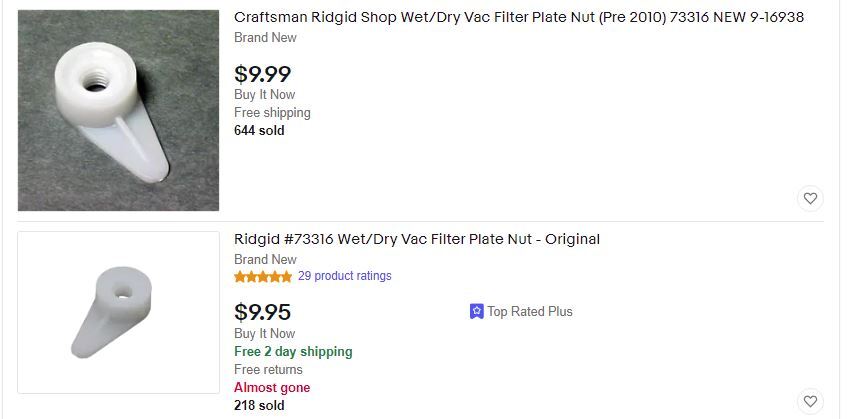

                      For Future reference,
                      Most vacs seems to have a 7/16-14 TPI (standard SAE fractional size, but not that popular compared to 3/8 and 1/2" nuts) stud for mounting the filter and a holder. And a nut to retain them in place.
                      Generally a plastic -half wing nut like these you can replace on eBay Click image for larger version
Name:	shop vac filter nut.JPG
                      But my suggestion is just go to the hardware bins and get either a 7/16-14 wing metal steel wing nut or a 7/16-14 Hex nut (You'll probably need a wrench) or even a Nyloc friction locking nut. Any of which can be had for less than a buck.
                      Generally you don't tighten them too much or it crushes the plastic holder that cups the filter.
