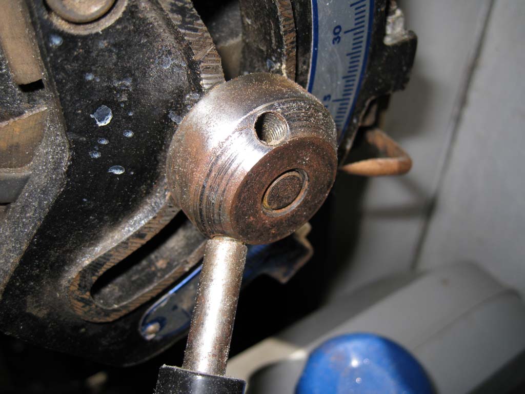

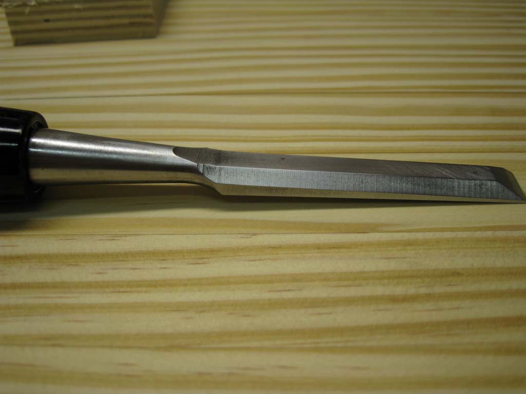

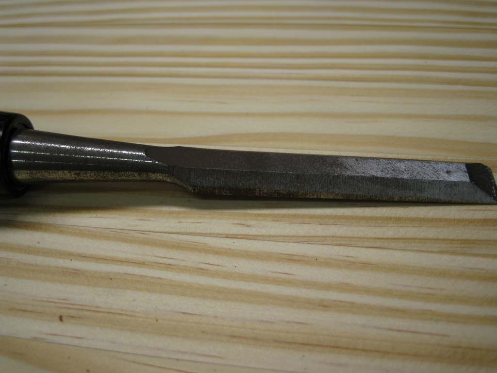

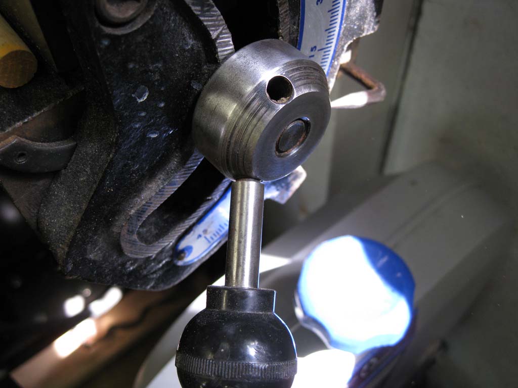

                        I didn't even pay attention to the package. The erasers are Sandflex made by Klingspor. I wish I ran across these way before. They work much faster than steel wool or sandpaper. Here's some comparison shots and I only spent a couple minutes on each:
