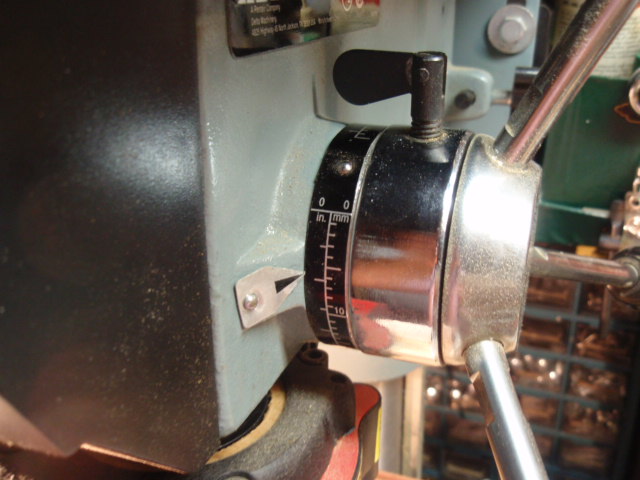

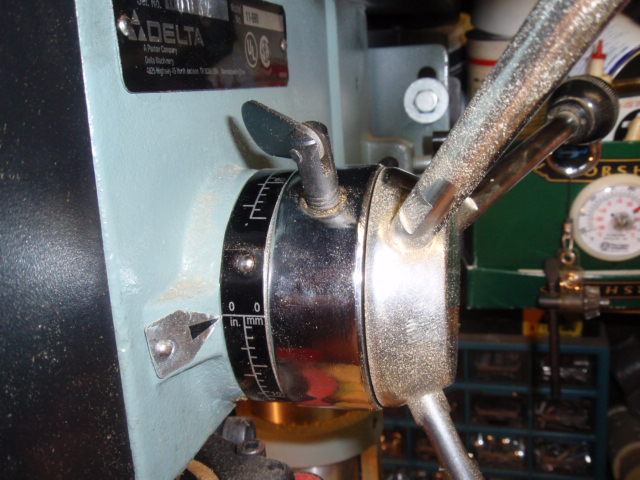

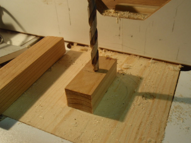

                    How it works:
                    the hub ones by Delta have a rotating scale and stop and a little thumb lock (seen in the second and fourth pics). Note the black ring and silver ring withthe thumb lock are one piece and can rotate separately from the hub handle until the thumb lock is tightened.
                    Holding the quill at some point between top and bottom of travel, I can turn the hub stop from anywhere on the scale until the hub stop stops turning at zero and won't go further. I lock it at this point with the little thumb lock, and the release the quill handle, the quill goes back to the top position. If I lower the quill now it will stop precisely at the zero on the hub stop where i set it earlier.
                    So I use it one of two ways.
                    One: I want to drill to a known position I can lower the quill to this position by sight (first photo), or by placing an sheet of material of known thickness (or even a brass setup bar) on the table, or by putting the bit into a hole whose depth I want to copy. While holding the bit at this depth, I can easily use my free hand (and sometimes the fingers of my quill holding hand) to rotate and lock the hub stop at zero (second photo).
                    Now placing an item on the table I can confidently drill to zero and the predetermined stop point. Using a 1/8" inch thick piece of wood as the stop point I can very confidently stop the drill bit precisely 1/8" from breaking through the back side of a piece of any thickness. I have used this technique to drill within 50 thou of breaking through thin pieces.
                    Two, drill a hole a certain depth in a piece. To do this, I set the actual workpiece under the bit. I lower the bit to just kiss the top of the piece (third photo). I then rotate the hub stop to the scale depth I want - say 1/4" (on the fourth photo). Now, when I drill, the hub scale will indicate 1/4" at the surface of the workpiece, and as I drill, it will go to zero, where the hub stop prevents the quill from going further. I have just dialed in a precise 1/4" hole referenced off the top.
                    Advantages over the threaded nut stop:
                    I find some of the threaded stop rods to be flimsily attached to the drill press and very spongy in their stop action, i can over travel by pushing hard whereas the hub stop is very positive and locks with very little force.
                    Both nuts need to be run up or down on the nut stop, this can take along time if the travel is large and if i only use one nut, the vibration makes them move. The hub stop can be unlocked and flipped the entire travel in one smooth motion. To use the DP at full depth with no stop I have to move both the nuts all the way back to the top (time consuming) and lock them (or they ride down and eventually stop my quill travel unexpectedly. The hub stop, I just unlock the thumb lock which allow the hub stop to rotate freely and the quill travel to be unimpeded.
                    Precision - the nuts, when I use the scale I have to difference the values in my head. There's no pointer, the nuts are not precise against the scale. In contrast the hub stop has a pointer and an expanded scale and is very easy to set and all is referenced to zero - relative indexing either to the top of the wood or the exact depth point.
                    Overall I just really find the nuts annoying, slow and imprecise and the hub stop very quick and accurate to use.
