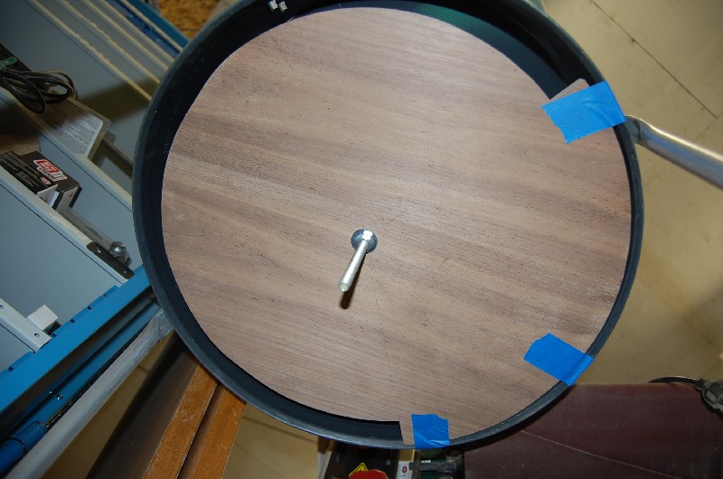

                You might install a Phil Thien baffle in the dust collector that should prevent undo filter plugging and come close to cyclone quality dust separation . see picture attached.
                The HF dust collector will move about 1300 cfm but with a 4" hose it is only moving about 650 to 700 at the device. The longer the hose the less cfm you will move and you will have less dust collection capability. Please remember that the DCs purpose is removal of large particulate. Small dust removal is the purpose of a high volume filter assembly.

                  I think the Neutral Vane is there to do what a Thien Baffle would do. But if he builds a Thien Baffle / separator lid and removes the neutral vane, he should be catching all but the finest particles in the trash can. The neutral vane would be simply redundant, and potentially an air flow restriction. (Gonna have to get the input of someone more qualified than me on that part...)

                  I think my first steps would be to upgrade to a Thien cyclone, eliminate the neutral vane, straighten any bends, shorten hoses, and make sure that Wynn filter is clean... That SHOULD get everything moving along just fine... If you still aren't catching stuff at the planer, then investigate what it is about the planer...

                    The Thien baffle assembly incorporates a neutral vane assembly by having the pipe elbow drop down between the baffle and the top.. The elbow is a neutral vane, with the neutral vane that is installed on the DC adding the baffle would make a Thien separator out of the DC collection bag area.
                    Just adding the baffle to a side ported assembly would not separate as well as as the Thien separator does without installing the Neutral vane.

                              Couple of points:
                              (1) Replacing your neutral vane with a baffle on your DC's ring will significantly reduce the amount of material that gets to your filter. Do not use the baffle WITH a neutral vane, it will work better without one.
                              (2) If you use a separator, add the baffle there, too.
                              It is possible that some of the drop in CFM you experienced after adding the separator was due to the fact that your filter was already plugged. So I'd add a baffle to both the DC ring and the separator and try again. If you still aren't getting enough CFM at the planer, then you may have to eliminate the separator, but you'll still have the baffle in the DC ring which will keep the filter from plugging so quickly.
                              If you really have your heart on a separator and the one you have isn't cutting it, you can always make your own with a side-inlet.
