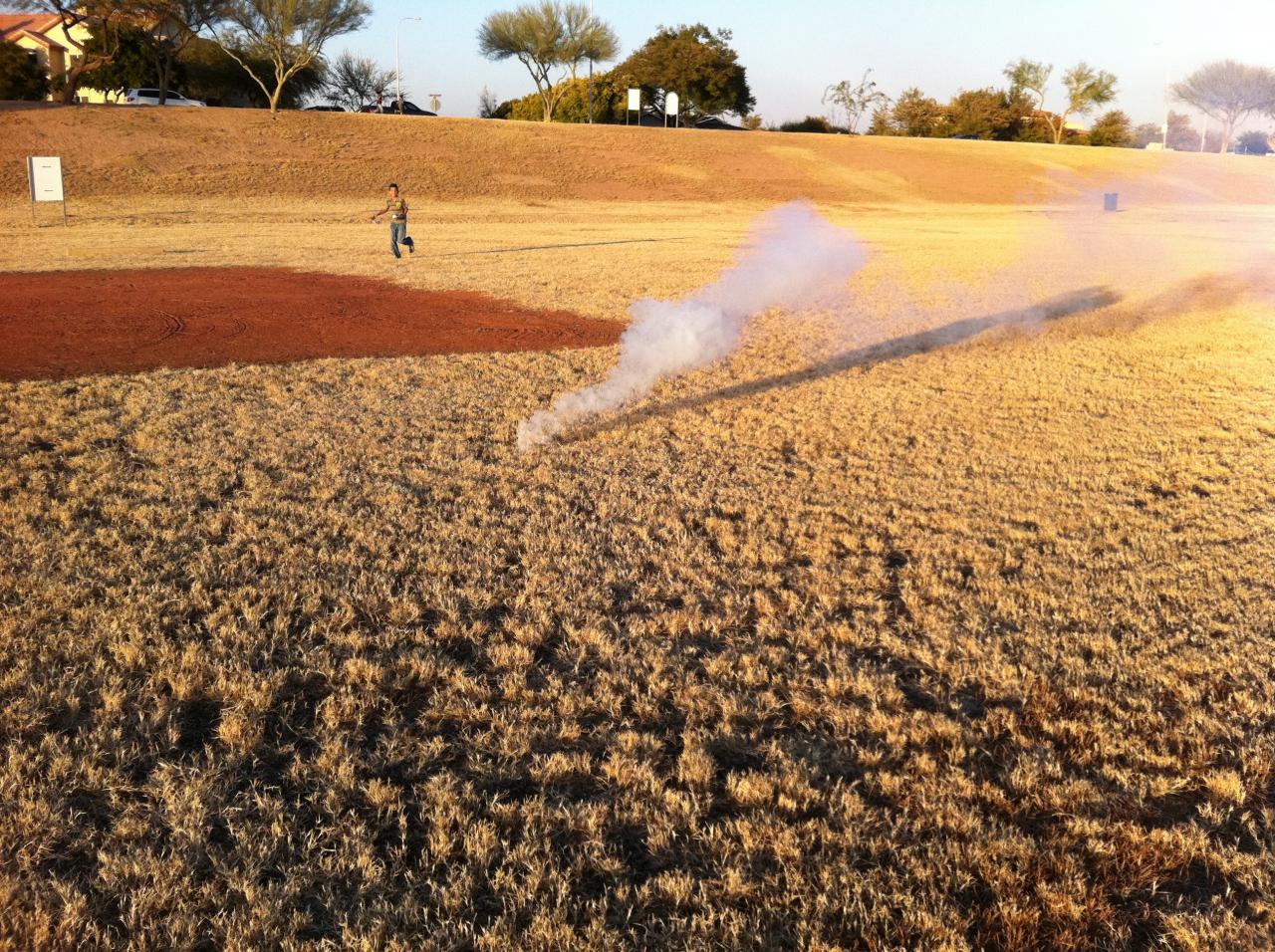

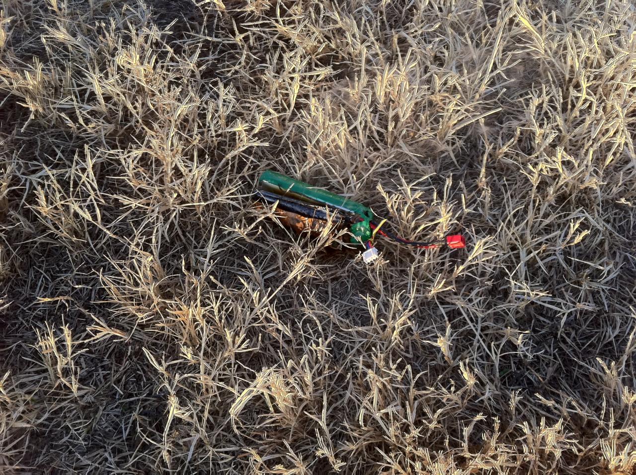

    Don't buy into the fearmongering. Lipos do not explode unless they are physically punctured, though they can catch fire. It's mostly a non-event, I've had a few fires in my RC stuff. And they are not flaming infernos, they are a little hiss and spitting like a firework (when we talk about the small batteries in tools). Nicads and NiMH were the ones that could explode spontaneously. I have yet to see a tool battery that doesn't have its protection circuit built into the battery. They could exist, but that would be dumb, and just not normal at all. Out of the 100+ Lipos in my house right now, the only ones with no protection on the battery are the ones for hobby RC stuff, because they are not consumer items, and users need to know how to care for them. Consumer Lipos have protection from consumer abuse.
    I whacked a small Lipo with a hammer and chisel, which did explode, since it's releasing all the energy almost at once (wearing my welding gear and more). I've shorted and otherwise abused Lipos to see what happens, and it's no big deal.
    Here's a Lipo fire in my kid's plane, and that was a pretty powerful battery that was heavily abused by crashes with him trying to learn to fly...

      Agree that it would be foolish for a reputable tool manufacturer to not build in protection to the battery pack for Lithium-type batteries - protection in the tool does little good to protect a battery that is shorted, for example. Agree that RC batteries often (always?) lack built-in protection.
      I do disagree on the LiPo statement "And they are not flaming infernos". The one condition that you didn't cover is improper charging. Drive even a moderate charging current into a LiPo pack that doesn't have built-in protection (like a consumer R/C pack) beyond the proper charge termination point and you will get an impressive flaming inferno that won't stop until the pack is utterly consumed. I saw it with my own eyes (and smelled it too). I'll never forget my coworker's scream at the sight of the fire burning more intensely as each adjacent cell caught fire. The entire office had to go home for the day due to toxic fumes.
