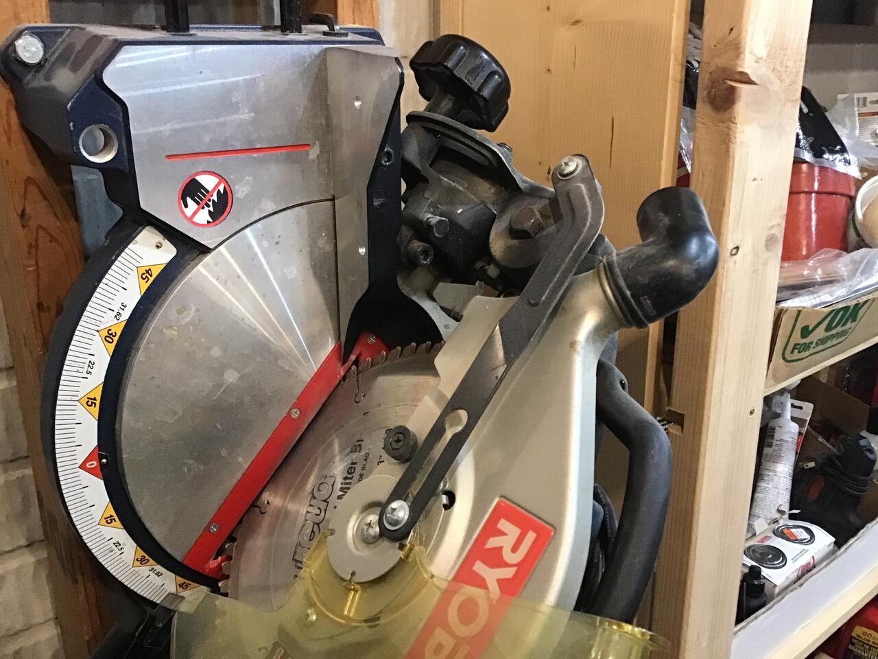

    My CMS is bad and it has a vac port in the hood that just doesn't catch what is thrown from the actual cut line. The good thing is that dust collects at the base of the saw. My hand held plunge router is the actual worst spewer of wood waste. There's just no way to position a hose near its operation.
        Click image for larger version  Name:	IMG_0764.jpg Views:	0 Size:	169.1 KB ID:	860883
        My CMS throws a lot of dust into the dust chute which I have connected to a small shop Vac, there's a lot of dust collected there. Unfortunately the CMS also tosses a lot of dust elsewhere. Its not so much that it doesn't go into the chute but that maybe its only half- to two thirds..
