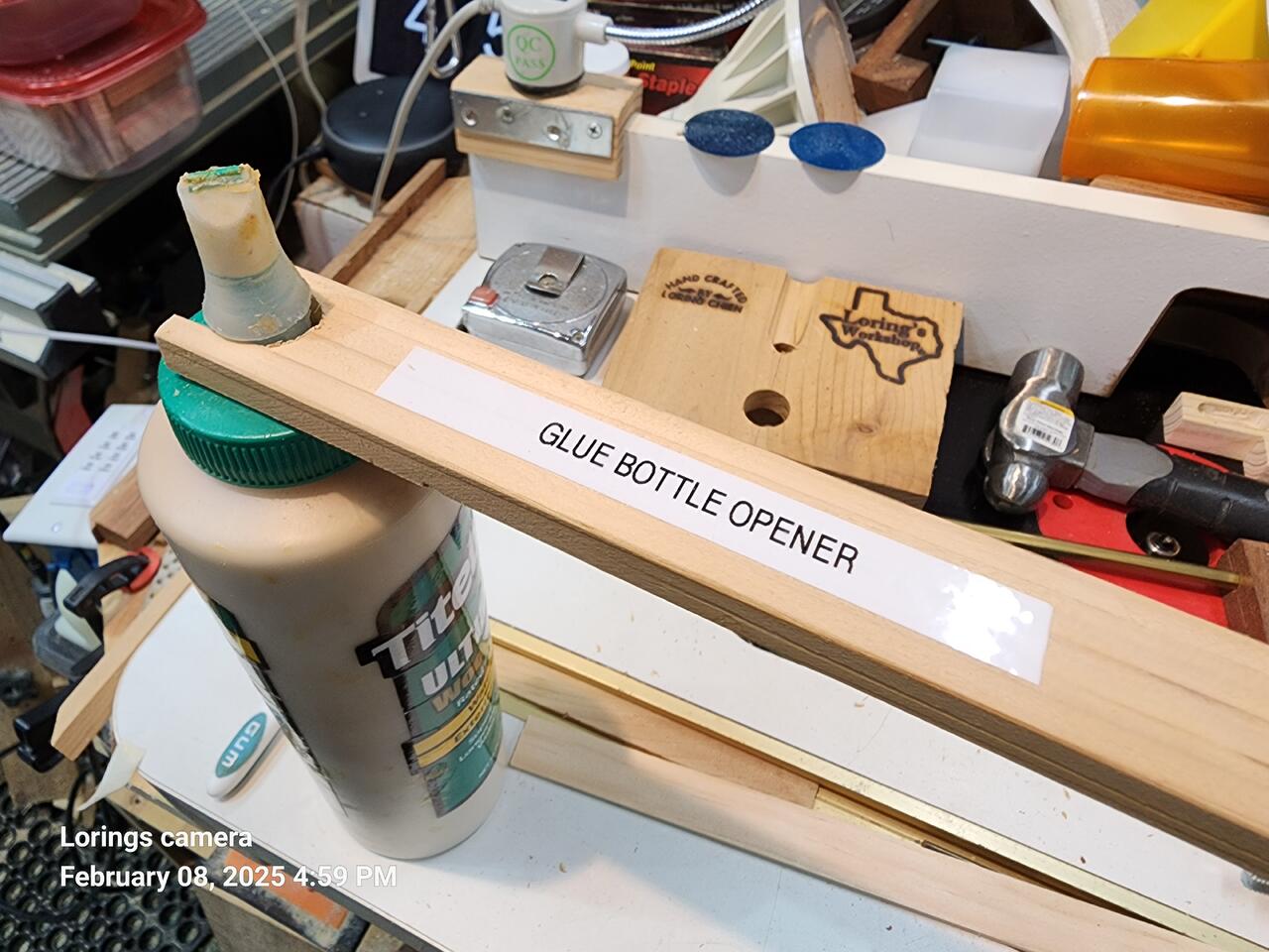

    Idle time 10 minute project glue bottle opener
    Click image for larger version  Name:	20250208_165924.jpg Views:	0 Size:	149.8 KB ID:	860446
    got tired of seeking a pair of pliers to open stuck glue bottle. Weird size diameter. 0.577", a little bigger than 9/16" (0.5625).
    OK probably took 20 minutes by the time I was done with the rounded end and hole for hanging you can't see.
    Mine is way longer than it needs to be.. Length 4-5 inches probably right
    Stock was 1" x 5/16" thick. 11/32" is ideal thickness, 3/8" is too thick.

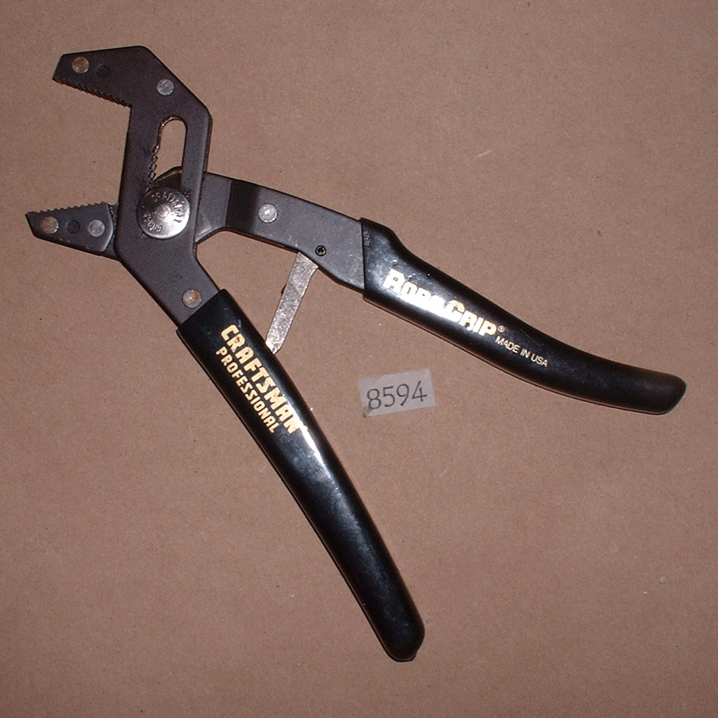

      Neat. I use a pair of Craftsman Robo-grip pliers that hang on the shop pegboard wall when faced with a stuck glue bottle top. My biggest issue with glue bottles is the spout getting clogged internally. The clear sliding cap on TiteBond bottles used to be able to be popped off (small diameter screw cap), but the newer larger caps don't have that capability that I've seen.

        If you pull hard enough (pliers required) , the sliding piece comes off and you can clean/clear it.
