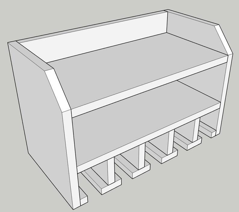

    I'm thinking about making a hangar for the 4-5 cordless tools I usually use in the shop and perhaps a charging station.
    Anyone have any good designs, comments about usability that they have encountered, experiences?

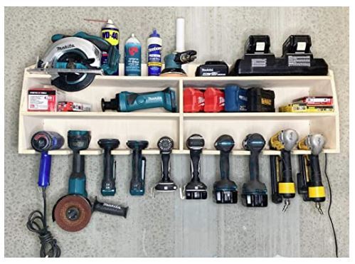

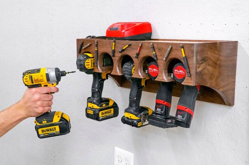

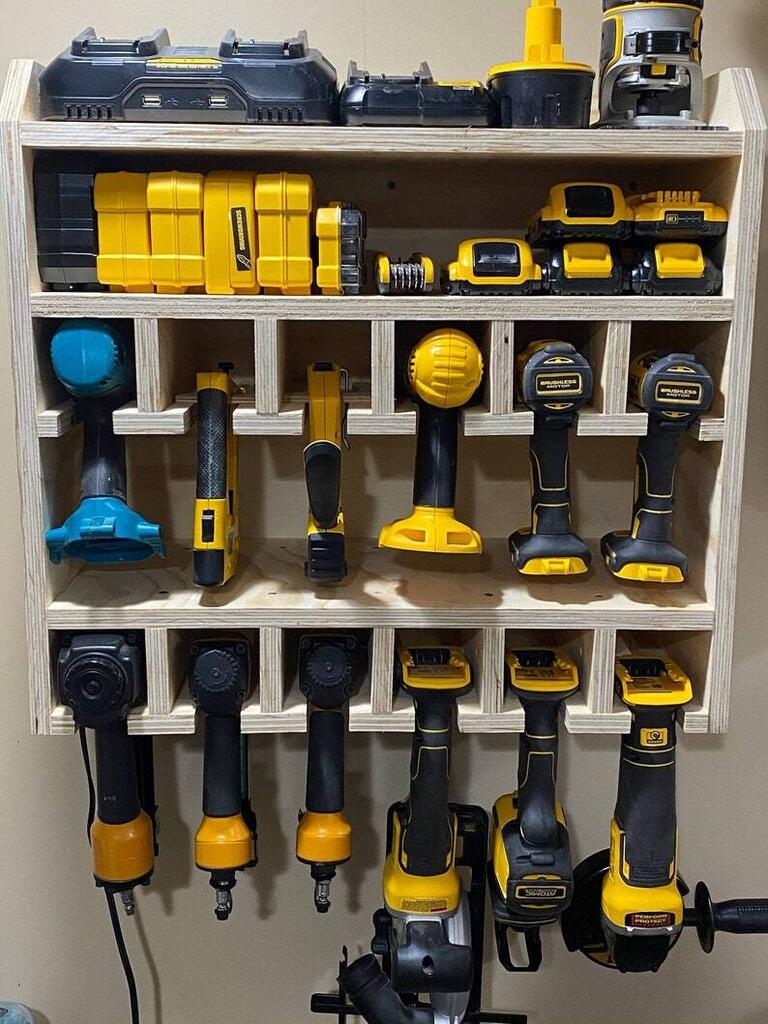

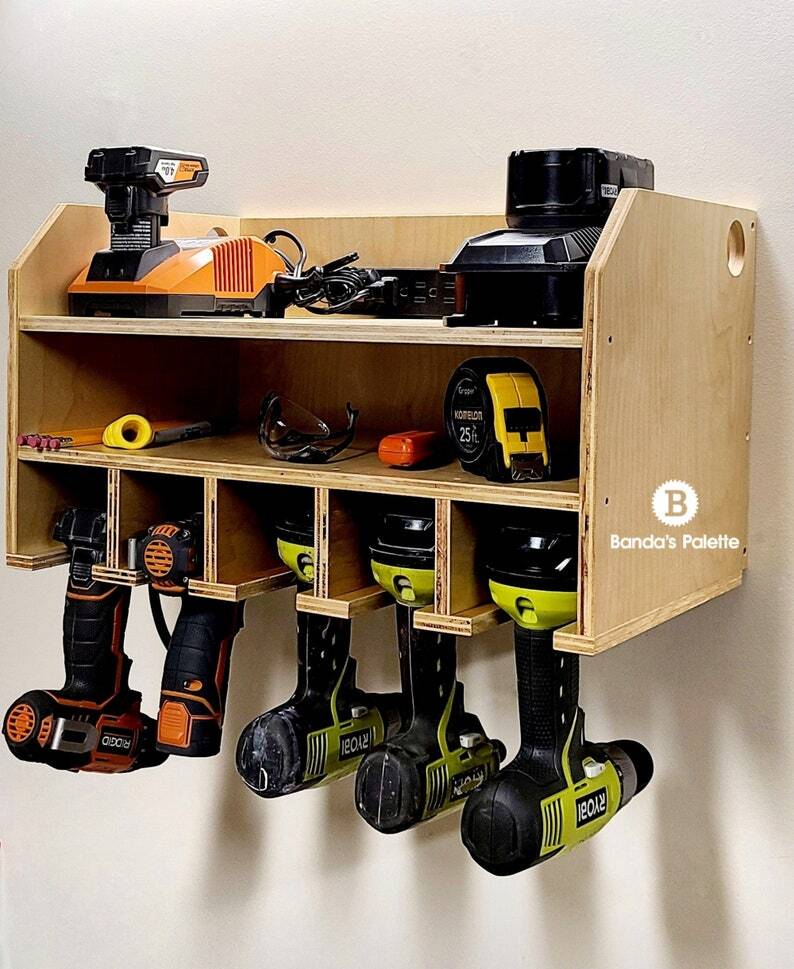

    One example from the internet. Seems un-necessarily complex to me. Why does it need the separators? to keep the tools from twisting? If stored up high and out of the way it will be hard to see the lights on the charger which are aimed at the ceiling. And even to put the batteries into the charger,
    Should you make the bays to store tools with battery attached or with the battery removed?
    All my tools share the same battery packs but I have them in two different height/capacities. I'm thinking of a shelf for loose batteries (instead of attached as in the example), to save some vertical height. Does that make sense? Or not?
    Tilting the charger so that you can see the lights? Or Charger vertically mounted on a backboard (it has keyhole slots) so you can see the lights; the batteries would then plug in horizontally but there's enough friction to keep them in.
    Some plans have the motor on top, some have the tool hang by the battery base. This one shows them hanging both ways. Since my tools all share the same battery and therefore battery base design I'm thinking hang by the base. Esp. since one is a right angle slim drill that can't hang from the motor side.
    Click image for larger version  Name:	corless tool storage.jpg Views:	0 Size:	108.2 KB ID:	848139
    More examples attached

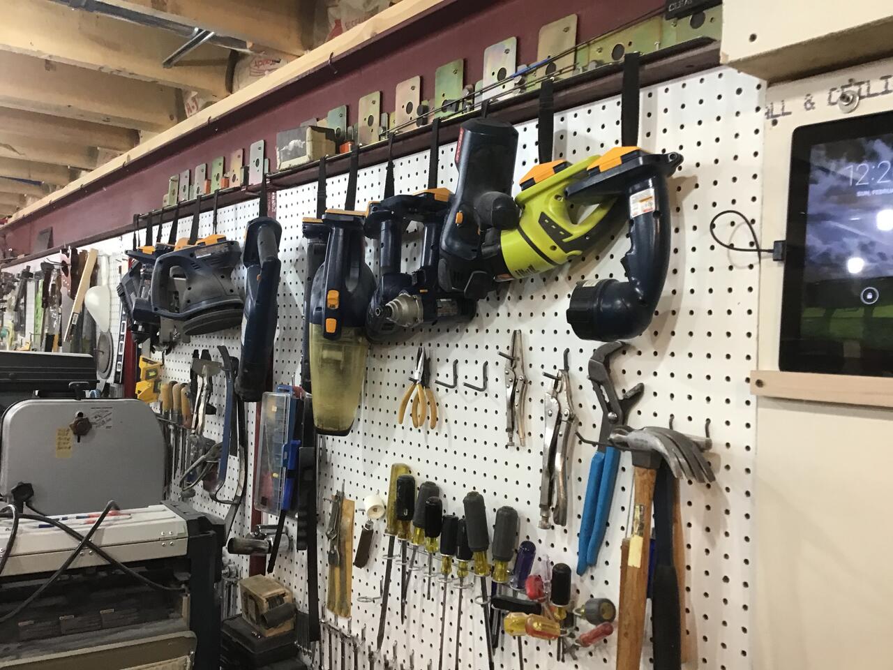

      Welcome to the bat cave. The chargers are on a pegboard shelf farther down the wall.

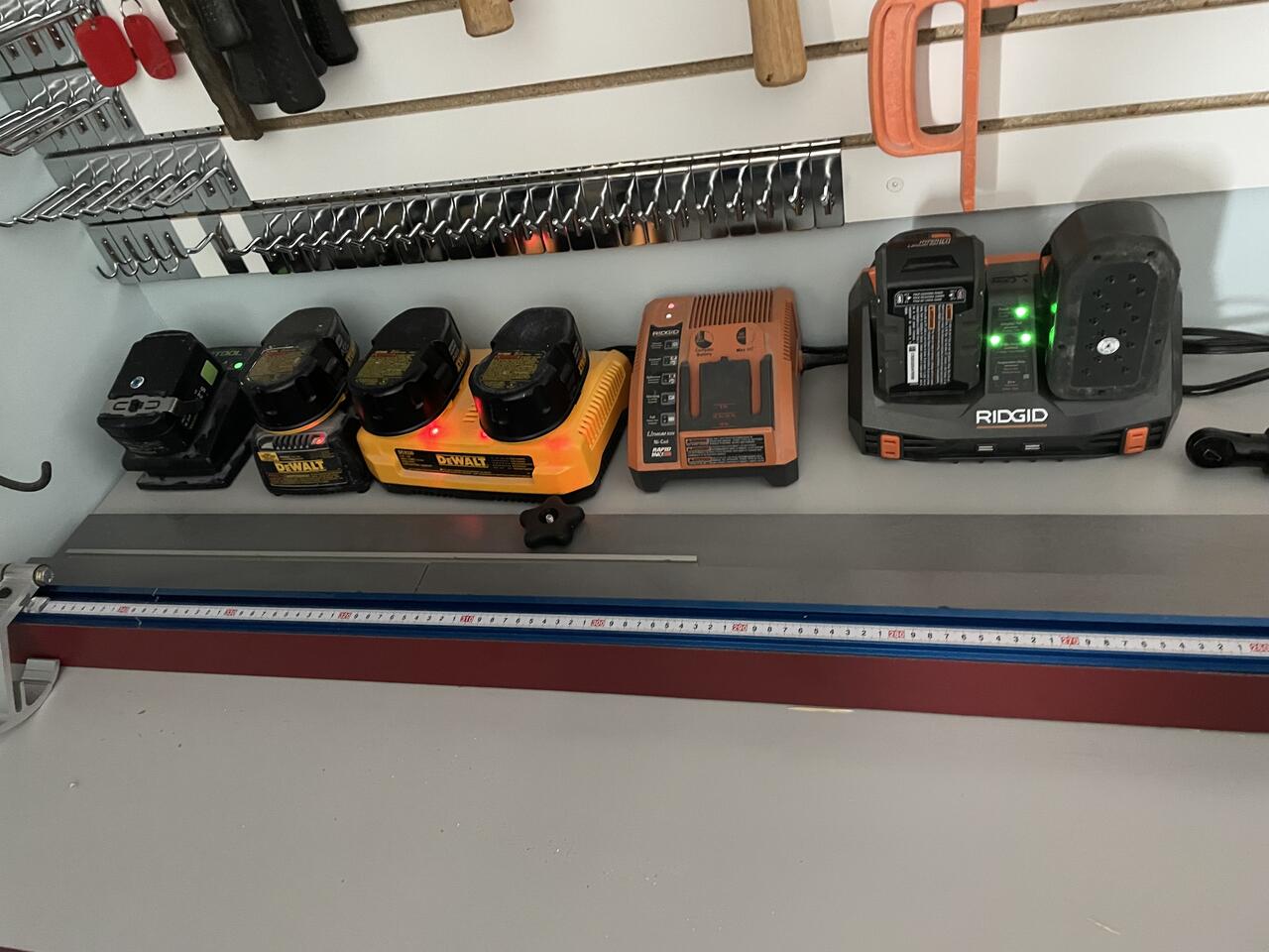

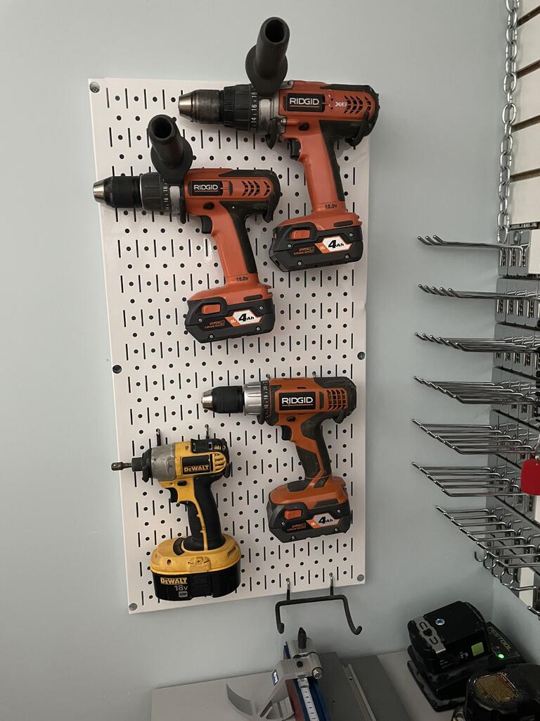

      Here is my completely lame solution that required no effort other than spending money. I've thought about building one of the charging stations shown in the OP, but time is not on my side and I have a solution for now.
      Steel pegboard from HD and some drill cradles from Diamond Life Gear and chargers sitting on the bench behind the miter saw fence.

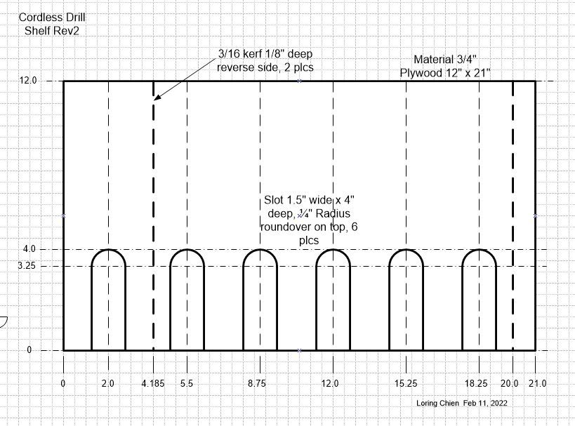

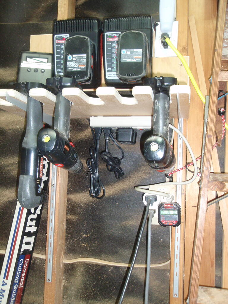

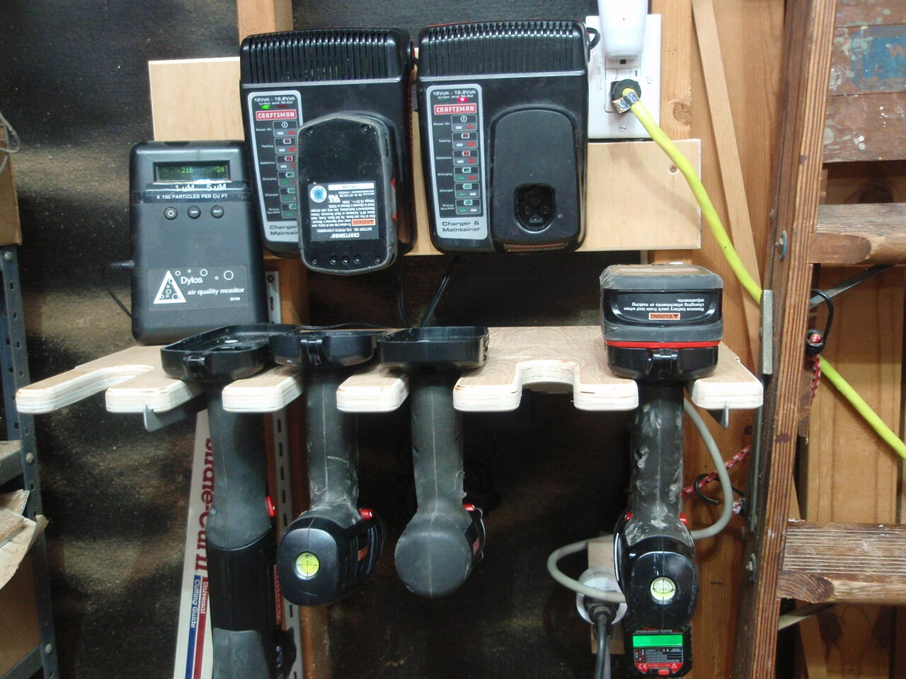

        OK, well I sorted out what I wanted in a drill holder.
        • Compact and space efficient.
        • Space for 5 or 6 tools
        • Fit in existing remaining space on the wall a little wider than a pair of studs on the unfinished wall
        • place for the chargers I have; 2 of them, and with the controls and indicators facing out where I could see them, not up at the ceiling where you can't see them
        • A little space for batteries and bits
        • a space for my air quality monitor
        • A power strip for the stuff
        • Not too complicated
        So all those ideas from the internet seemed really complex for what it was and the chargers all would sit on their bottoms and point up.
        So I got the idea, why not a shelf for hanging the tools, and a vertical board with the chargers mounted?
        This is what I came up with using commercially made adjustable shelf standards and a pair of 12" shelf brackets. and a few pieces of plywood. It took a fair amount of drilling, cutting, sanding and routing for those darn slots. I put two shallow kerf cuts in the bottom of the shelf so that they would sit over the shelf brackets and not slide or wobble. They should be 16" apart (stud distance) but I measured after installing the standards and the centers were as I marked on my drawing - about 3/16 off.
        Click image for larger version  Name:	cordless drill holder.JPG Views:	0 Size:	84.8 KB ID:	848386
        Click image for larger version  Name:	P2140856.JPG Views:	0 Size:	175.9 KB ID:	848385 Click image for larger version  Name:	P2140845.JPG Views:	0 Size:	152.7 KB ID:	848387
        Click image for larger version  Name:	P2140854.JPG Views:	0 Size:	153.5 KB ID:	848384 Click image for larger version  Name:	P2140853.JPG Views:	0 Size:	130.3 KB ID:	848383 :

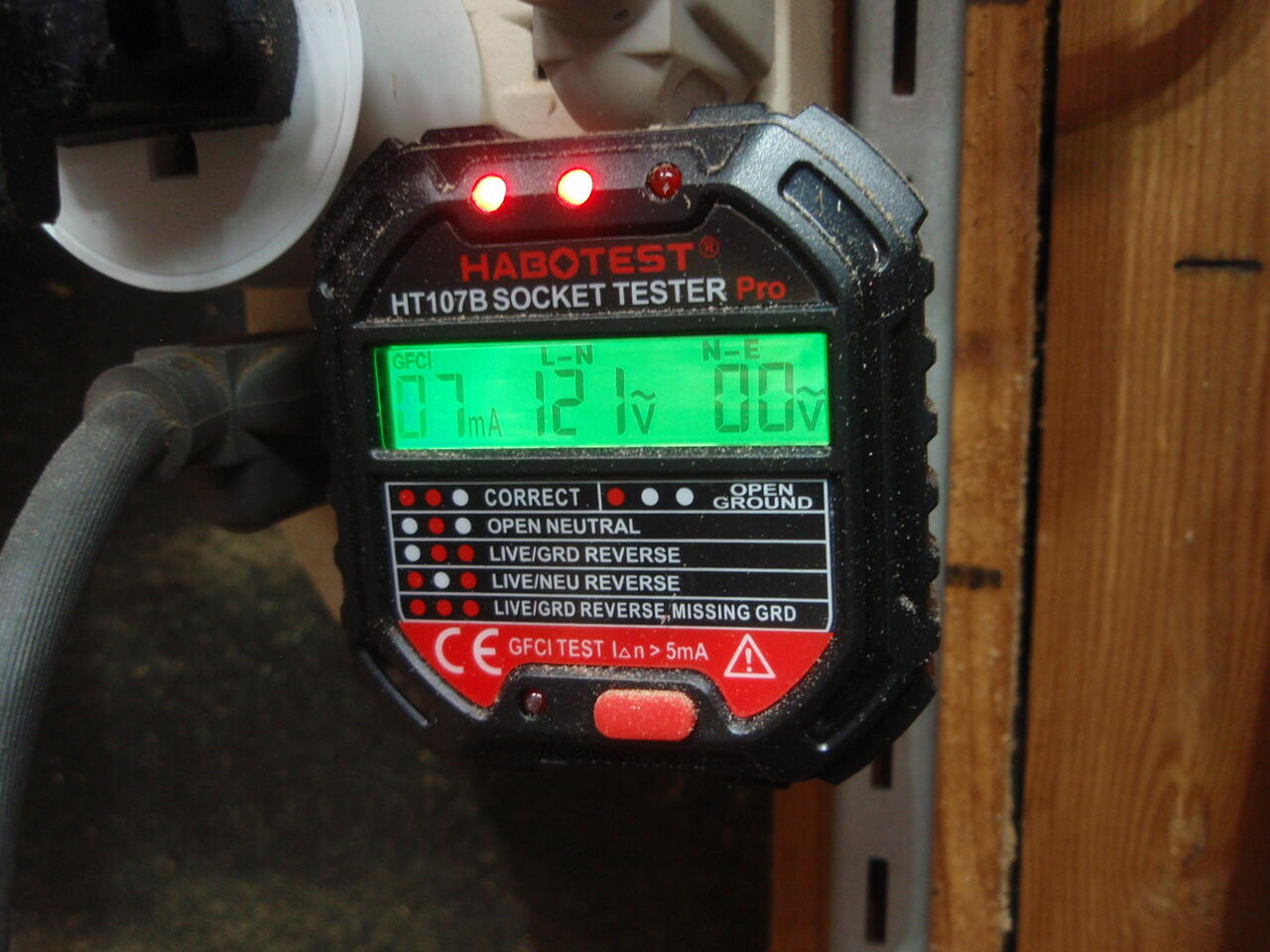

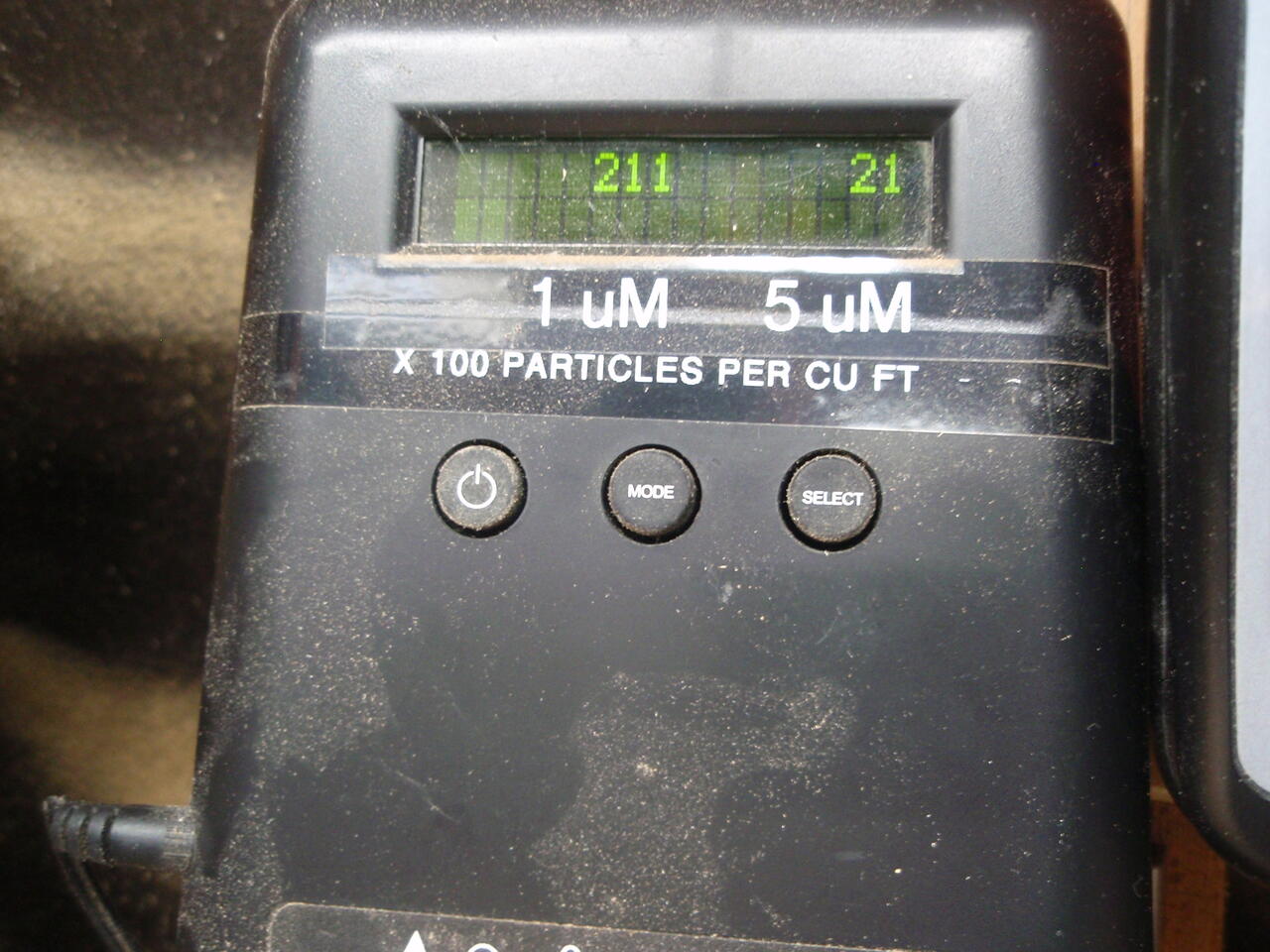

        Here's my Dylos air quality tester, and a line power monitor... I like to see the 120 V is stable. Its always between 121 and 123.
        The white thing in the upper right of the pictures plugged into the wall is a night Light/emergency lighting in case for some reason power is lost in the shop I can find my way out. It get very dark at night with the only lights being the overhead ones.
        Any questions?

          I turned on the air filter after these pictures, because I did some sanding and vacuuming just before. The 1 um particle count went from 200 to about 75-80 after an hour.

            The only thing I wanted to do that I could not do was to fasten the vertical board with the chargers to the shelf standards, making the board easily removable and height adjustable.
            I looked and I could not find or figure out an easy way to make a vertical board mount to the shelf standards slots with the hooks that the shelf brackets have.
            So its is just screwed to the studs. Had to cut out a corner to miss the outlet mounted there.
