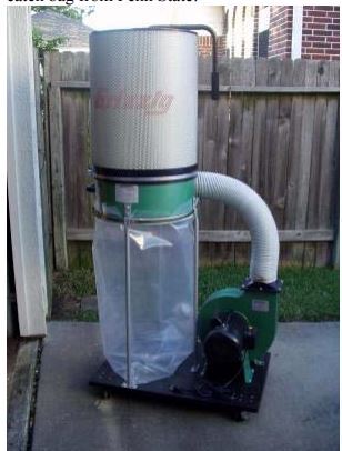

          • 22098
          My HF 2 HPDC upgrade is the grizzly canister filter on top plus a neutral vane and a catch bag discussed other places here.
          The Canister was $165 in 2006 and had a 20 inch ring size and fit the HF with no issues.
          Just glancing at the Grizzly website they have canisters available as replacements for their DCs.
          I think it was this one. Kinda expensive now but it wasn't cheap in 2006.
          https://www.grizzly.com/products/gri...-g0562-z/h5783
          My DC when it was new.
          Click image for larger version  Name:	griz canister on HF 2HPDC.JPG Views:	9 Size:	23.3 KB ID:	847398
          Yeah, its a quality 1 micron cut filter and fits the filter ring perfectly. Since it has 6 times the filter/flow area of a fabric bag due to pleats and special filtering material, you eliminate the 2-bag, 5 micron setup. Doing that allows using a catch bag only rather than a filter bag on the bottom with no loss in filtering as it fills up, and the single canister on top that filters better than 2 empty bags with a much finer cut and lower overall flow restriction. The beater bar is a good thing, it shakes the caked up fines off the pleats and drops them into the catch bag.

            What's the filtration rating on the Grizzly? I like that it has the internal beater....
            Never mind, I looked it up. 1 micron, spun bond polyester. Good material.
            You are right though, steep price on that. It looks like it is tailor fit for the HF 2HP DC though... I mean that looks like a facttory perfect fit.
            LCHIEN commented
