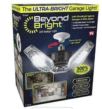

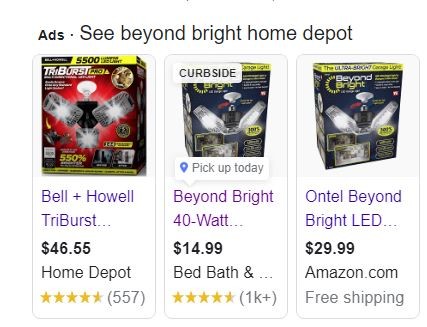

    I just bought 2 of those Beyond Bright also Bell and Howell.(are they all the same? who knows) three-wing screw base LEDs advertised on TV. My quick comments:
    the advertising claims to be 3500 lumen and 40 Watt equivalent. Incandescent 40 watt bulbs run about 700 lumens so its more like 200 W equivalent. I measured 43 W actual on one and 47 watts actual on the other.
    Bed Bath and Beyond has them for $14.99 and 20% off single item BB&B coupons are everywhere.
    Home Depot has then for $25
    and Amazon has them for $30.
    so go figure. And beware, Amazon reviews had a whole bunch of comments about DOAs and early failures. I guess they got satisfaction but still inconvenient.
    One is for my SIL and the other I'm going to put in the screw socket for my shop/garage that's separate from all the 4-ft LED-tubes.
