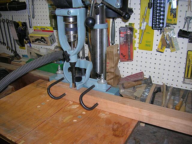

    Having a small shop and an even smaller tool budget, prompted me to use my drill press for cutting mortises. I purchased a Delta mortising jig and bits and soon discovered the amount of set up time and fiddling was really not to my liking. I made a dedicated mortise attachment for my drill press that bolts to the cast iron drill press table. The attachment has the mortise fence permanently attached, so set up is done much quicker.Click image for larger version

    I had big dreams of using a mortiser, and even bought one (Delta, I think). I never used it over a two year span of owning it, and sold it to Norm Havens of Japan. I think he used it some but it was quirky. The problem with mortisers, from what I have read on occasion, is related to what you said - It has to be precisely set up and mortising boards have to be tightly locked down. Nothing like the idea of putting a board against a rip fence and just holding it tight as you push.
    It kinda reminds me of a common problem with new (and sometimes old) pen turners. IF both ends of the pen blanks are not 100% perfectly square, alignment and concentric problems abound. It is difficult to convince some that 1/2 of a degree can cause such problems.
    LOCKING down tightly for mortises is a necessity - from what I have read.
    • Black walnut
      • Aug 2015
      • 5515
      I have used my attachment successfully with pine. The smaller chisel and bit with red oak and maple. It was slow and set-up was a chore. I really like your jig Jim. Are you using it with a floor drill press?

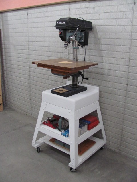

      • Jim Frye
        • 1364
        • Maumee, OH, USA.
        • Ryobi BT3000 & BT3100
        Nope, I only have my old benchtop Delta 10" DP.
        Jim Frye
        The Nut in the Cellar.
          Ha, Ha, I like it that your mortising attachments match the color scheme of the Drill press used. Delta blue, I guess.
          • Jim Frye
            • 1364
            • Maumee, OH, USA.
            They should match. The mortising gear is by Delta, even the bits and chisels. I bought the stuff at the same tool store that I purchased the DP. Notice the bit boxes on the lower shelf of the mobile base. Delta. By the way, the mobile DP stand is the one from my unused BT3100 saw with some additional bits.
