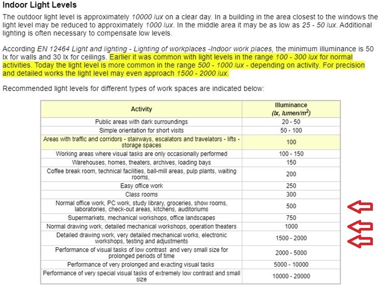

          I have 3 of the grey sewing machine lights on my band saw. They add enough light to the existing overhead shop light to eliminate shadows at the blade. A very nice addition to equipment that needs point of use light.

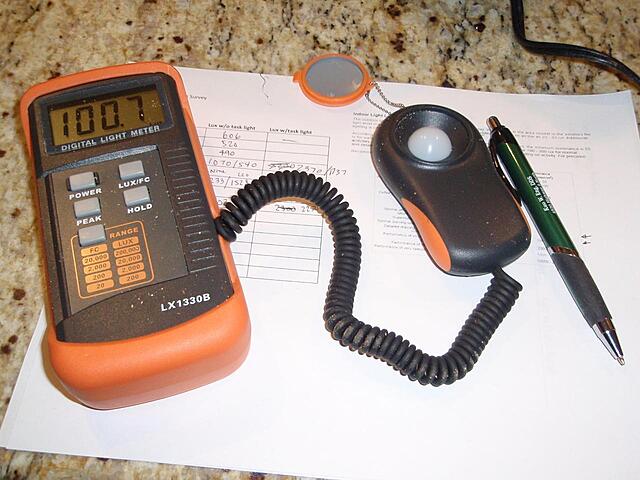

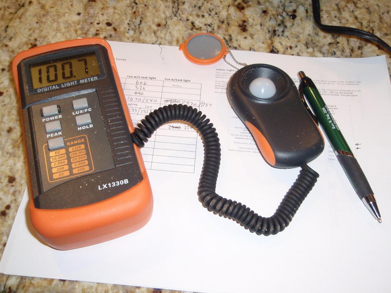

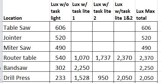

            I have an inexpensive digital light meter that measures light falling on a point in LUX, the unit of light illuminance.
            I decided to do a light survey of my tool work surfaces. Some of them have two task lights, the second one is the gooseneck LEDs described earlier in this thread.
            I think I have sufficient light on my most intense handheld working areas - drill press, bandsaw and router table.
            The lesser light areas, are mostly fence-guided tools and I am satisfied having the light I do (around 500 lux for the table saw and jointer)..
            By way of comparison the light on my kitchen worksurfaces is about 150 lux.
Name:	jpeg image of shop survey table.JPG

            My light meter, from eBay a few years back.
            Click image for larger version  Name:	P1040011.JPG Views:	0 Size:	134.2 KB ID:	841928
