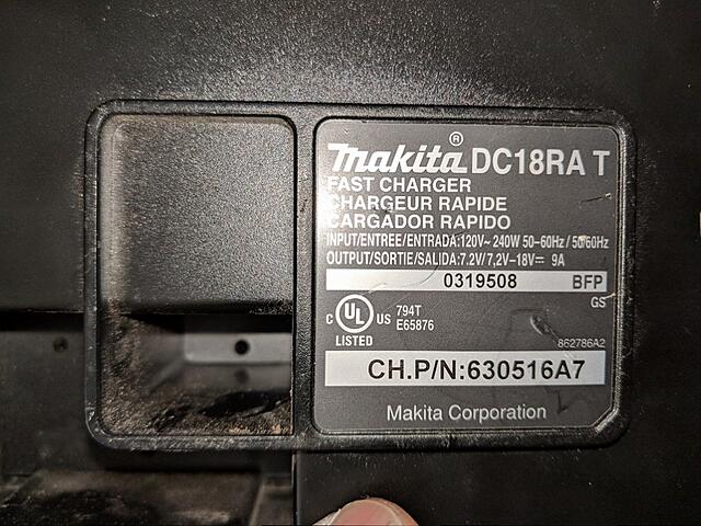

    So we have moved overseas. We just arrived last night and I've already managed to blow up my Makita battery charger. The plug is a polarized one but the adapters I bought allow the plug to go in in either orientation--wide prong on the left or right. I tried to align it the way I thought made the most sense, but I heard a pop in the charger. There is scorching near the power cable on the inside but nothing else. It doesn't turn on anymore. The Makita is supposed to be able to handle all voltages and frequencies. I even lugged the batteries in my carry on.

        ...I've already managed to blow up my Makita battery charger. The plug is a polarized one but the adapters I bought allow the plug to go in in either orientation--wide prong on the left or right. I tried to align it the way I thought made the most sense, but I heard a pop in the charger. There is scorching near the power cable on the inside but nothing else. It doesn't turn on anymore. The Makita is supposed to be able to handle all voltages and frequencies.
        I doubt incorrect AC mains polarity would result in damage. In the United States, the 120VAC mains outlets are polarized for safety (to avoid shock hazards). The electrical codes allow manufacturers to "assume" proper polarity in their electrical design. In most other countries, polarity is not assured by electrical code - and this is likely why your adapter doesn't provide a polarized connection.
        From the symptoms, it sounds like the charger was connected to a mains voltage that was too high (i.e. 220V instead of 120V). Are you certain that the charger has a "universal" input? I just checked the Makita Model # DC18RC charger specification for an example and it is only rated for "A.C.120V 50–60HZ". If it comes with a permanently attached power cord with the standard "NEMA 5-15" type plug, instead of a removable power cord with the "IEC C13/C14" plug/receptacle combination, then I would doubt that it has a "universal" voltage input rating (90VAC - 264VAC).
        It is possible (not necessarily probable) that there was a surge suppressor on the input that clamped to stop the over voltage, resulting a blown input fuse. Replacing the fuse and suppressor may "fix" the problem. (This will likely require soldering). It may not because there is so much energy available from the AC mains that the fuse may have blown after the downstream electronics were destroyed. (In other words, the fuse prevented a fire, but didn't prevent damage).
          I second Slik Geeks assessment. Are you sure the charger was universal input?
          Sounds like an overvoltage application failure.
            Looks like it was supposed to be universal input to me. Maybe it was mislabeled.
                [/ATTACH]
                Thanks for the photo, that was very helpful. Upon my first glance at the label I thought it said the same thing that you thought. But a second close look made me realize that the label is a bit confusing (more on that later).
                if you study the label carefully, you'll find that the label states the following (leaving out other languages):
                Input:120V~ 240W 50-60Hz It ISN"T specifying 120V - 240V.
                Here is what it is specifying:
                120V (USA standard mains line voltage)
                ~ (AC, alternating current)
                240W (240 watts power consumption)
                50-60 Hz (50 to 60 cycles per second)
                The labels on appliances should always specify the nominal operating voltage, voltage type (alternating), maximum power consumption or current, and acceptable frequency if it is alternating current. This label does that.
                The US standard line voltage at your NEMA 5-15 receptacle is 120V 60Hz.
                Sadly, this photo confirms my suspicion: The charger is only rated for 120V, not 220V. Bummer.
                The 240W specification can be confusing because it is similar to the nominal voltage of 220V or 240V. The label could have been better designed.
                  atgcpaul commented
                  Thank you! Mystery solved. And yes, a real bummer. Luckily I can still buy from Amazon here so another $30 for a new charger that will then plug into a transformer.

                  It says Input: 120V~240W 50-60 Hz
                  Click image for larger version  Name:	Capture.PNG Views:	1 Size:	12.6 KB ID:	832644
                  That means 120V at 240 Watts power.
                  It looks like it at quick glance BUT IT DOES NOT SAY 120-240V
                  Yes, I can see how that might happen.
                  Its unfortunate that the watts came out to be the exact value that could be mistaken for High mains voltage.
                  I would like to think that if I was creating that label that I might have realized the possibility of confusion and been more specific but technically the label is 100% correct.
