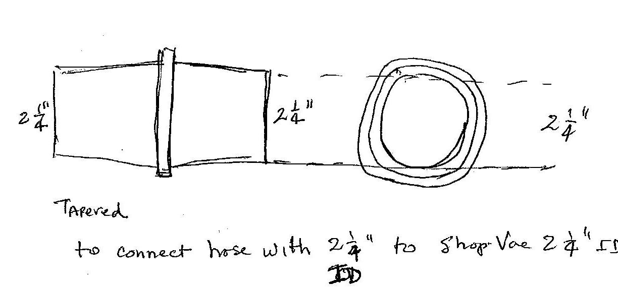

    I am Looking for dust fitting adapter with 2-1/4" OD on each end. Preferably slightly tapered.
    I need to attach a hose with 2/14" ID end to the inlet of a Shop vac which has a 2-1/4" ID and accepts a 2-1/4" Hose.

        There is a sketch! Did you just add it? It wasn't showing up at all on my iPad yesterday.
            Yeah, I added it a couple of hours later... had it but got distracted on the way to the scanner computer. Hehe.

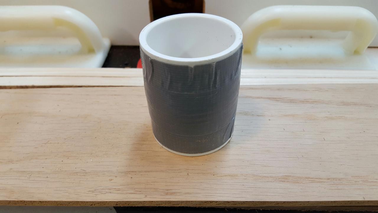

                I went by the hardware store and found that 1.5" PVC pipe uses couplings that have a 2.22" outer diameter.
                The hose inlets on the vac and hose end were very close to 2.29"
                So I wrapped about 3 layers of 3/4" masking tape around the middle of the coupling to build it up by 16-32 mils... ( 4 mils thick and 4 layers on each side) Thicker in the middle, outer part with none, to make a taper.
                Then I used some 2" wide duct tape which was about 6 mils thick. I left about .2" at the ends bare and worked to the middle where it overlapped about 3 layers.

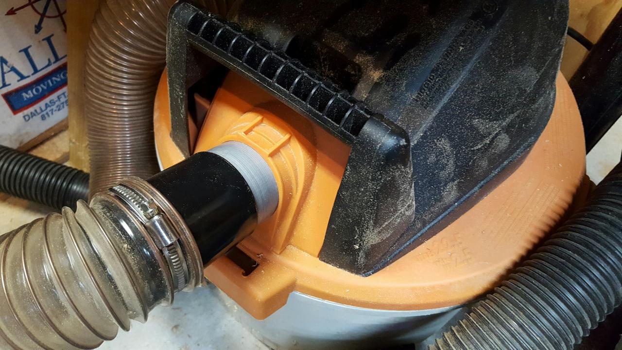

                When done I had 2.23" OD near the ends and 2.31" diameter (OD) near the middle. .Glad to say it worked like a champ, the taper was perfect, and total out of pocket cost was $1.29 plus tax.
                Click image for larger version  Name:	20161024_150932_resized.jpg Views:	1 Size:	75.6 KB ID:	827921
