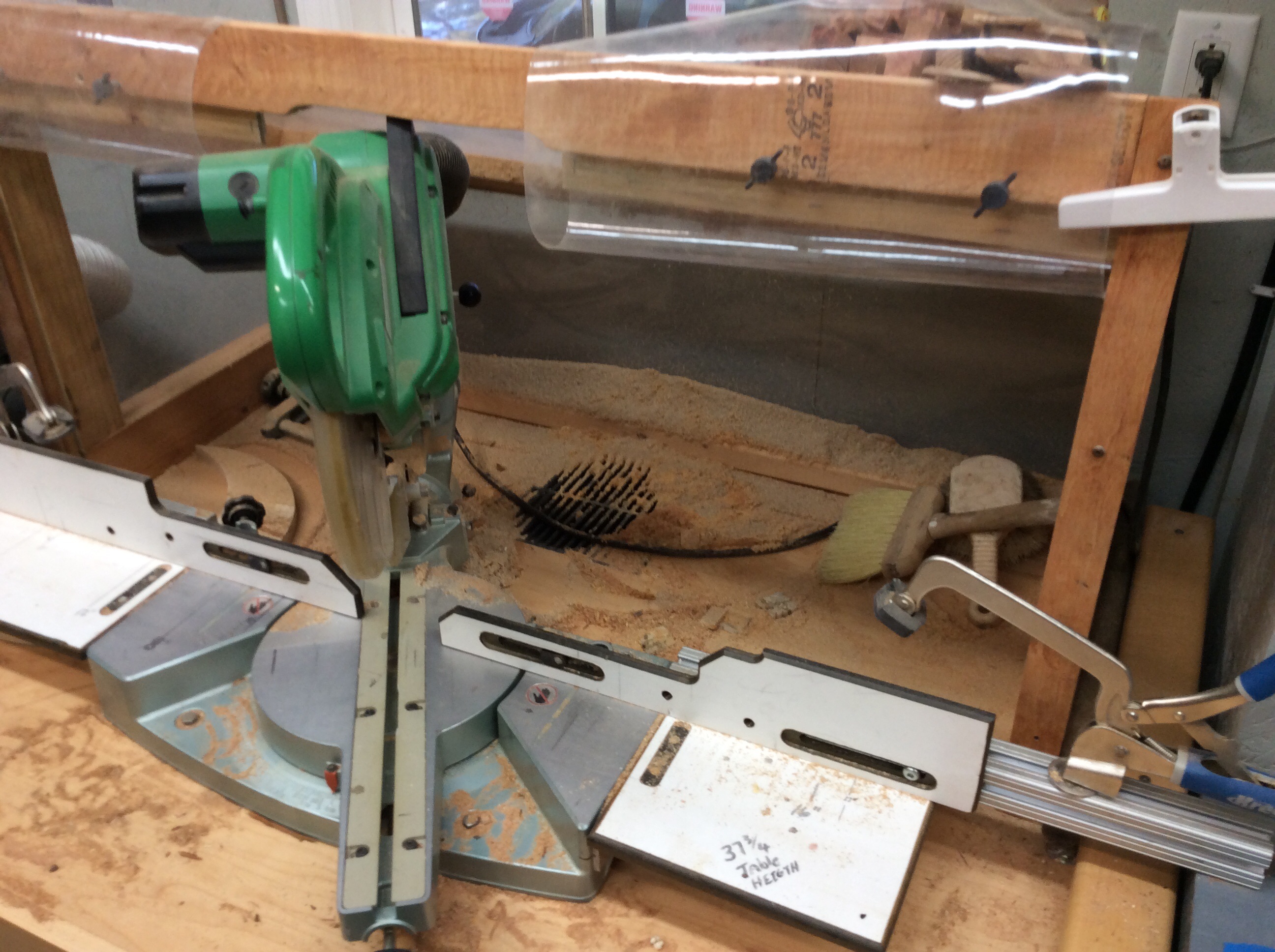

          Don't think you are going to like that, unless that Bosch handles saw dust better than I think. Photo of my Hitachi in its enclosure. It has clear curtains in the front that also helps keeps dust in, but you can see what is in front of the saw. Before the enclosure this mess was all over the shop.

            Does your Hitachi setup actually have a DC hose attached to the saw or are you relying on just that grill area behind the saw?
            The Bosch does have a pretty efficient direct hookup. the little I have used it so far in building the bench showed it to work pretty well. I now have a variety of things to build so will know more in a week or two.

              The Hitachi does have the 2 1/2" vac hose hooked to its connection that collects dust from behind the blade and the guard area. The hood enclosure has a 4" straight from the dust collector with a 2 1/2" "y". While it does not have the suction that the vacuum cleaner provided it has a lot more cfm with the dust collector and keeps a lot out of the room.

                The dust hood I built for my HF slider keeps the dust IN the hood, but pickup at the dust port is less than spectacular... I mean it helps, a LOT but miter saws spew an obnoxious amount of sawdust very quickly...

                  The photo of my Hitachi hood is after cutting a lot of wood. No telling how much sawdust was pulled into the collector. Very little gets thrown out and what does usually stays on the table, little reaches the floor. Before I built the hood the window and wall behind the saw looked like a piece of Osb, and that was with the vacuum cleaner hooked up to the saw.

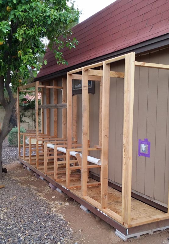

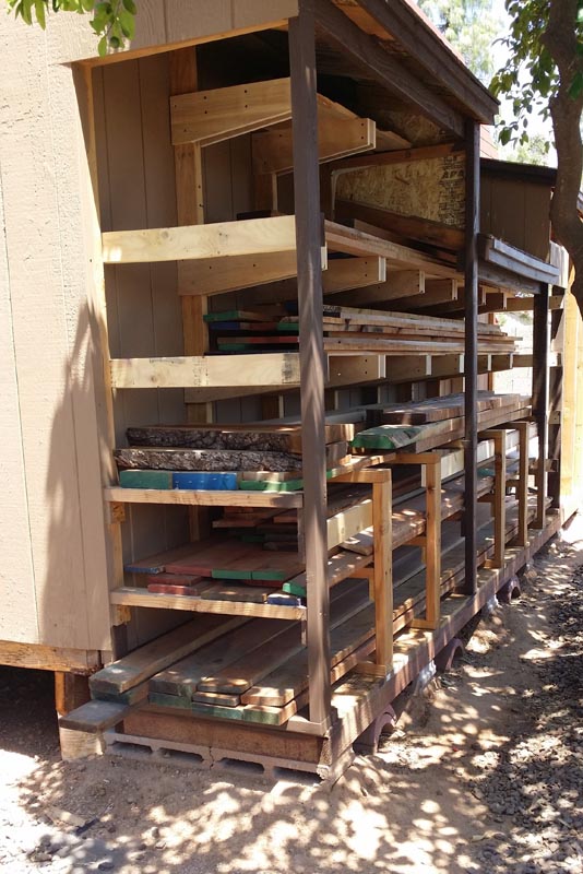

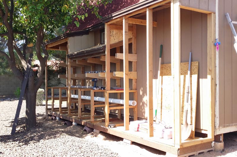

                        Lumber Storage - DONE!
                        This weekend much to the happiness of LOML the pile of lumber that has been sitting under a tarp in the backyard made its way into the new lumber storage attached to my shop. I still have to finish the roof but that's pretty quick and should be all done next weekend. The front part of this attached structure will house my DC and thats really the last part needing attention. The DC portion will have solid siding and doors while the lumber area will be covered in tarps attached with bungees and industrial Velcro. This will provide more than enough protection and allow for easy access.
