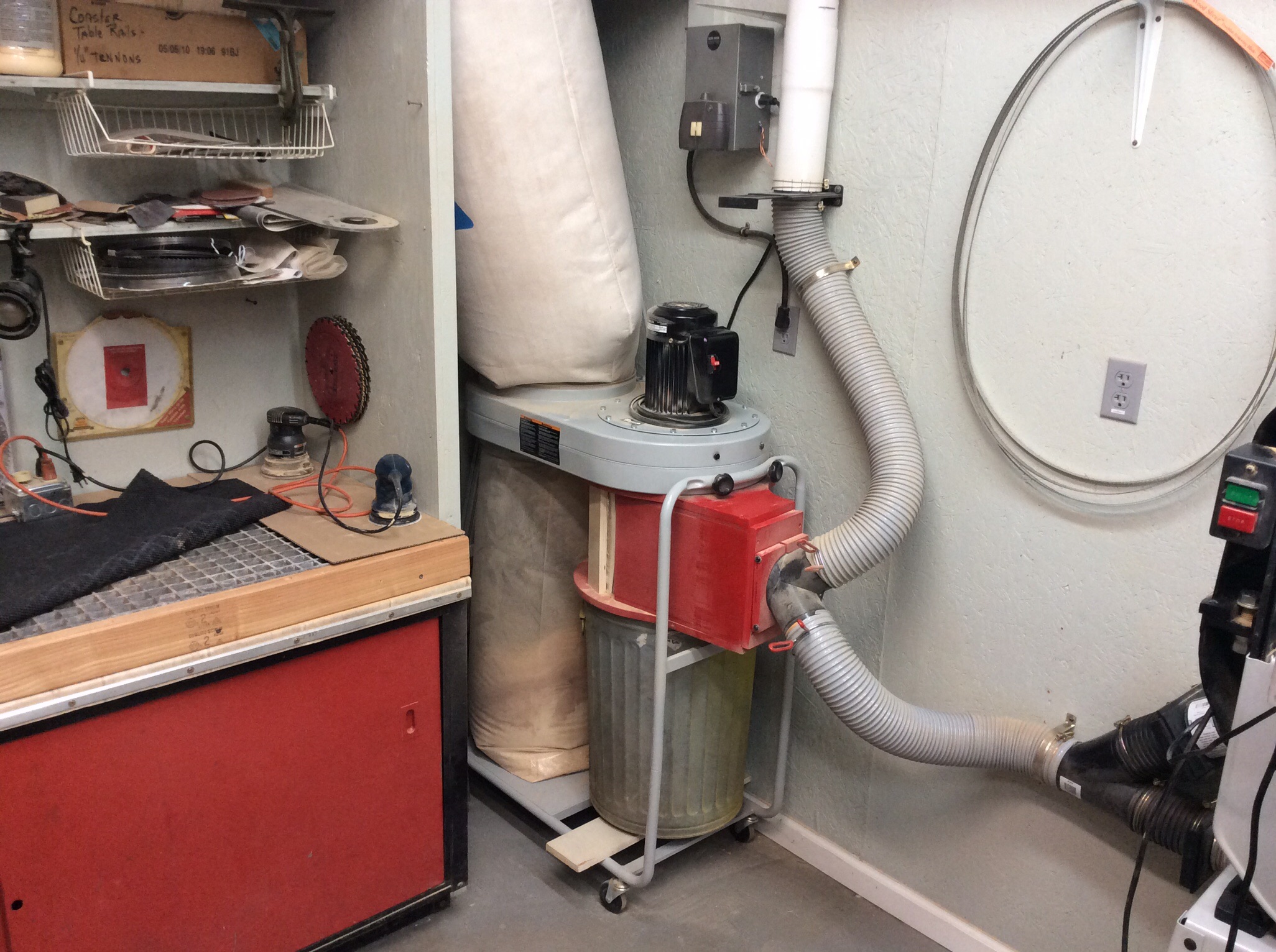

              Attached is photo of my Delta 50-760 with the Thein separator installed. I after making several smaller Theins for shop vacs for others I decided to build a taller one for my collector. It has clear acrylic sides so I could watch it work, but I forgot that the viewing area would be against the wall, so the wall can see it well! It is amazing how the sawdust just scoots down into the can. Note that the garbage can is about 1/2" off the base. After fiddling around half a day trying to design a way of fastening the can to the separator I discovered that it would suck the can up and hold it without any fasteners! Now I know when the can is nearing full because it will not pick up with a loud clunk.

                Its interesting to see how much dust/chips have still made it through to the bag. With your Thein approx how much goes in the trashcan vs the bag?

                  On my Delta / Thein I have not seen any (0) chips get past the Thein. The plastic bag in the photo contains only powder dust. I was surprised, and can't see how a cyclone could do any better unless it restricts less. The size is also a selling feature as I did not have to jack up the frame for a cyclone to fit, all is within the original Delta framework.

                    Thein separator performance? In 5 months of lots of use for me I have emptied the chip can 7-8 times and not emptied the dust bag any. The dust bag appears to have 10 gallons of pure dust. I occasonaly beat on the dust bag just to see what falls out into the plastic bag, quite a bit does fall out. I've actually filled up a 4'x4'x2' compost bin with wood chips.

                          Regarding Thien separator performance - about 1 inch of fine powder makes it past the separator into the bottom bag for every 2 trashcans worth of chips/dust. I'm using this remodel of the HF 2HP DC. Since this photo, I've replaced the stock filter bag and lower plastic bag with two 1 micron bags, and its working well.

                            If I read this right, the Thein separator really isn't doing a good job for you because most of the dust should be staying in your can and not getting to the filter/bag side, right?
                            I have the stock HF DC with the Wynn filter and the Thein baffle installed in the ring that separates the filter from the bag/can below. It's hard to say if the Thein baffle is keeping the dust out of the filter as much as I would like.

                              The dust that gets by my Thein is face powder fine dust that is coming off my drum sander and sanding at the downdraft table. When this dust gets airborne it looks like fog in the air, some of it is actually going through the 1 micron bag. I am satisfied with the chip collection and saw dust with the Thein, and do not expect that a cyclone would catch these chips and saw dust any better. I believe that a Thein separator or a cyclone would have the same poor performance catching airborne dust.
                              This set up with the Thein before the fan keeps the fan clean. I cut a lot of antique heart pine and before installing the Thein separator and the pine dust and chips created a mess in the fan chamber and on the blades.
                              To improve this dust collection would require more fan capacity/horsepower and larger piping.

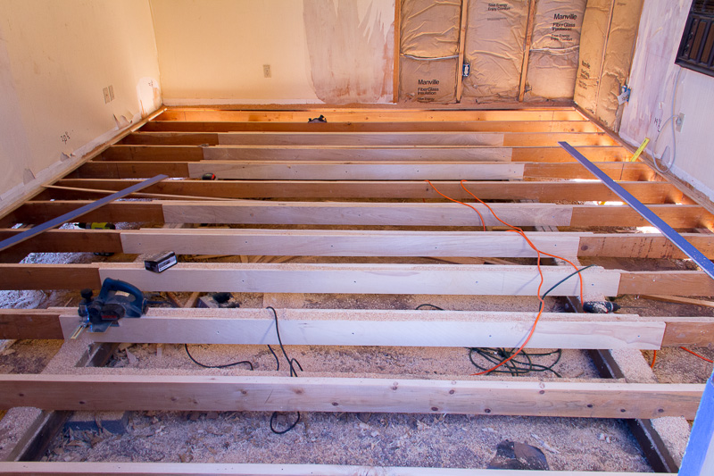

                                Spent much of this Thanksgiving weekend cutting and planing out the bows in the flooring joists. In some the bow was so extreme I had to remove 1.75" in the middle of the 2x6. I ended up strengthening them all by laminating a pair of 3/4 ply pieces to each side.
                                The floor itself went back in around 5pm this afternoon although its not yet fixed down as I need to run power and possibly the DC piping underneath. I am essentially back to where I started except now the building and floor is both square and flat (give or take and 1/16-1/8 here or there).
                                I can wholeheartedly say that I (and my back) gives great thanks that this part is now over.
