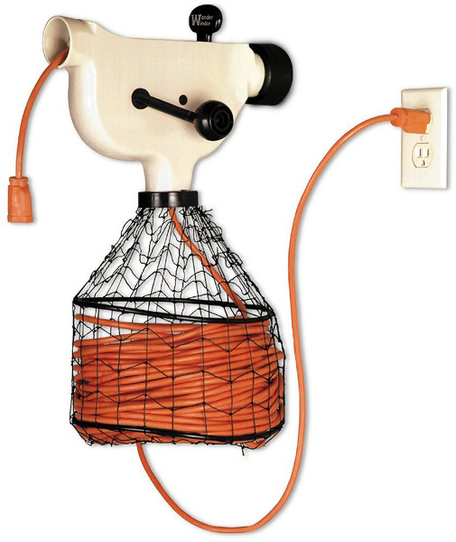

                I have 2 of the "Wonder Winders" which sort of spool the cable up into a mesh basket. The big issue I have is the wheel that turns and rolls the cable in slips, a LOT... Sometimes it works flawlessly, but most of the time it slips. The problem is the rubber compound used was too hard / slick. I am just getting fed up with the crap shoot that is getting the cord back into the basket...
                Lacking a reasonable self retracting solution, can anyone recommend how to make the Wonder Winder wheel grab the cord right?
                        Two thoughts come to mind.
                        Belt dressing for auto fan belts.
                        Lightly sanding the rollers
                        and a third, the cleaner used on copy machine rollers and rubber like pick up fingers that clean and soften the surface.
                        And a clean cord might help too.

                              and maybe a cord that's not 15 years old....
                              Actually both cords are 3 years old
