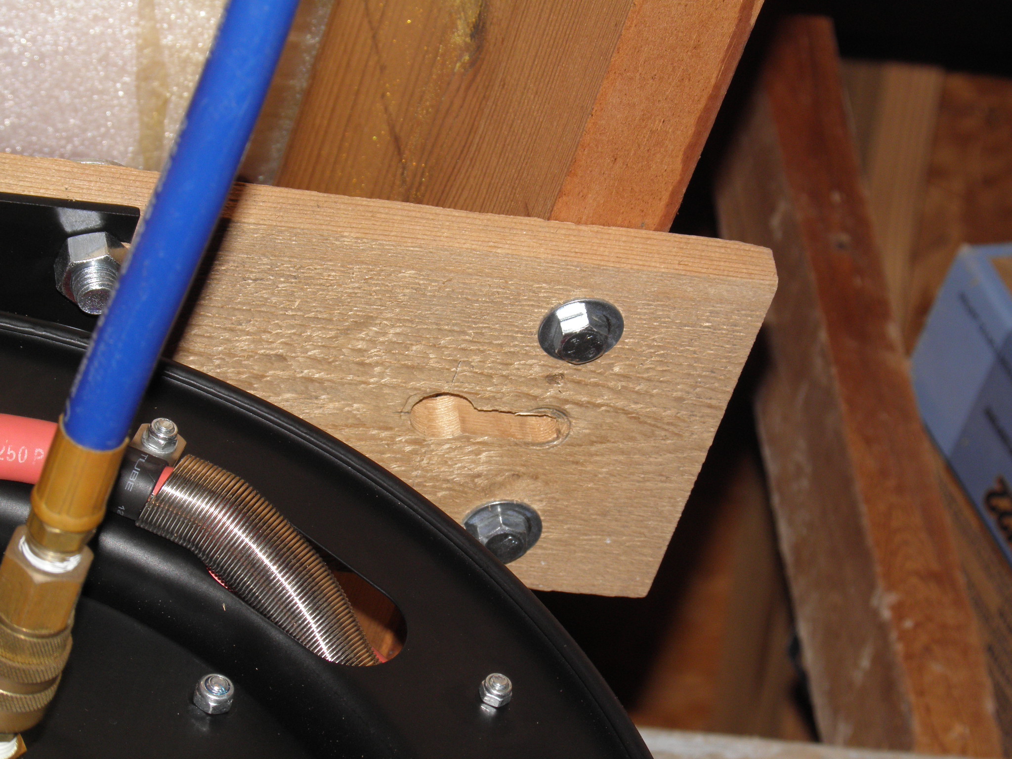

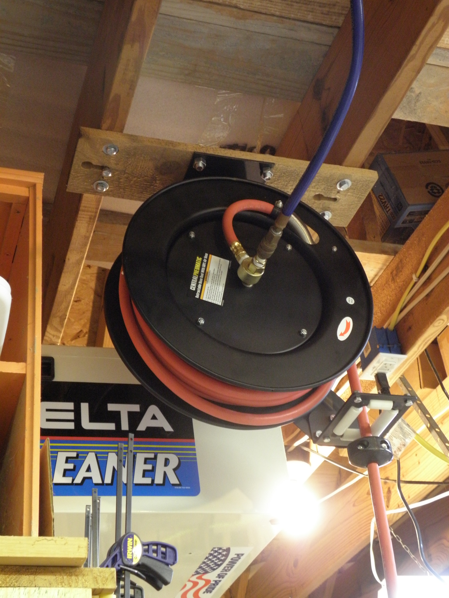

    I wondered about it for several days on how to hang it up on my garage overhead joists... I pretty much have to do it myself as my wife can't lift much of anything and working on projects usually leads to me yelling and then we all get upset.
    I could see myself getting it to the top of a six foot ladder. But I couldn't see how I could hold it up with one hand (shakey at 30 pounds weight) while lining it up with perhaps predrilled holes and driving in the required 1/2 bolts with the other hand...
    The idea I came up with:
    take a board that would span the joists (16" centers.) Drill a series of three holes (six total) over each joist location. Put a keyhole slot at the center two locations at each end large enough to pass the 3/8" lag bolt head (see picture).
    The I drilled the four holes for the 1/2" bolts that would mount the reel to mounting board.
    Put a couple of temporary nails into the board in line with the rows of holes.
    Climbed up the ladder with the board. nailed one end to one joist, used a square to square it up and nailed the other end. Used a transfer punch in each of the six holes to mark the joists for pilot holes for the lag bolts. In the keyholes I put the punch in the end of the small slot.
    Took down the board, tossed the temporary nails. Drilled six pilot holes in the marked locations. Put two lag screws into the center holes on each joist and screwed to a little more than a boards width away from seating the head.
    Put air fittings on the reel. Mounted the hose reel to the board.
    climbed the ladder with the board and reel using both hands, I positioned the first keyhole over one bolt head, then swung the other end so that the second lag screw fell into the second keyhole. Then I pushed the board and reel forwards so that the board was resting with the lag bolts in the narrow end of the keyhole slot resting the weight on the lag screw heads and all the holes in the board lining up with the predrilled pilot holes.
    Now I put the other four lag screws in with full flat washers. and took out the original two lag screws. - that's what you see in the pictures. hooked up the air supply and checked the reel again. But the lag bolts are now held by the non slotted holes so it won't slide off. For the picture I still have to place washers and lag bolts into the ends of the slotted holes so I have six 3/8" lag bolts holding the weight as well as four 1/2" bolts.
    So I was able to lift the assembly into place, position it and have it held in place without assistance while I placed the permanent lag bolts into place. I was quite pleased with myself.
    And by the way, the hose reel works very nicely. pull down the hose. It has ratcheting stops so it can be stopped every few feet with no back force trying to pull it back. I can brad nail or clean up with compressed air much more quickly now rather than wrestling a coiled hose into position. After I'm done give it a little tug and the hose retracts smoothly and neatly back onto the reel.

    It does look like a quality hose reel. Good design for the 1 man mounting system. Working alone in the shop the craftsman has to be creative with a lot of his handling heavy and cumbersome items.
    My shop has fully enclosed reels where you can not see how much hose is remaining and will allow you to pull hose until it stops and jams the ratched dogs. (it looks like I would mark the hose so this would not happen) That gives you the opportunity to practice your ladder standing skills while you take the covers off the reel and try to trick it into releasing. I now like the open reel design like yours much better!
    I have found that there is enough air pressure/volume restriction in the swivel and air chuck quick disconnect on my hose reels that my 1/2 impact wrench does not have enough umph to break some bolts loose. To work around this I have put a "t" and valve in the air line after the compressor tank just for a dedicated hose for the impacts and other high pressure/volume applications.

                Just a thought for future installations: a lot of those 30 lbs are the air hose. Why not pull out (unreel) as much hose as you can, and let it sit on the garage floor, or better yet, on a ladder shelf. That way, the only weight you're lifting is the reel, plus the length of hose between the ceiling and floor (or ladder).
                            that might have helped. One problem would be that unless the reel is mounted, its resting on the reel itself and its not that easy to unreel it.
