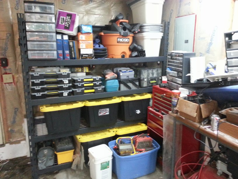

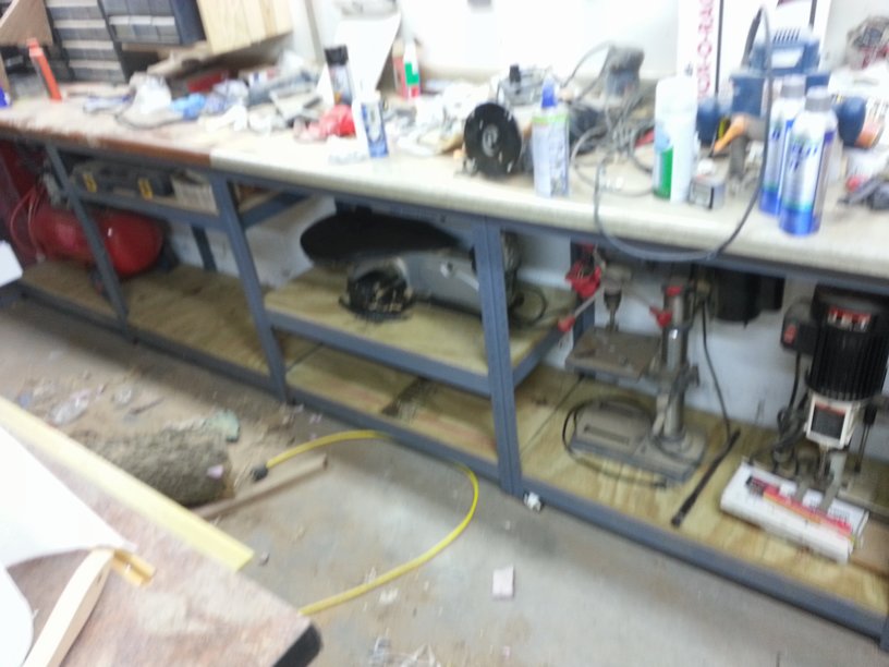

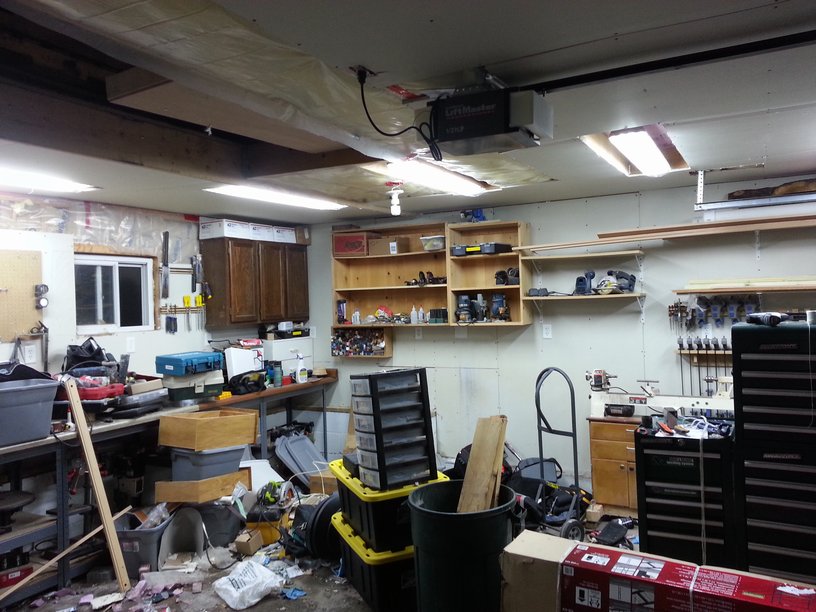

    So, it's been a Loooong and slooooow road, but I feel like I'm finally getting to the final point of getting my old shop moved to my new shop, and getting things organized. There's still a lot to do, and I need to move my RAS, Belt/disc sander, BS, and jointer to the garage/ new shop, but that's just a matter of getting things moved.
    Anyway, here's some pics of the shop organization "in progress". You can see it going from a mess in March 2013, to kinda organized, to a mess again when I brought my mobile bench from my old shop (which was NOT easy to get moved, holy cow).

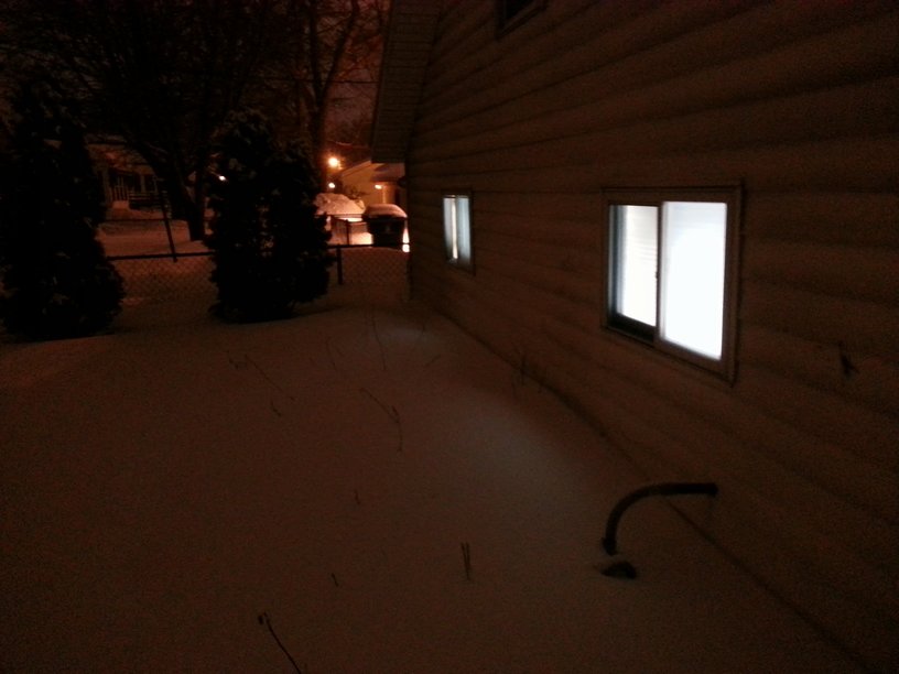

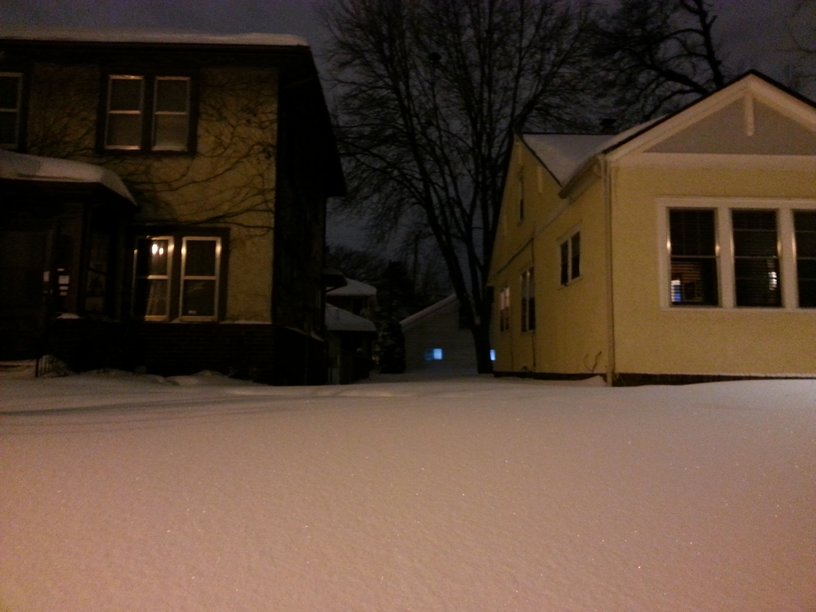

    Windows
    I had posted a poll on this before. I have two windows in the back of the garage/ shop that can be seen from the sidewalk in front of my house. I used frosted paint for the windows to make sure no one can see in, but I still had a huge issue with the massive amount of light at night.
    So I finally bought blackout mini blinds from HD last night. They don't block 100% of the light, but it's still a vast improvement. I'm not sure if it's worth making more efforts to block the light, but for now I'm much happier.

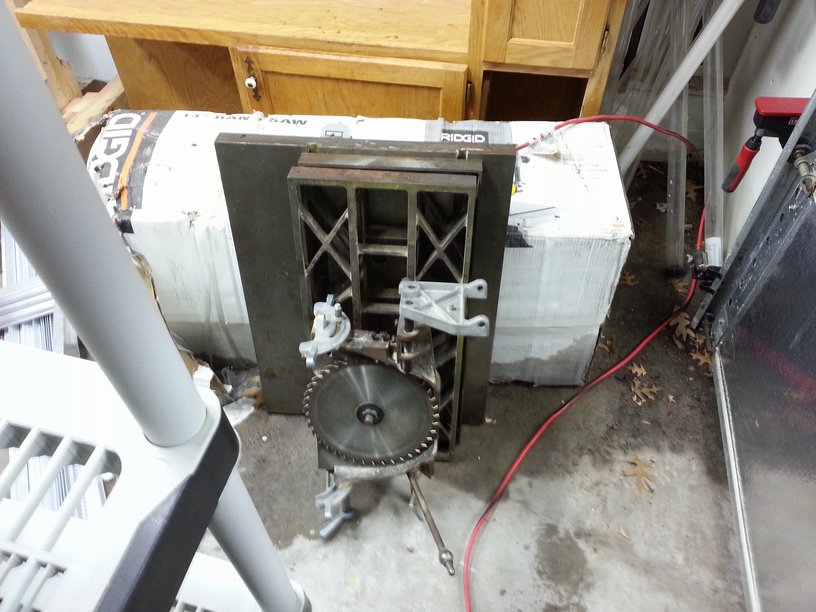

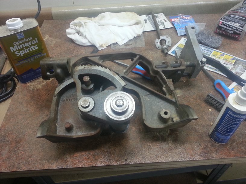

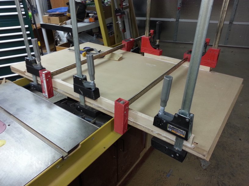

      Table saw recon
      I haven't had my workbench until recently, but I've had my mobile TS station in my shop since March of last year. I took it apart to move it, and used that opportunity to totally recondition it. Everything that was able to be taken apart was done so. I treated everything with evaporust, scrubbed with brass brushes, and re-lubed up with dry lube all over.
      Overall, I was happy with the result.

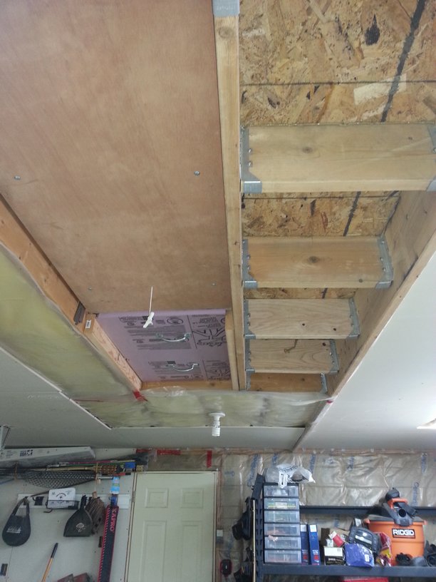

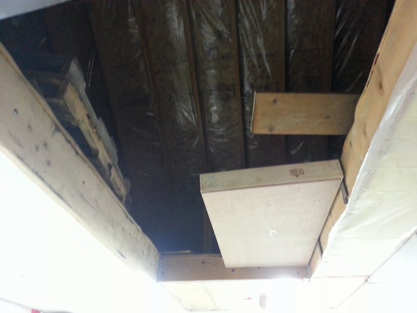

        Opening to attic area
        When I first started to modify the garage, I created an opening in the rafters so I would be able to get up into the attic area of the garage more easily, as well as have the ability to store wood and other items up there. The initial opening I created was much larger, but I realized that I'm not bringing sheets up there flat, and a much smaller opening would be OK. So, I bought a heavy-duty set of spring loaded attic steps (375 lbs capacity- bust I could find), and used that to determine how wide the opening would be. Then I framed up the rest of the opening. I still needed something longer than the space the steps would allow, but in the winter that extra gap means there's no heat retention at all. So just this weekend, I finally completed closing it up and creating a removable panel.
        I think the pictures show what I'm saying much better.

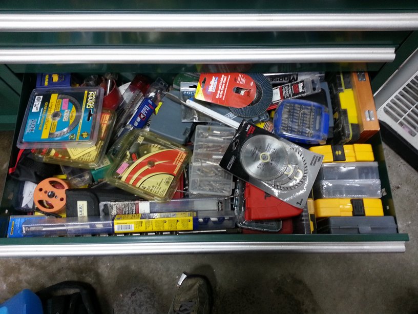

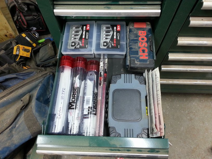

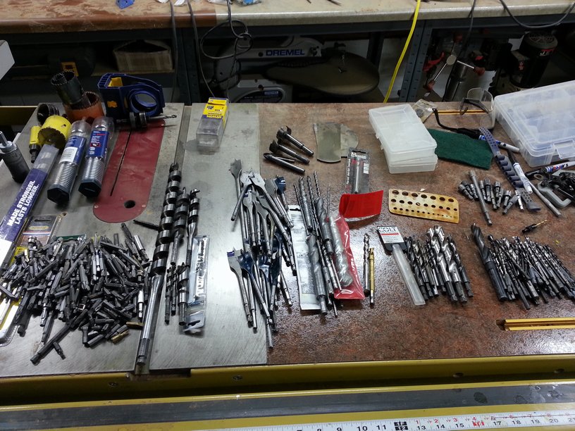

          Bit/ Tool Organization
          Here are some shots of my organizing my various drill bits and driver bits. I have way to many of both! A lot were a rusty mess- so they were treated to a long soak in evaporust, and a coat of dry lube to help prevent them from rusting. All of the drawers in my mobile tool chest are littered with desiccant packs to also aid in preventing more rust.
          Clearly I don't need to buy new driver or drill bit sets ever again. All of the cases in the organized drawers are full sets, with additional loose bits being organized.

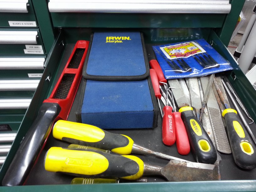

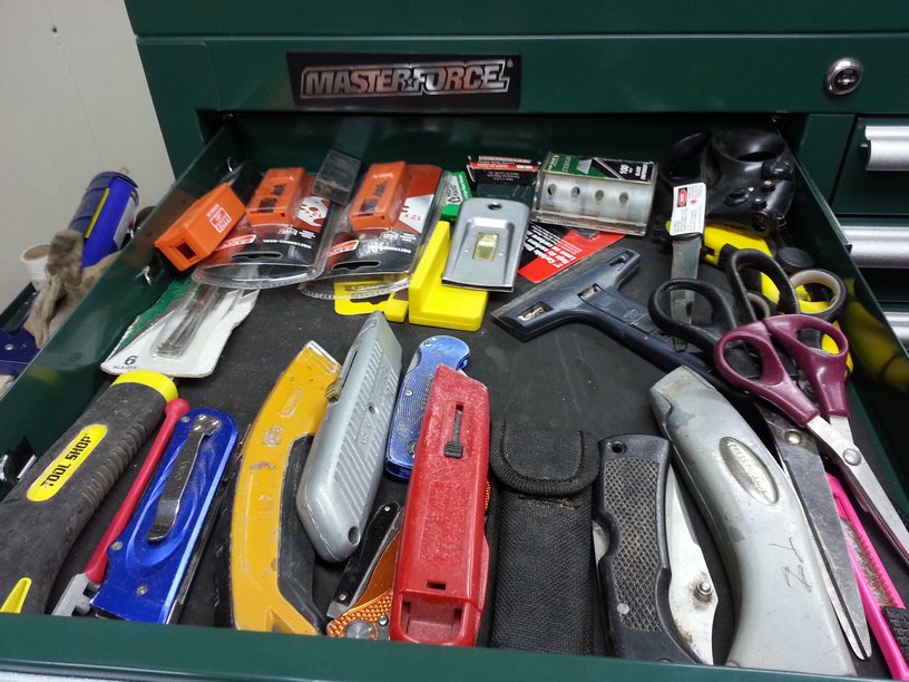

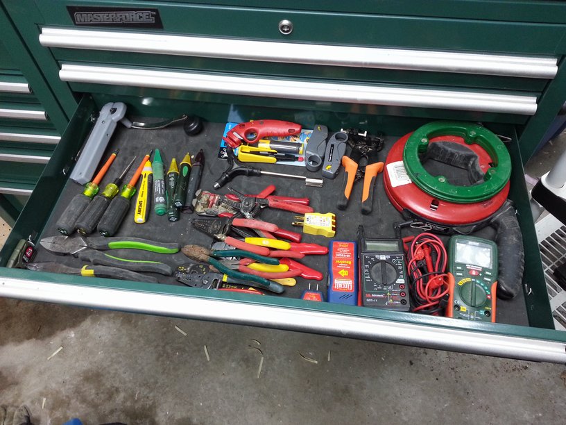

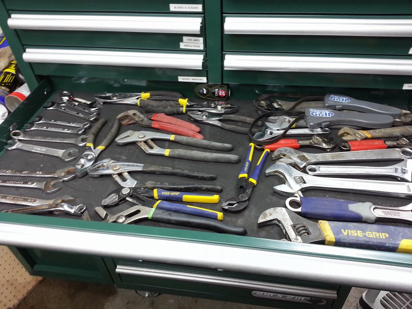

            More tool organization
            Here's more drawers in my tool chest.
