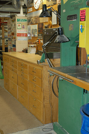

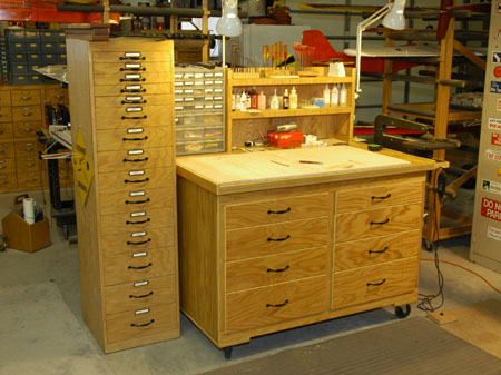

                          I have a similar cabinet also, but I am a retired machinist.
                          For $350 you could build shop cabinets with 30-40 drawers, all using metal slides, and make the drawers as large as you wish. My 18 drawer cabinet has four 12" high drawers, four 9" high drawers, and the rest are 6" and 3" drawers for small items. Metal slides are about $3 each in bulk.
                              I too have a c-man two tier rolling tool cabinet that I keep non-woodworking tools in (but needed around the shop), and also a gift from the wife about 12 years ago. Although Tom is like me and doesn't post very often, one of his post a few years back put me on the track of building all cabinets with drawers below waist level. It is easier to pull out a drawer than to bend down and reach behind other tools, cans, supplies, etc., to reach what you are looking for. This leaves the upper walls free for pegboard and hanging all the various jigs you will build to make each of your power tools more useful, accurate, or safer. Belated, "Thanks for the advice", Tom.
