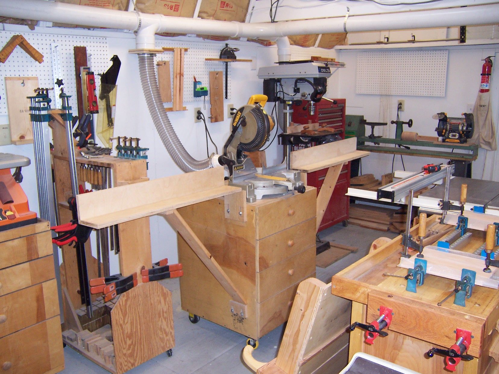

                  Erik is right about the need to keep countertops clear. In a small shop with limited space and tool-placement options, one dodge is to do as I did two shop buildings ago (which, at 10' x 19', was definitely a small shop). Rather than mounting the miter saw with its table flush to the adjoining surfaces, I placed it atop a workbench on an elevated stand and then rigged up some roller supports for long stock:
                  The two portable rollers can be slid left and right to suit the length of the piece being crosscut. The fixed roller at the right end of the OS/B sander provides a second support for longer/heavier workpieces. (Although it's not apparent in this photo, the sander sat far enough back that it was behind the CMS's fence and did not interfere with any crosscutting operation, regardless of the stock's length.) I had another fixed roller at the left end of the bench, but it's out of the frame in this shot.
                  The two main advantages of a setup like this are (1) the work bench doesn't have to be kept completely clear: anything lower than the tops of the rollers can stay where it is; and (2) the CMS table is raised up to a height that makes it easier to see your cut line without having to stoop or bend over so far.

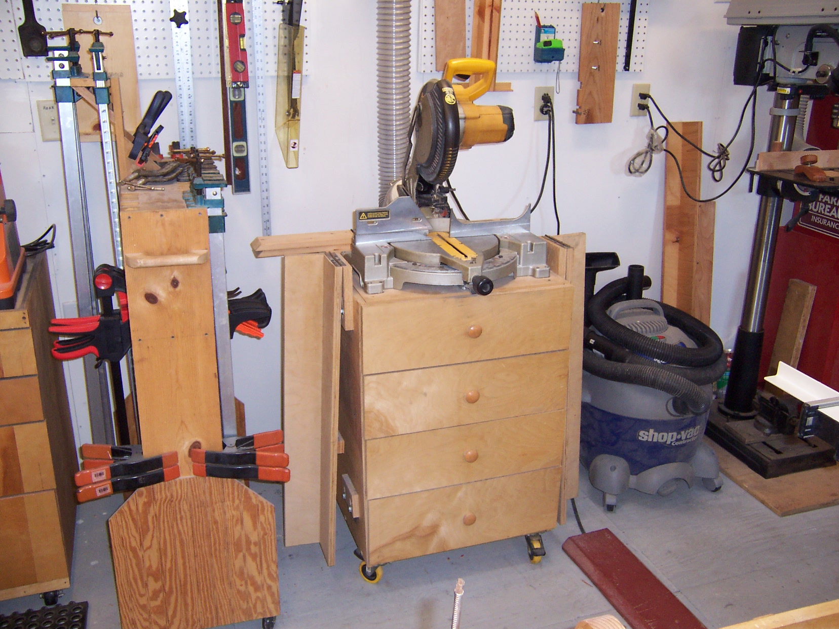

                    Thanks for the suggestions. I will have to think about this some more. I built this a while ago to make my miter saw portable. Well at least luggable. I designed it to sit on saw horses. I don't want to waste this work so thought I would build a stand or cabinet that it can sit on when it isn't at a job site. As-is it is heavy and I am not crazy about rigging up a slide arrangement to slide it in and out. I might do a shelf to store it, and then bring it out as needed but again it is heavy. I might borrow Larry's idea and set it up so the bottom of the current setup is flush with the counter. That elevates it above most of the clutter.

                      David, you might consider a rolling miter station, it has given me the extra storage plus the ability to move to a location that will accomodate whatever length infeed room needed.
                        Along the same lines as what Larryl has suggested above, here is a ready-made product... I have my planer mounted on a similar model, and I love it. It is well-made and stable, and folds up in two shakes and rolls out of the way when not needed.
                          Larry, the rolling station might be it. I am looking to use that space between the counters for a tool, but it occurs to me that the lathe just might fit there, if the fridge is moved somewhere else. I can put the miter saw on a rolling stand and stash it elsewhere. Thanks for the suggestion.
