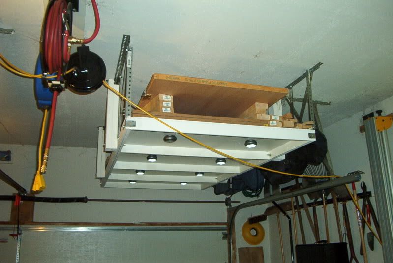

          I had a similar issue recently. The best place for my compressor is in the rear of the garage, which is convenient for my woodworking air tools, but I often use the compressor to fill tires, impact gun, etc. in the driveway. I got a reel that I put near my garage door and ran air hose overhead. Something like this may work for you. The air hose from HF is relatively inexpensive to give it a shot.

              Like os1kne, the best location for my large compressor was in the back of the shop/garage.
              I ran a overhead line to the middle of the shop and used a reel from there.
