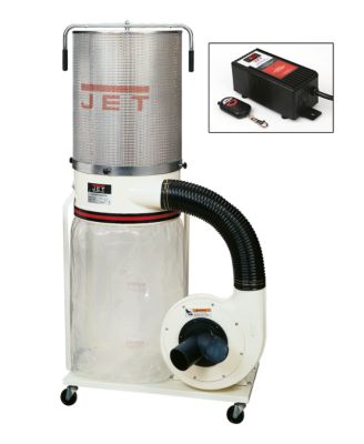

                    I'm using a Jet DC-1100CK, so it's probably a lot like the very popular HF 2hp w/ cannister. Works well in my small shop. I don't have any hard pipe plumbed, I just drag the hose w/ quick disconnect around from tool to tool. The longest run is about 10' (jointer). If my shop were larger, I'd get into a cyclone, Rob's is nice, you make me jealous, a nice 3-5hp cyclone would be excellent.
