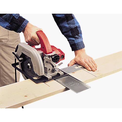

          Maybe cobble together a jig/guide for a handheld circular saw. This jig/guide could incorporate a shooting board (look it up) so you could true up all your cuts with a hand plane, if you needed a more accurate cut than your circular saw provides.
          I have something like this one...
          but you could easily make something out of scrap for one specific angle.
          You can also make something more elaborate to provide more support for the stock. Sort of like this picture, but with your guides at the prober angle.

            Alternatively, and especially for wider workpieces that might not fit on the CMS, I was going to suggest something similar to what pecker shows. A number of the workpieces could be ganged together, side by side and with the ends staggered to minimize waste, with a straightedge laid across them to guide a circular saw. Make the rough cut with the CS; then adjust the straightedge position as required to make a cleanup pass with a router loaded with a straight bit. (Add a piece of scrap at both edges, to control blowout.)

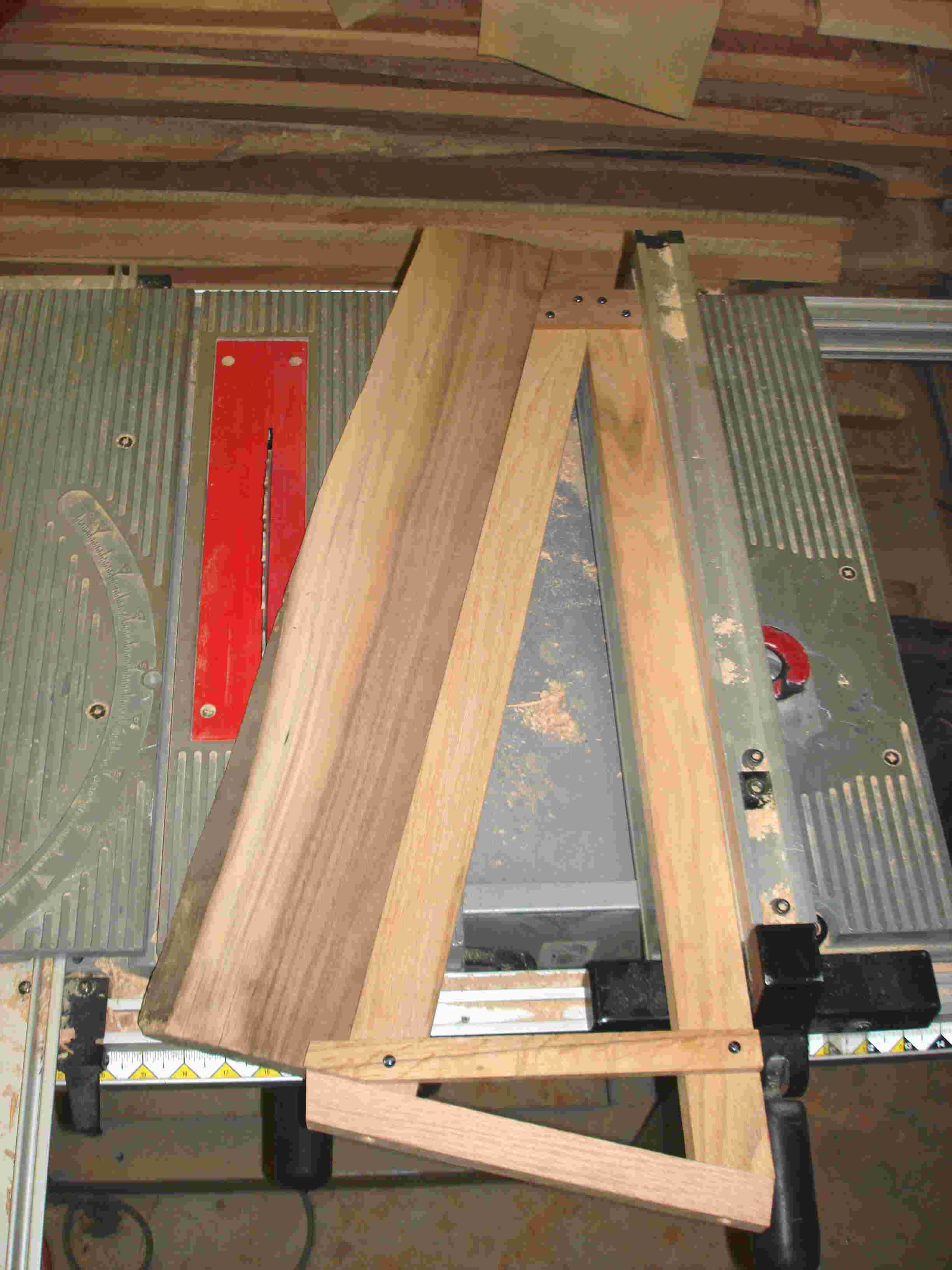

                    If you are asking what I think you are asking, any way, here is a quick jig I put together on Monday to make a set of feet for a project. This jig was constructed at 15 deg.
                    To construct the jig, I trued up two pieces of scrap about 30" and cut the angle I desired on one end using a hold down and a backer board on the CMS. The rest was pretty straight forward.
                    You will neeed some sort outfeed support for 6' pieces. The other consideration is ensuring the boards you are cutting will clear the fence from the starting point.. (don't ask why I know that is important)
                    And here is the pictur with a piece of walnut for illustration.
                      Attaboy, Mike (Shoottx) that's the way I'd do it.
                          This is the main reason I wondered how well a solution on the TS would work. Jon said he needed angles less than 30deg, but he didn't say how much less (and he didn't say how wide, either). I questioned whether there'd be room to keep the rip fence on the rails with a 6' long workpiece.
                          A big advantage of your method is that, even though the workpiece is moving, there's a lot more table area to support it than there would be trying to make the same cut on the typically miniscule tables of a miter saw. And the outfeed support problem is minimal since it's a narrow workpiece that won't have to move very far. All things considered, yours might well be the better method.
                            In my opinion the jig that Shoottx suggests can be made safer.
                            The workpiece is pushed forward by the lip at the bottom.
                            The scary part is either letting the workpiece go with no hold down pressure or using your hand within a couple of inches of the blade.
                            Here's how you make it safer:
                            Put a piece of rectangular plywood under that jig, attached to the bottom of the arms. It should be as long as the jig and a tad wider than the fence to blade width.
                            One edge should be against the fence and flush with the right arm.
                            When you cut, the plywood will be trimmed at the saw blade of course. But the dangerous part of holding the workpiece as you slide it within inches of the blade can then be accomplished with a pair of hold down clamps mounted to the arm of the jig adjacent to the workpiece. You'll have to raise the blade the extra height of the thickness of the plywood.

                              We all agree that some form of jig or support is needed to alter the angle of attack e.g. for a 15 deg cut using a CMS make a 45deg wedge and set the CMS at 30.
                              I am leaning towards something that the workpiece can be attached to and run along a fence similar to what Mike just posted (thanks). Once I finish the design and get to the shop this weekend I will see what works out easiest, safest and most accurate.

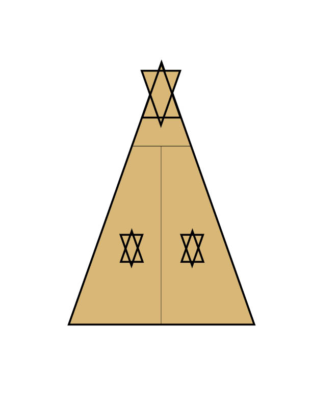

                              FYI - the project is for an "Ark" for a local temple. You know how it goes, somebody who knew somebody who knew me told them I am a woodworker, so I get a phone call, "how would you like to build us......"
                              The design is centered around the "star of David" which is essentially 2 reversed triangle. The pic here shows the basic concept.
