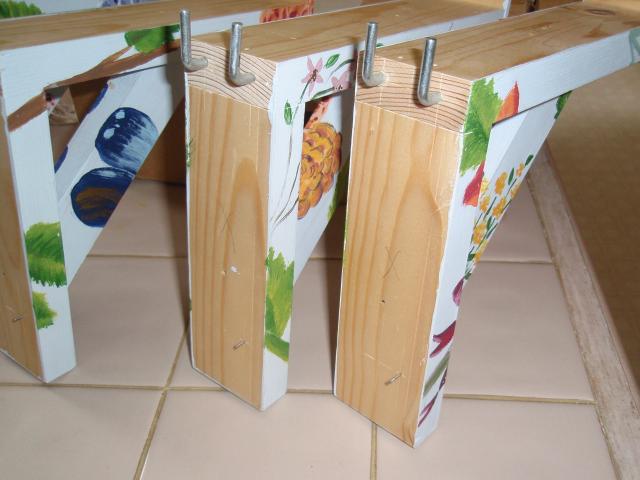

            ypu can custommake hangars for bigger stuff.
            Take a 1x2 about 4 inches long. We'll make it hang vertically, the 2" side against the pegboard.
            About 1/4" down from the top on the back, put a threaded L-hook into the 1x2, centered. Leave about 1/4" between the back and the "L" of the hook, with the hook pointed up.
            Now drill a 1/4" hole about 1/2" deep into the back of the 1x2, exactly 3" from the location of the L-hook. Put a piece of 1/4" dowel into this hole, cut it off about 3/8 to 1/2" above the 1x2.
            Now you can drill a 1/2" or 3/8" hole or holes into the front of the 1x2, at an angle upwards if you wish. You can put a dowel of any length - 4" to 8" being reasonable into this hole.
            Now slip the tip of the L-hook into the pegboard, rotate the 1x2 down so the 1/4" dowel peg enters a hole 3 spaces below the L-hook and you have a pretty solid bracket with a substantial peg. If the L-hook fits too tightly, you can back it out a few turns until it slips into place neatly. (you may have to do this because pegboard comes in thin and thicker weights, like 1/8 and 1/4" I think.) The 1/4" dowel you may have to push in place, but it holds the main shear weight. The L-hook only provides the cantilever and pull-away strength.
            The dowels won't be sharp (round off or chamfer the ends if you want) and they can hold alot.
            you can make wider ones with multiple L-hooks for supporting much larger stuff. You can use trianghular braces with end caps. I made shelf brackets for my daughters dorm room where they could only use the existing pegboard and not make any holes in the wall. They were 8" deep and for pics and knick-nacks, not books of course.
            found the bookshelf-supporting ones I made, I didn't use 1/4" dowel for keeping the bottom from swinging, I just used a small finish nail... Here the pics (my daughter did the painting) - these were to support 8-inch shelving:

              Loring,
              Your daughter did an amazing job painting those brackets!
              Question - did you find that it was a 3/16 L hook you used?
                    Thanks, I'll be sure to tell her you said so.
                    I guess 3/16ths would be about the right size, I don't recall how they sell them. Obviously that would allow them to clear the 1/4" holes. Just have to hunt the hardware aisle at the HW store until you find something that looks right.
                    You need to put them close to the top so you can rotate the bracket up the hooks. And you can adjust the amount the hook protrudes to get it close to the peg board and adjust for the thick or thin peg board.

                      I also would like to compliment Lchien's daughter for the beautiful painting she did on those angle brackets.
