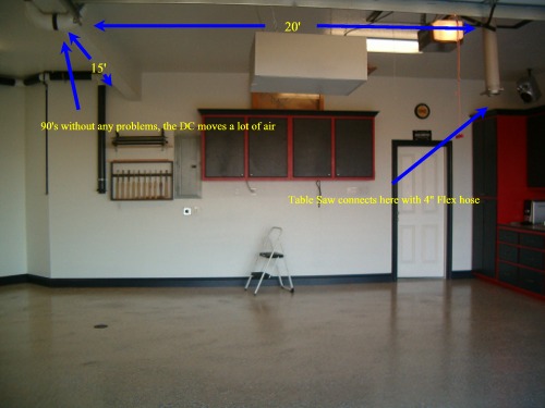

        I have included some pictures of the runs in my shop with 4" PVC pipe and I have not had any problem. I probably have 40' runs.
