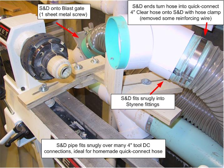

                              Originally posted by LarryG
                              Tom (and others): I know that you used the green S&D pipe, but ... tell me again, please, what kind of gyrations you had to go through to mate these up with standard 4" DC hose and fittings? Am I right in remembering that this pipe uses the standard white Schedule 40 fittings?
                              Lastly, the Lowe's here has the green S&D pipe, Schedule 35, for around $15 for a 10' piece. They also have a white pipe that has a bell on one end; it too says S&D but it's not Sch 35. It appears to be exactly the same stuff as the perforated pipe used for foundation drains and leach lines, sans the holes. Cost is seven bucks per 10' stick. Has anyone used this? If so, does it use the standard Schedule 40 fittings?
                              Schedule 40 fittings do NOT fit the green (schedule 35) S&D pipe. At my HD, the S&D fittings, which may be made of styrene, are in a smaller section next - to the Schedule 40 fittings. Also, the schedule 35 pipe I get at HD has one flared end, to allow connecting pipe end to end, FWIW.
                              I'm not sure how well the thinner wall white stuff fits these fittings, or how it will work with the stock dust chutes on machines. So you'll have to do your own research if you go that route.
                              One more note about nomenclature: the schedule 35 stuff is also referred to as ASTM 3035, and the thinner white stuff is ASTM 2729. You may see these markings on this pipe.
                              I find the schedule 35 pipe fits OVER the following:
                              - aluminum blast gates (use a screw or two if you need rigidity)
                              - most 4" plastic machine dust ports (Jet jointer, Ridgid planer, Performax drum sander)
                              - most plastic (Jet brand, e.g.) DC fittings, INCLUDING 4" to 2.5" REDUCERS. While it also fits over the elbows, wyes, etc., I recommend against these in favor of the styrene fittings for better air flow.
                              The schedule 35 pipe will fit INSIDE:
                              - the styrene fittings made for it. D'uh!
                              - the clear DC flex hose that you get at Rockler or Woodcraft, but you first need to remove a couple turns of the reinforcing wire. I usually use a hose clamp, too. With a 4"-6" piece of pipe inside the end of such hose, it is now a quick-connect fitting for a 4" DC port on a tool.
                              Here's a pic that shows some of this:
Name:	S&D for DC.jpg
