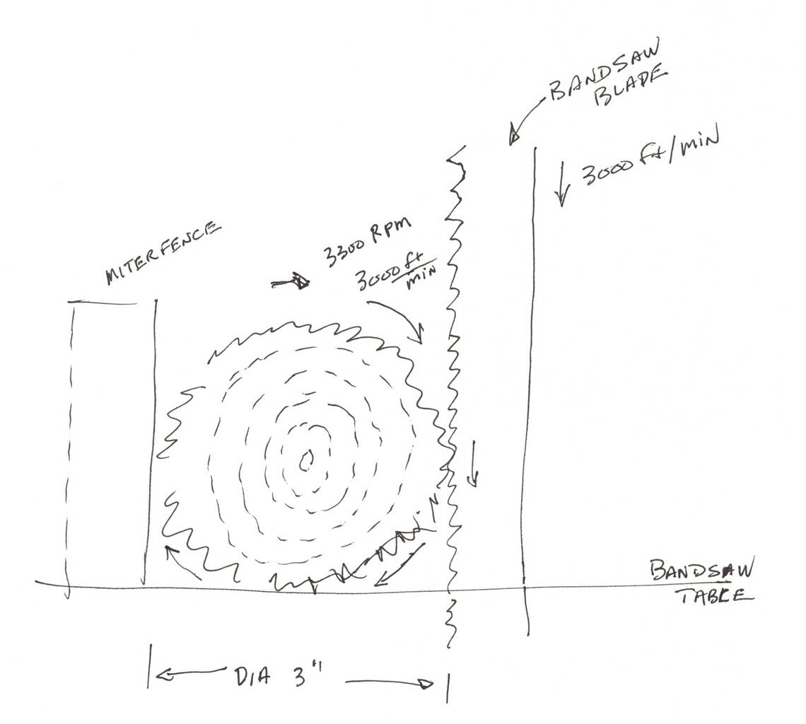

          If you have a typical woodworking bandsaw the blade cutting speed is going to be around 3000 SFPM (surface feet per minute).
          If you try and cut across a 3" log, then sharp teeth will engage the circumference, bark or smooth, and grab it. That will make the log want to spin at 3300 RPM. A literal spindle sander on your skin if you happen to be holding it.
          A 1" log or dowel will want to try and spin at nearly 10,000 RPM!
          The length and weight of the log matter some. The shorter and lighter it is the less inertia it has to overcome to set that thing spinning.

              Originally posted by leehljp
              ROLL PROTECTION! That is a MUST, that I have not seen described before. Thanks!
              Roll protection = clamp it to the miter fence.
              you still have to be careful because the roll wants the leading edge to go down with the teeth and the back edge to go up. A shear force on the clamp 90 degrees from the clamping force if you clamped it to the fence. It'll want to toss that clamp.
