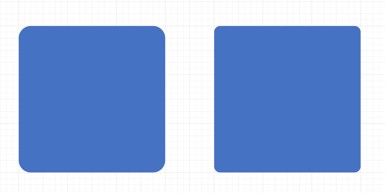

    • 22040
    I just wanted squarish corners with a small but nice looking small radius.
    Reason is complex and immaterial.
    Using a half inch router bit will leave corners like the left . Much bigger than I wanted. 1/8" router bit on the right.

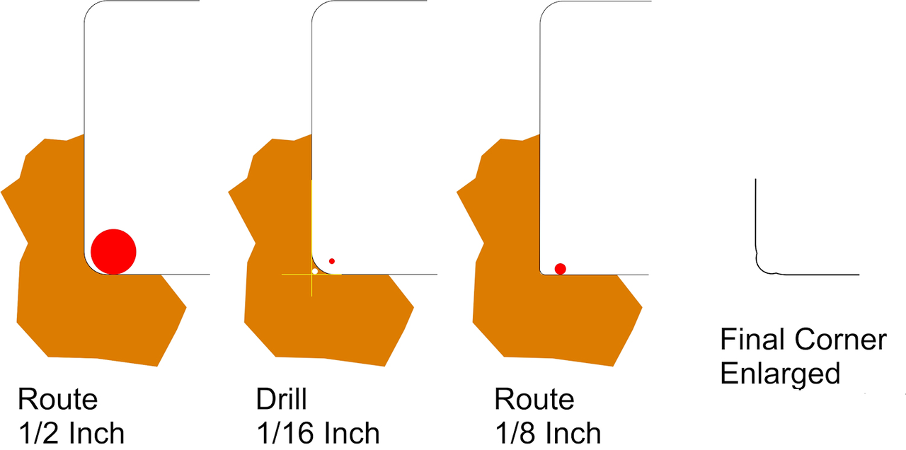

          • 2809
          Hi Loring,
          Not sure what you are building, and as you say, it probably doesn't matter. I'm picturing a solid piece of of woodstock, with a recess of whatever depth, in the shape that you have illustrated. Sort of like you could store something in that recess. (Probably way off your objective )
          I'd start with the the larger 1/2-inch bit and route your shape, as you propose.
          Then I'd use a 1/16 inch drill bit or smaller to drill just inside the four corners, followed by your 1/8 inch router bit. That would sharpen your corner, and the minor peak left betweek the drilled corner and the 1/8 diameter, would be so small that it probably wouldn't be worth the effort to slice clean.
          Here is an illustration showing one corner:
          Click image for larger version  Name:	image.png Views:	0 Size:	94.2 KB ID:	862175
