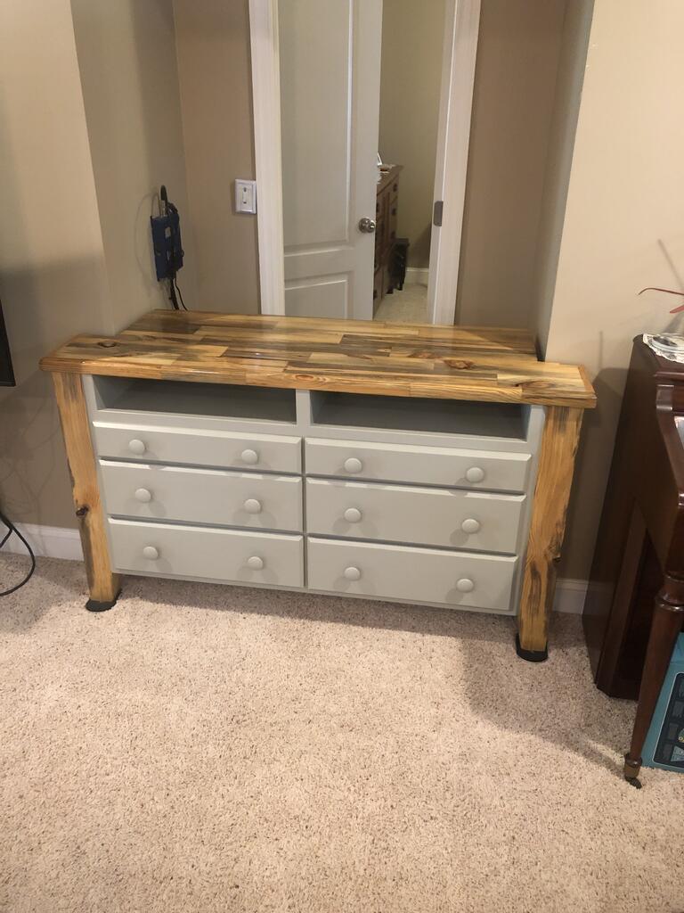

          Jest? Not this time, plywood is some nasty stuff inside. The plywood is just the stable flat base for the display boards to be attached. Only the top display side is planed. I’ll attempt a photo of a cabinet top that I’m working on now…. Unfinished project. This top is similar to what I was describing but not planed, sanded only. Click image for larger version

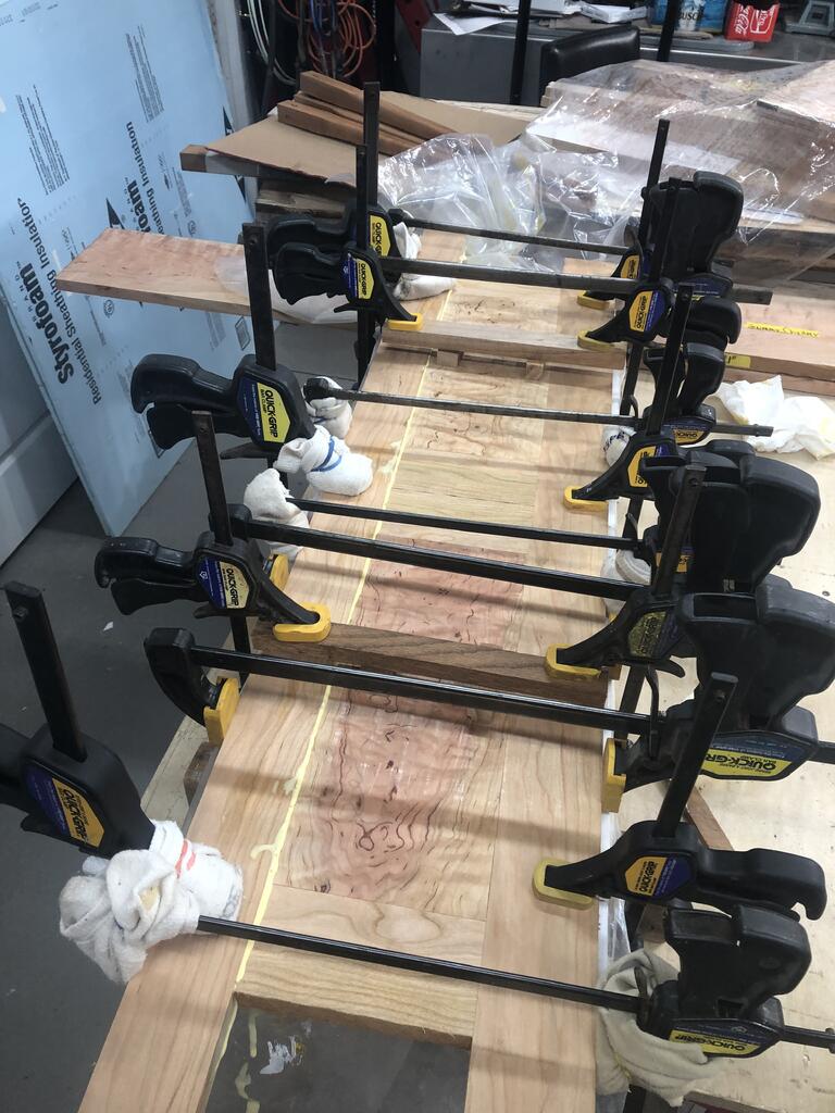

              DBhost,

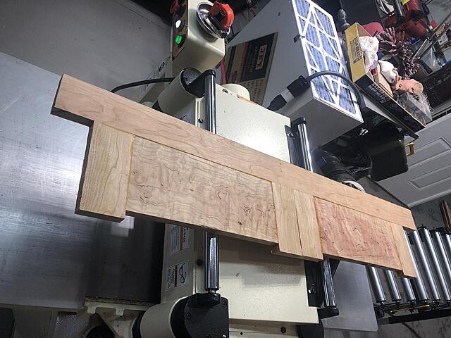

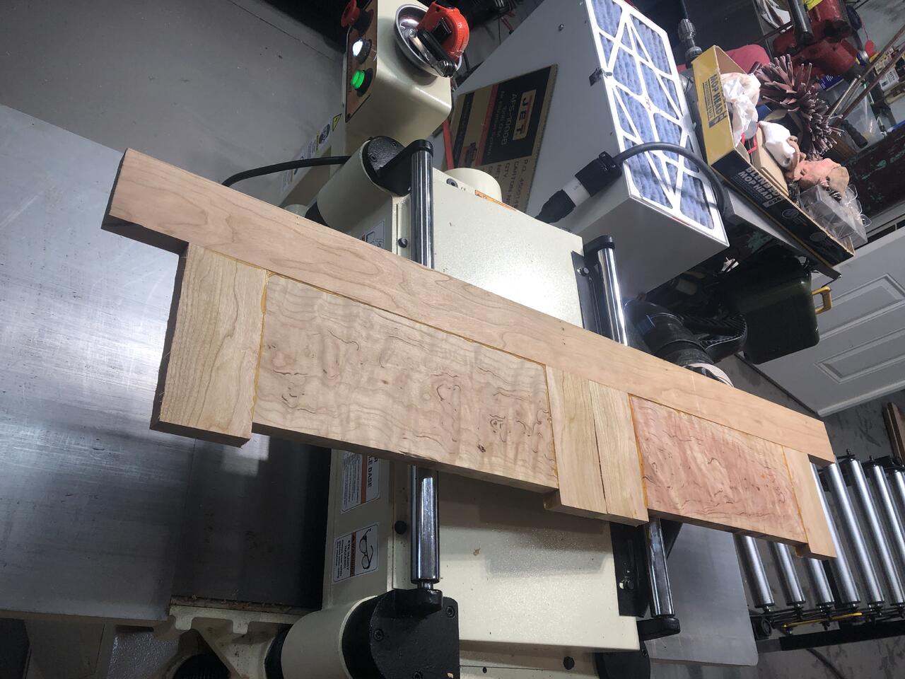

              A good number of my Tiny table tops have a frame outside with a different kind of wood inside. Example: I use a gummy cherry center board with a cherry frame surround. This process provides a slight color and texture difference between the centers and the frame. The top is planed smooth then sanded to 2000 grit. By using butt joints rather than miter joints I am able to virtually eliminate any joint lines and drastically speed up the construction time.
              This method could be used to create striking looking doors without a lot of fretting with joints.
              In the attached photos the glue up shows that the frames and centers do not have to be milled the same thickness. The differences in thickness will be flattened with the final planing. Note that this photo shows 2 table tops in partial glue up because it takes as much time to do 2 as it does to do 1. Note that there is aprox 4” excess material on each end to allow for planer snipe. Not everyone has a planer with no snipe to contend with.

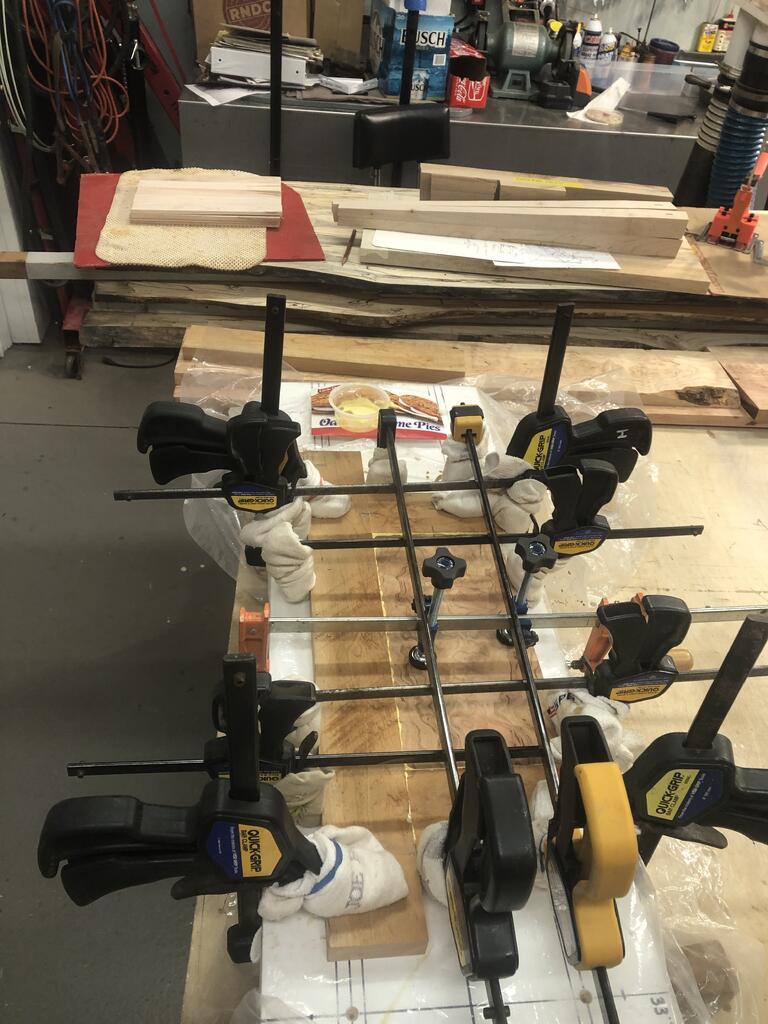

              this photo shows the simple glue up of this stage of the top build. Photo is of a single top rather than a 2 top as discussed.

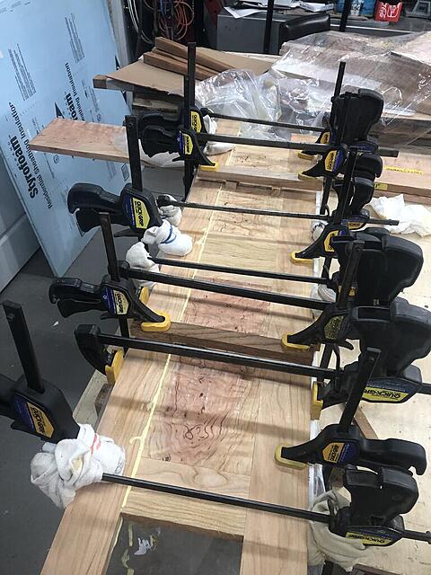

              This photo shows the final glue up of the 2 top job. The previous photo glue up was cleaned up and the assembly was ripped on the table saw to provide a continuous straight cut for the final side.

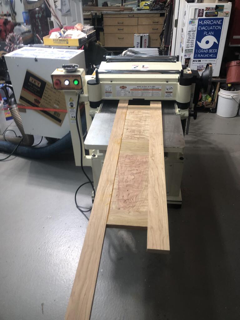

              After the final glue up the 2 table top set up is ready to be planed. Everything will come out ready for final sanding.
