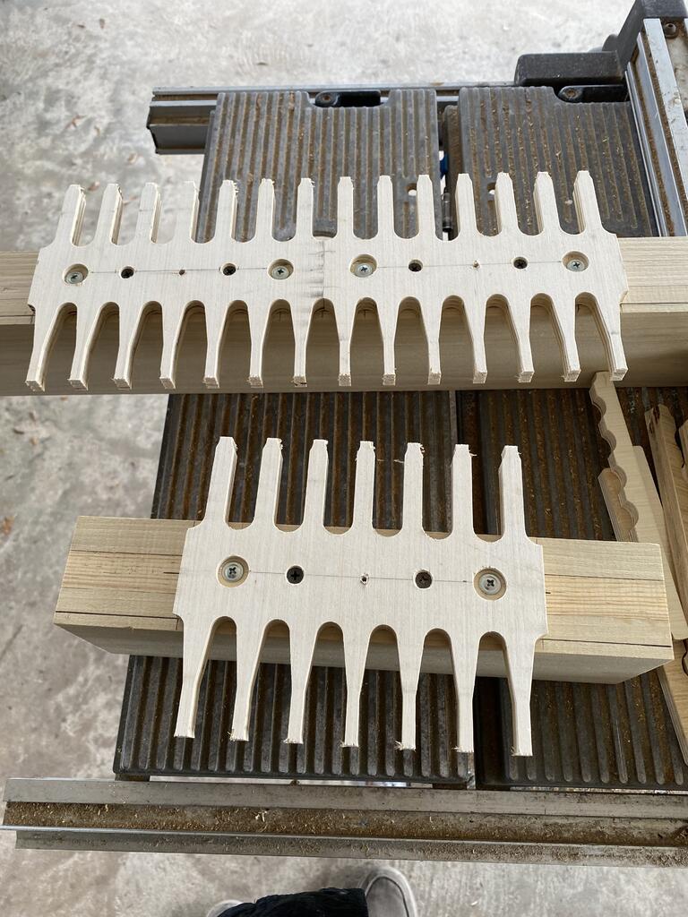

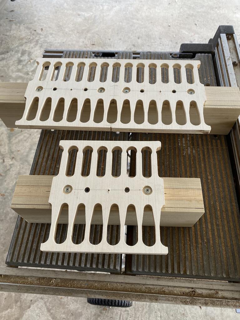

    Hey you said you had this jig... its instructions suggest using a 2-7/8" wide, 4 inch tall and 18 inch long base for the jig template.
    I was looking at that and thinking of making the block of laminated 1x6s four boards ripped to 3/4" thick by 4 inches wide laminated together to give 3" wide, and trim to 2-7/8"
    It occurs to me that I could mill a slot 1 inch deep and 1-1/2" wide in the bottom for storage of the bits and template guides that it needs to keep them all together.
    That would leave enough meat for the T-track if I wanted it and it would not have an detriment to operation, I think The block is cut into in operation but that's shallow and way above the bottom, no more than an inch from the top.
    Click image for larger version  Name:	20250313_235512.jpg Views:	0 Size:	77.2 KB ID:	860728
    Make sense?
    Do you use yours handheld or upside down on a router table?

    That makes sense to me.
    I made a similar base a few years ago 9but with less options - for a cheaper version:
    https://www.sawdustzone.org/filedata/fetch?id=845449
    https://www.sawdustzone.org/filedata/fetch?id=842352
      LCHIEN commented
      Do you use those with a handheld router or do you flip it over and use it with a router table?
      leehljp commented
      I used it one time with hand held router. it was a practice run only. For some reason, I never did use it for the project I had planned.
    • 9509
    Sorry I have been with family since it is spring break and my neices and nephews were running me silly...
    I made my block back in something like 2008 so the memory on what I used is rusty, has to be 2x6 stock because, well I am too cheap to pay any more for it!
    I never did cut the slots for the T track, I have it, just haven't done it (yet).
    I use it with a handheld router clamped to the workbench with some quick clamps.
