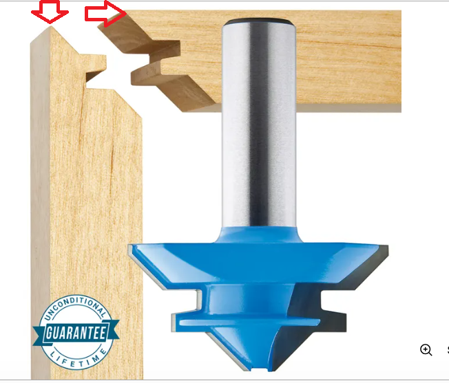

    The other thing that bothered me was, well lets say you are joining two 1x4 boards.
    One board (A) you will lay flat on the router table with the narrow edge against the fence. and the other board (B) you will have standing on edge on the router table with the wide side against the fence. When you run A you will end up with a very thin knife edge running against the fence as you end the cut. THen when running B you end up with a knife edge running against the table.
    Its a problem with those knife edge when you reach the end of the cut. If you use it for short length bevels, like a box just 3 inches high, then its unmanageable because the lengths are too short to rely on using the knife edge against the fence or table - too easy to dent the edge and lose control. Anyway, it made me nervous.
    Click image for larger version  Name:	image.png Views:	0 Size:	330.3 KB ID:	859659

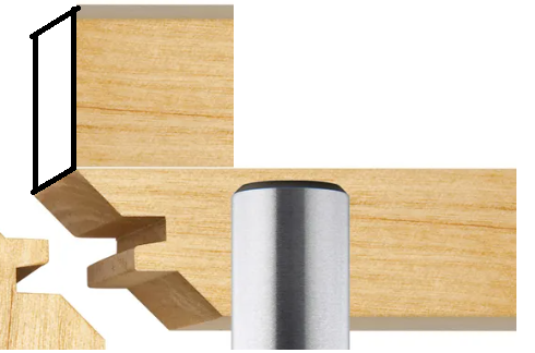

    One thing I might consider is double stick taping a auxiliary piece to the edge of the part that will become knife edge to support it as it goes through... that will ride against the fence or table solidly.
    Click image for larger version  Name:	image.png Views:	0 Size:	145.9 KB ID:	859660
