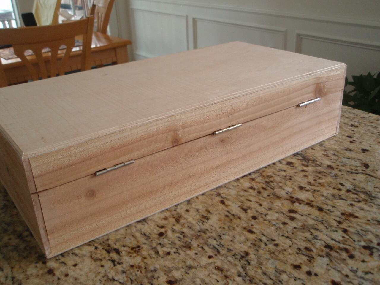

    Made this box for my new Kreg KPHJ720 jig kit because the carboard box didn't seem like a long term solution.
    Click image for larger version  Name:	P5260069.jpg Views:	0 Size:	97.5 KB ID:	859020 Click image for larger version  Name:	P5260079.jpg Views:	0 Size:	131.5 KB ID:	859021
    Its fairly heavy (12 pounds). The thing about is that the hinges stick out the bottom which means it won't stand stably but it rocks and the hinges scratch up the table.

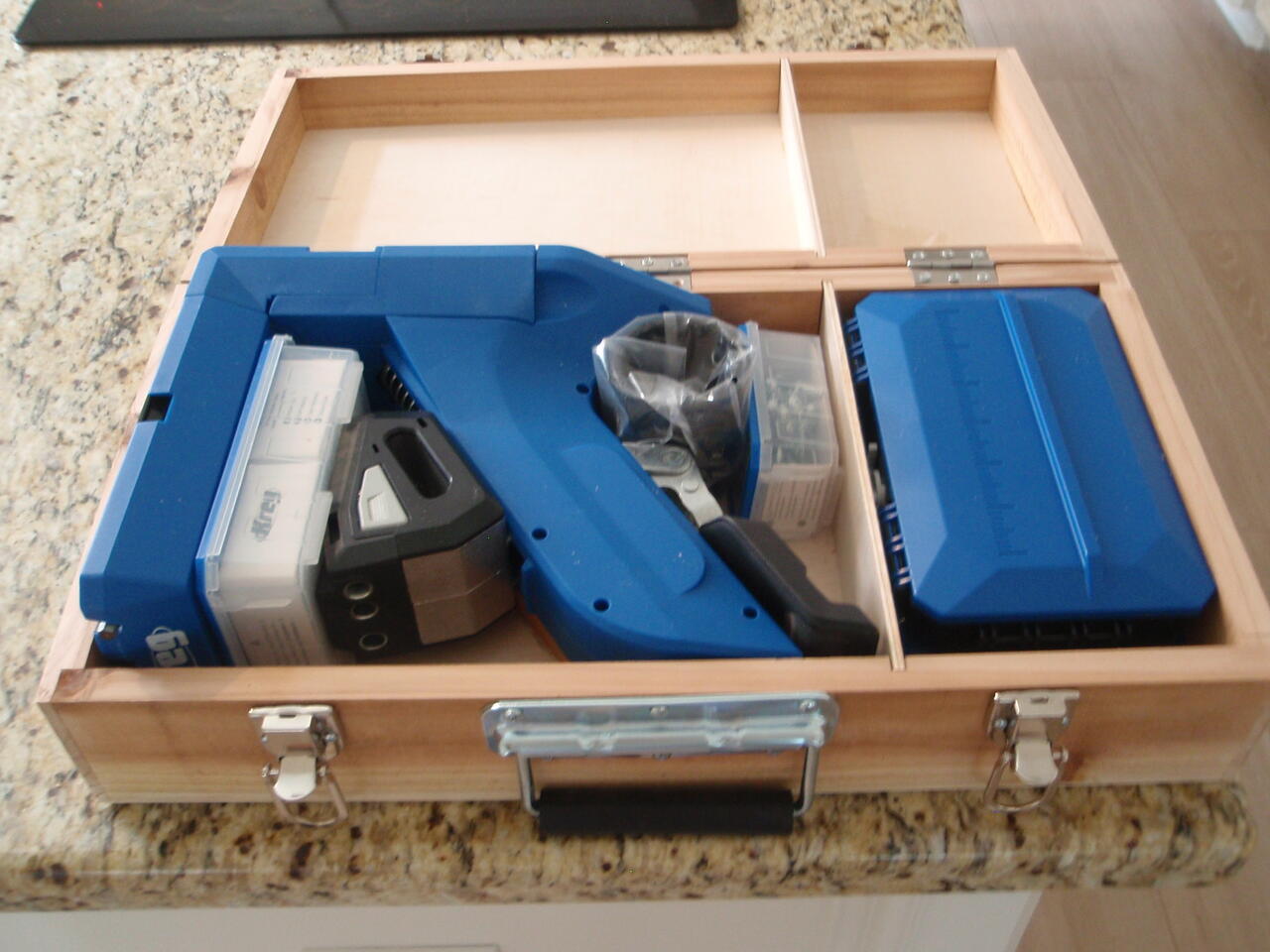

    comments and thoughts? Oh, here's the inside:
    Click image for larger version  Name:	P5260070.jpg Views:	0 Size:	124.3 KB ID:	859022

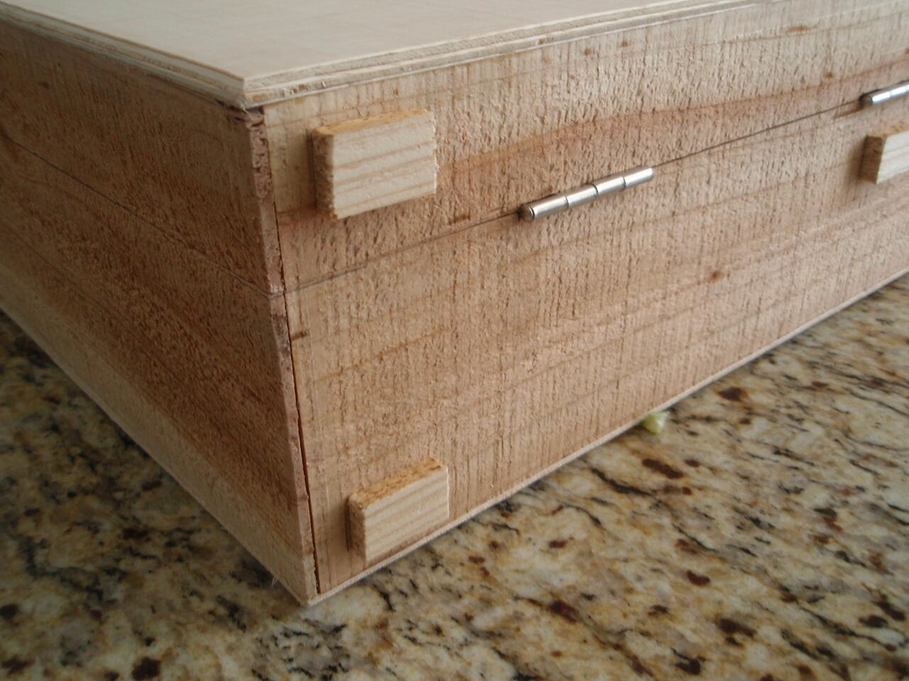

    Decided to go simple and cheap, just superglued some wooden feet to keep the hinge barrels off the table or floor. One in the middle to protect the middle hinge barrel.

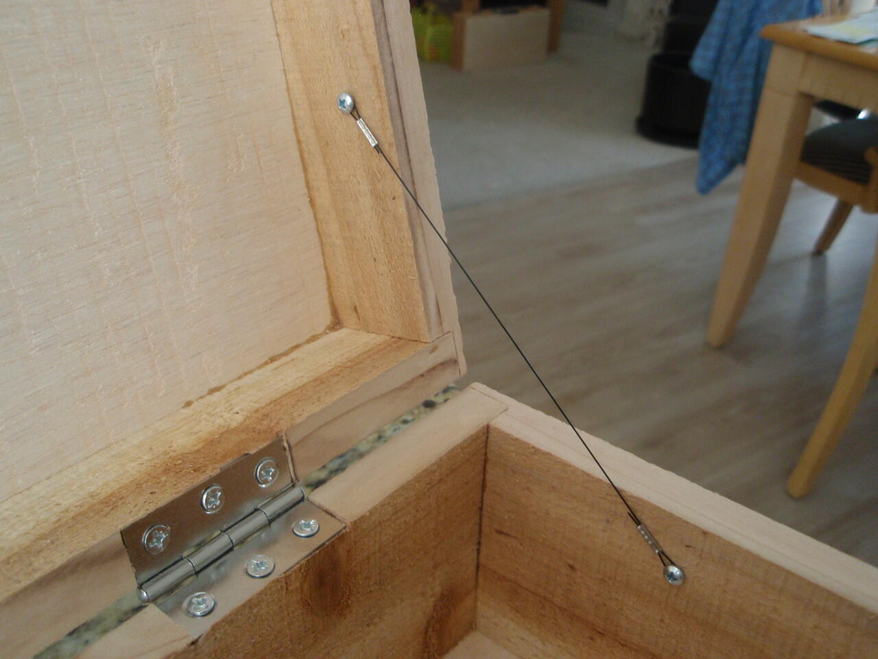

    The case won't open 180 degrees like MPC predicted but I didn't want it to.
    I put this opening stopper in (20# 7-strand flexible steel wire with crimps):
