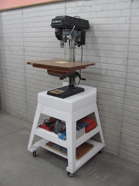

    Mine is lag bolted to a top made from 2 by construction scraps edge glued and biscuited together. I believe I used 3/8" bolts as that what fit in the holes in the DP base. The wooden top was attached the the old BT3100 steel base by screwing up through the base into the top (basically an upside down shallow box) with some deck screws.

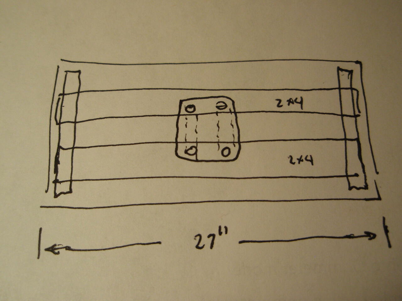

        Dave, here's my take. I'm basically a lazy guy.
        Your tool chest is 27" wide. Probably has a lip on the sides. with 27" clearance.
        The top is probably thin sheet metal, too thin to attach the DP to directly because its so flexible and just supported at the edges.
        I would simply cut 2 ea 2x4 x 27" long and set them on top of the chest. Place the DP on top of them with the pedestal spanning both front to back.
        Adjust the spacing between them so you can put lag screws though the holes in the pedestal into the 2x4s close to the inside edges. making the 2x4 separation as large as possible to have the most forward and back stability. 3/8" lag screws with large washers should be fine even in oversized slots in the pedestal.
        You can if you want fasten the 2x4 to the cart, but I doubt its necessary. You now have a 27" wide footprint that will be difficult to tip over sideways.
        The front to back stability is probably good enough but you can add some outriggers with 2x4 feet to the ends of the 2x4 to extend them to the front and back of the top of the cart.
        The lip at the sides and back will probably keep it from sliding off or moving around.
        I'm betting there's plenty of weight and dimensional area now for stability and to not have to fasten it to the top of the cart by any more than gravity, unless it makes you feel better.
