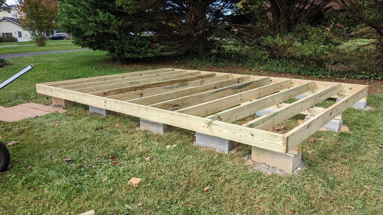

    Because I had to do something while my concrete footer cures... there's a shed in that pile somewhere.

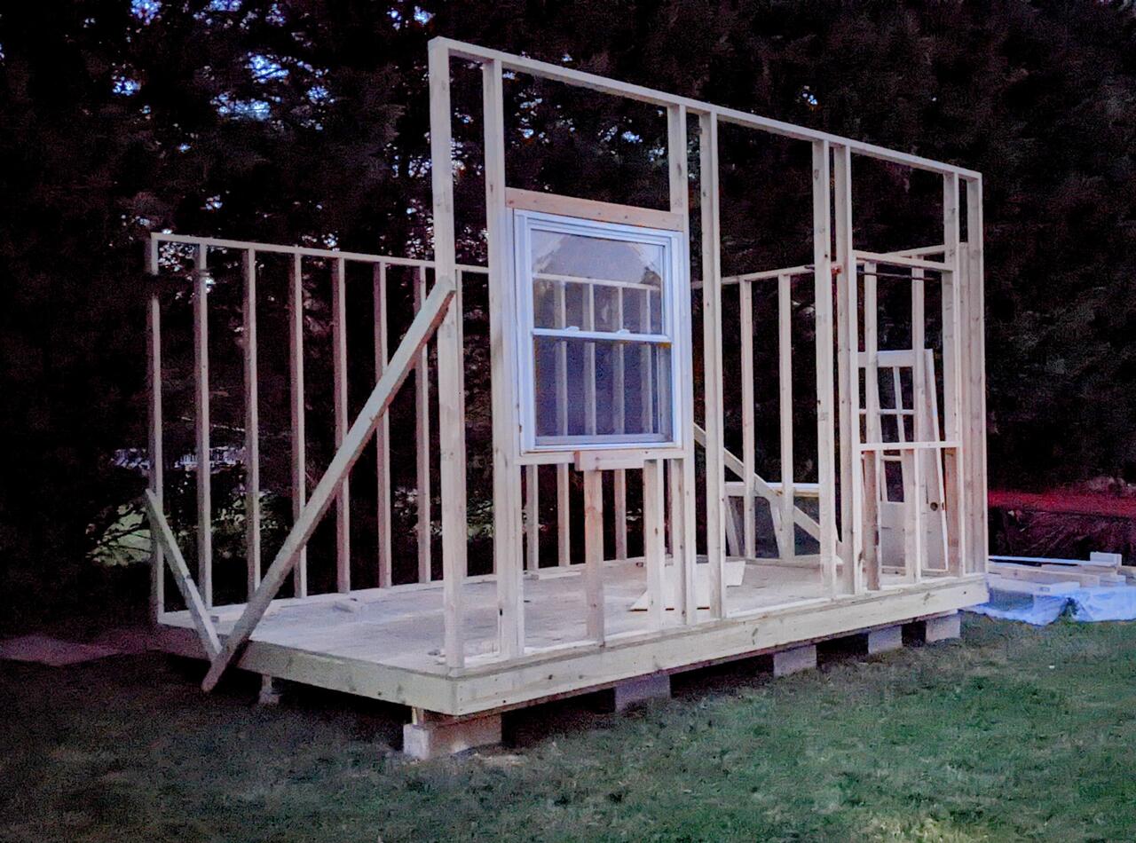

    Throughout this past week after work I laid and leveled 15 concrete blocks for my shed base. Today I laid the skids, framed the floor, laid the floor (3/4" PT plywood is HEAVY) and managed to stand up two walls on my own.
    The shed is 10x14 and will be a lean-to style with an 8' back wall and 10' front wall.

      16" stud centers? Strong! Any hurricane clips? Oh, Maryland, probably not.
      was the skids fastened to the blocks or can it really skid off?
        atgcpaul commented
        12" on the back. I plan to mount my lumber rack on there and load it up. It was just 3 extra studs--cheap insurance. I will also be guaranteed to hit a stud when I hang the siding panels on the back. It will be 16" on the other 3.
        The skids are not attached to the blocks. I could conceivably drag the shed to a new location later. I don't need a permit for a shed smaller than 150sqft and there is a tie down requirement for sheds under 400sqft. I should have done it sooner, but I did plan to use some ground screws.

      When you're done with yours would you like to come down to Texas and help me put one up we put 1 up?
        I would love to! You dig in and level those concrete blocks, though! Everything else so far hasn't been so bad.
          dbhost
          commented
          Yeah, it's the footers I need help with. Probably going to have to just hire it out. I need to remote 2 trees to get the space I want in there. I actually need to level UP the pad, Flooding and all... Garage still too small to use as a garage, only need storage shed to get non shop stuff out of my shop.

        Come on now! You fretted so much about doing everything to code and tried so much to impress the inspector with your footer mods,….. and you are building a shed with no Hurricane tie down or hurricane clips! They are not just for hurricanes but for tornadoes and other strong winds eat sheds like what you are building! When they snatch the roof off it gets pitched through your neighbors sliding glass door! Not a pretty picture.
          LCHIEN commented
          Without the Hurricane clips it will blow the roof off in a storm and through the neighbors plate glass window..
          With the clips, the whole shed will blow off the blocks and knock down the neighbors house.
          atgcpaul commented
          No code for shed below 150sqft. I haven't gotten to the roof yet which will have the clips. The tie downs are en route.

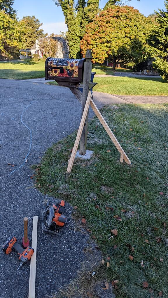

        Yeah! Amazon delivered the tie-down anchors this morning around 6:30am. (I was awake)
        The driver also mowed down my mailbox backing out the box truck. We didn't discover it until before 8am as my wife was driving away. Amazon customer support says they will make me whole (after an investigation). I guess I should go temporarily brace the mailbox so the postal driver doesn't get POed at me?
        Maybe I should be thanking Amazon because that post was set in concrete and it was definitely rotted out.

          atgcpaul commented
          Amazon owned up to it but now wants me to get an official quote for the work. I'm trying to find a handyman or fence company.

              We wanted two windows and a regular door on the front wall. To save money, I've been trolling Facebook marketplace and found what I needed--2 used vinyl replacement windows and one 9 light exterior door. The door is 36" wide but the guy couldn't meet me until tomorrow (Sunday) even though I found it on Tuesday.
              Anyway, I had the afternoon off yesterday and framed up the king studs on the front wall using the expected dimensions, and raised it up.
              Today after a morning spent at the DMV to title/register our car, we went to the Restore and found the same door, but at 32" and at half the price. Since this was a done deal, I told the other guy I'd pass, and brought this door home.
              Of course, that meant I'd have to reframe the doorway, and now that the door was narrower, my wife wanted to reposition the windows. Wall came down, studs moved, wall went back up.
              I then added the jack studs, sill, and header, and took one last measurement before lifting the window into place. I was off by 3"!!! . I had put my king studs into the wrong location also meaning my sill and header were cut too short. So down came the wall again, move everything again, stand it back up, and cut more wood. Thank goodness I decided to use screws instead of nails!
              I had hoped to hang some siding today but the afternoon got away from me after those two do-overs and it was too dark to work. Even if I brought a light out, I didn't want to keep running my impact driver and annoy the neighbors.
              Tomorrow will be another day.
