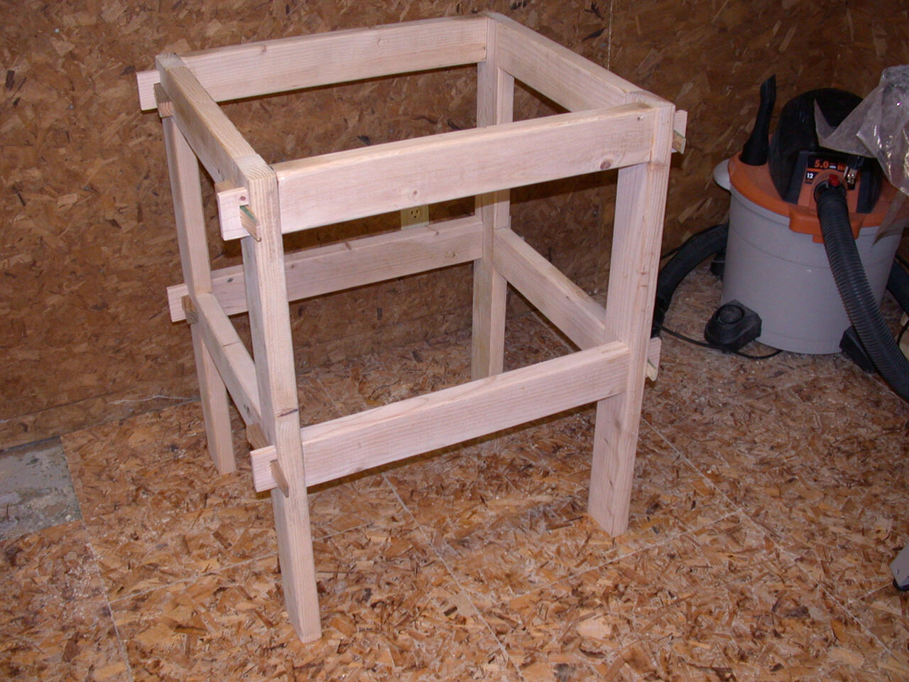

        Though I like M&T joinery, I haven't used it for what I would call 'finished furniture'. I've used it to make knock-down benches for my radial arm saw and router table. The tenons I rough cut on my RAS and then finished on the router table. The motises I cut by hand with a mortise chisel. The first table I just used the mortise chisel, but afterwards I used the drill press and finished them with the chisel. Both tables are thru-mortises with longer tenons that I used wedges on to lock the legs tight. That way, I could take them apart which makes them easier to move. Below is a picture of my router table base.
