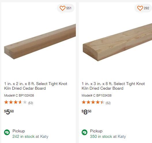

    There are hundreds in stock on Katy HD.
    1x2 and 1x3 should be ideal for your roll up platform, you can rip these narrower if you want.
    8 foot long, you should not need too many. I figure 2 boards of 1x3 ripped in half and cut to 24 inches wide with 3/4" beads between them. 8 slats per board. you only need 1-1/2 to make a 24" x 24" platform with 12 slats on 2-inch centers.
    Click image for larger version  Name:	cedar board.jpg Views:	0 Size:	22.7 KB ID:	849468

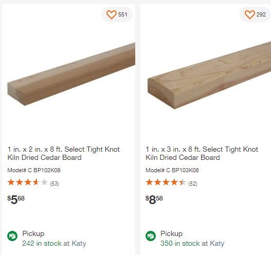

      I might have to go to Katy to get them. Clear Lake Shores and Dickinson do not have them. I don't mind. My SIL is in Memorial. I'll drop my wife off to have lunch with her sister while I go get some lumber, Yeah I am thinking 2 1x3s. I found the beads I need gray plastic 3/4", and Michaels. My wife loves that place...
