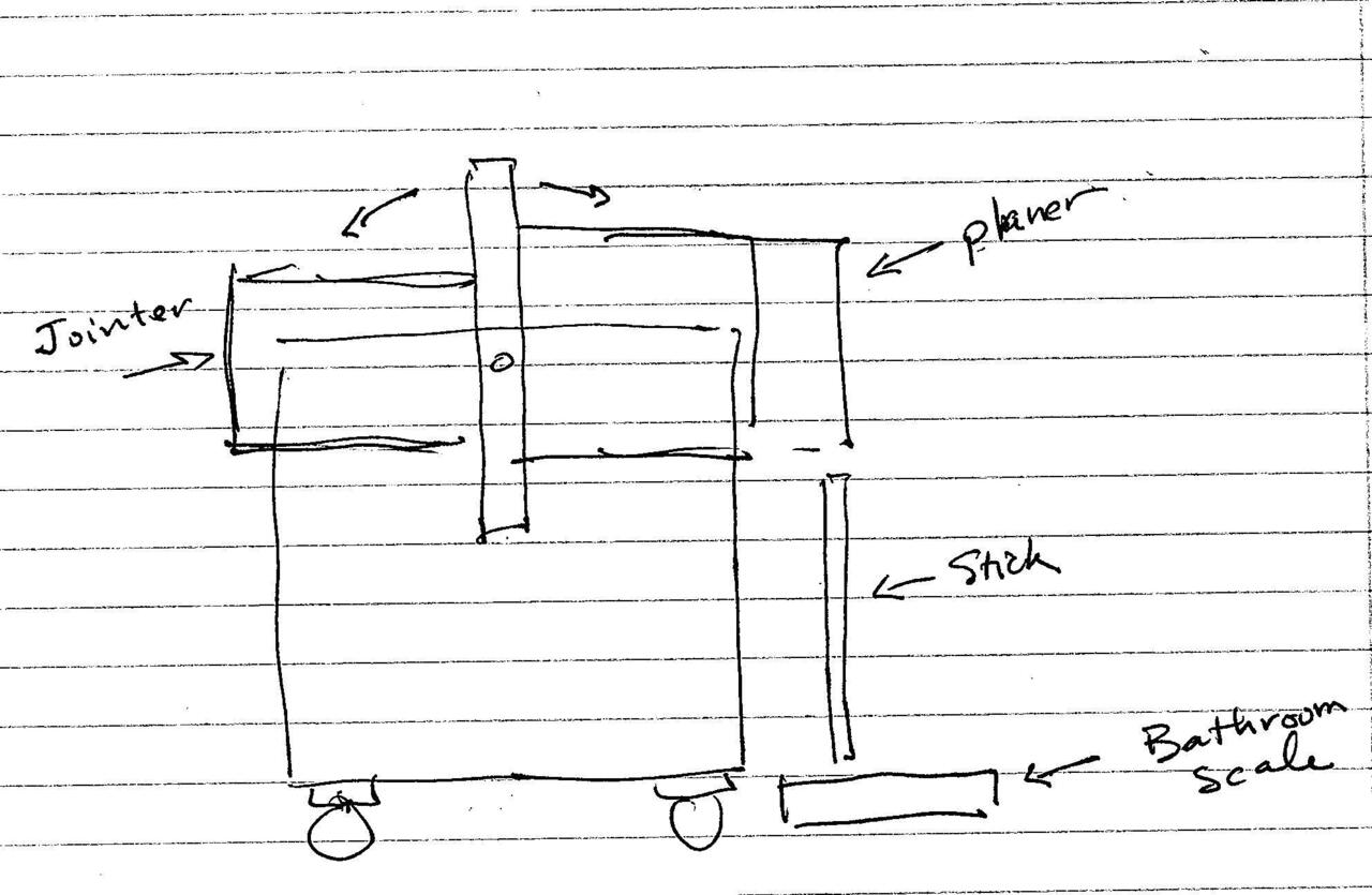

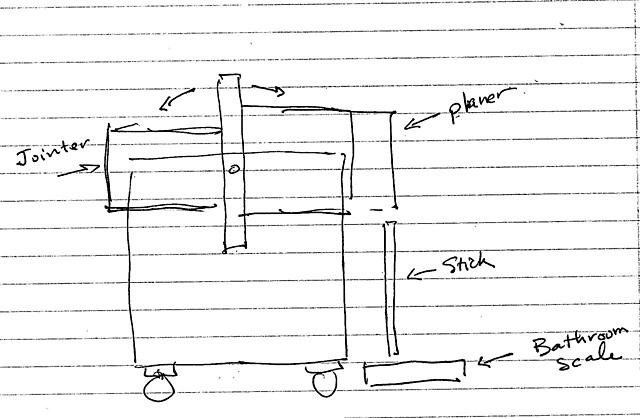

    What's the weight of the jointer?
    What's the weight of the planer?
    Are they close enough to balanced so its easy to flip or is it a bit of a wrestle?
    What's the force when its halfway flipped (put a stick under the outer edge of the heavy side tool resting on a bathroom scale).?

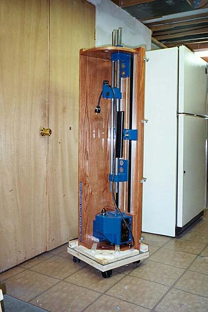

        I got your roll around tool stand right here. Just kidding.
Name:	Shop Built Duplex Lathe Stored small.jpg
        Jim Frye
        The Nut in the Cellar.
          LCHIEN commented
          Vertical lathe!
