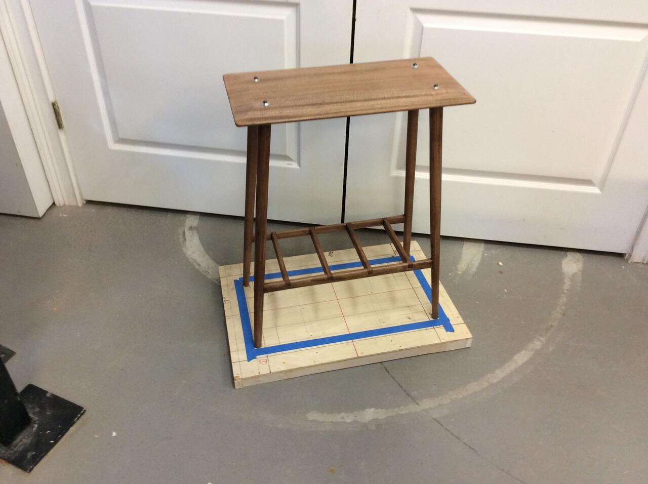

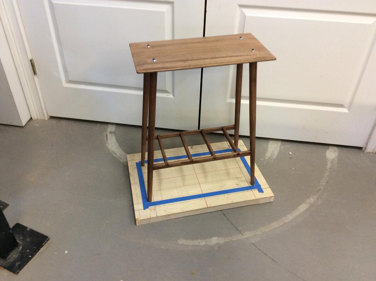

          I started building my Tiny Tables about 12 yrs ago, and went through many revisions until I came up with a design that I liked. I made mock up prototypes out of scrap wood to visualize the leg angles and shelf height. ( Don’t forget about shelf height above the floor, can the vacuum cleaner or broom get under it or will you have to move the table for floor cleaning every time! ) The prototypes were usually assembled with kreg screws, and the tops had rows of holes for different angle set ups.
          Is your coffee table going to have sharp, crisp edges and corners? It is a matter of preference. Furniture that I have built with sharp corners and edges have shown more bumps, scratches and knocks than the pieces I’ve made with rounded/softened edges and corners.
          I could not find a photo of earlier prototypes but this is a mock up table with no aprons and almost round legs.

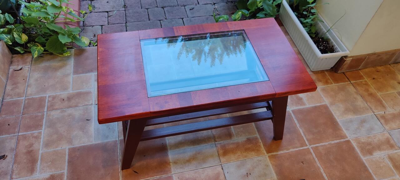

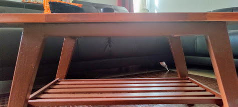

                        Yes, Cap I did build this! And came out pretty ok, if not a classic heirloom.

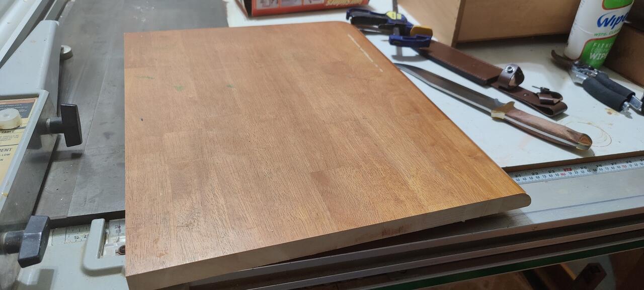

                        Click image for larger version  Name:	CoffeeTable02.jpg Views:	0 Size:	33.1 KB ID:	845891 Click image for larger version  Name:	CoffeeTable01.jpg Views:	0 Size:	93.2 KB ID:	845892​​​​ Click image for larger version  Name:	CoffeeTable03.jpg Views:	0 Size:	90.8 KB ID:	845893
                        Notes:
                        a. All the wood (yes, top, legs, aprons, lower shelf, everything) came from an old dining table top bought from Kmart. That last pic shows the leftover part of that old top. 1" thick wood laminated on some machine.
                        b. That glass measures 12x18". Bought it online for $65. Very good stuff - heavy and tempered and all
                        c. I was concerned about the finish, so spent a lot of time sanding the surface all around to bare wood. Looked great, but of course I did not take a picture!
                        d. SWMBO asked me to paint the table, not stain it. I painted the bottom part, and hated it so much that I did the top my way: stained with Cherry (non grain raising stain from Constantine) then poly.
                        Am waiting for an opportunity to take it back to the garage and strip the paint and stain it.
                        e. The outer angle of the legs worked out to 43 degrees.

                          Very good. Great adaptation of an existing design. I kinda like the longitudinal slats vrs the perpendicular….. just look at all the big words I did in a sentence! slats like I use. My slats are spaced to be used as a wine rack if desired. (Nothing says buy me like a nice piece of furniture with a bottle of 6 month old Mad Dog 20-20 setting in its wine rack!) I think I will build a couple of tables with slats longitudinal. Thanks for sharing!
