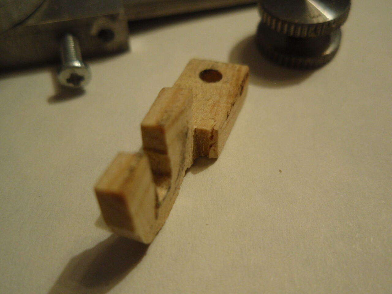

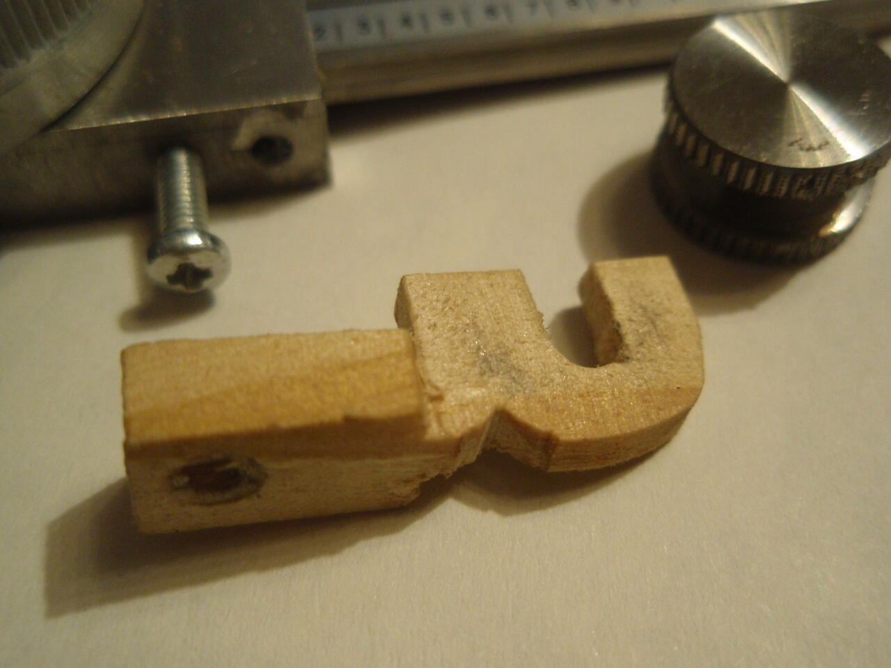

    Mine broke - not even abused, just fell apart. You can see the thumbwheel bracket is plastic and the one they currently sell is metal.
    Looks and feels nice, but hey your product is only as good as its weakest part and this bracket was severely underdesigned.
    Click image for larger version  Name:	P2080231.JPG Views:	0 Size:	91.9 KB ID:	842817

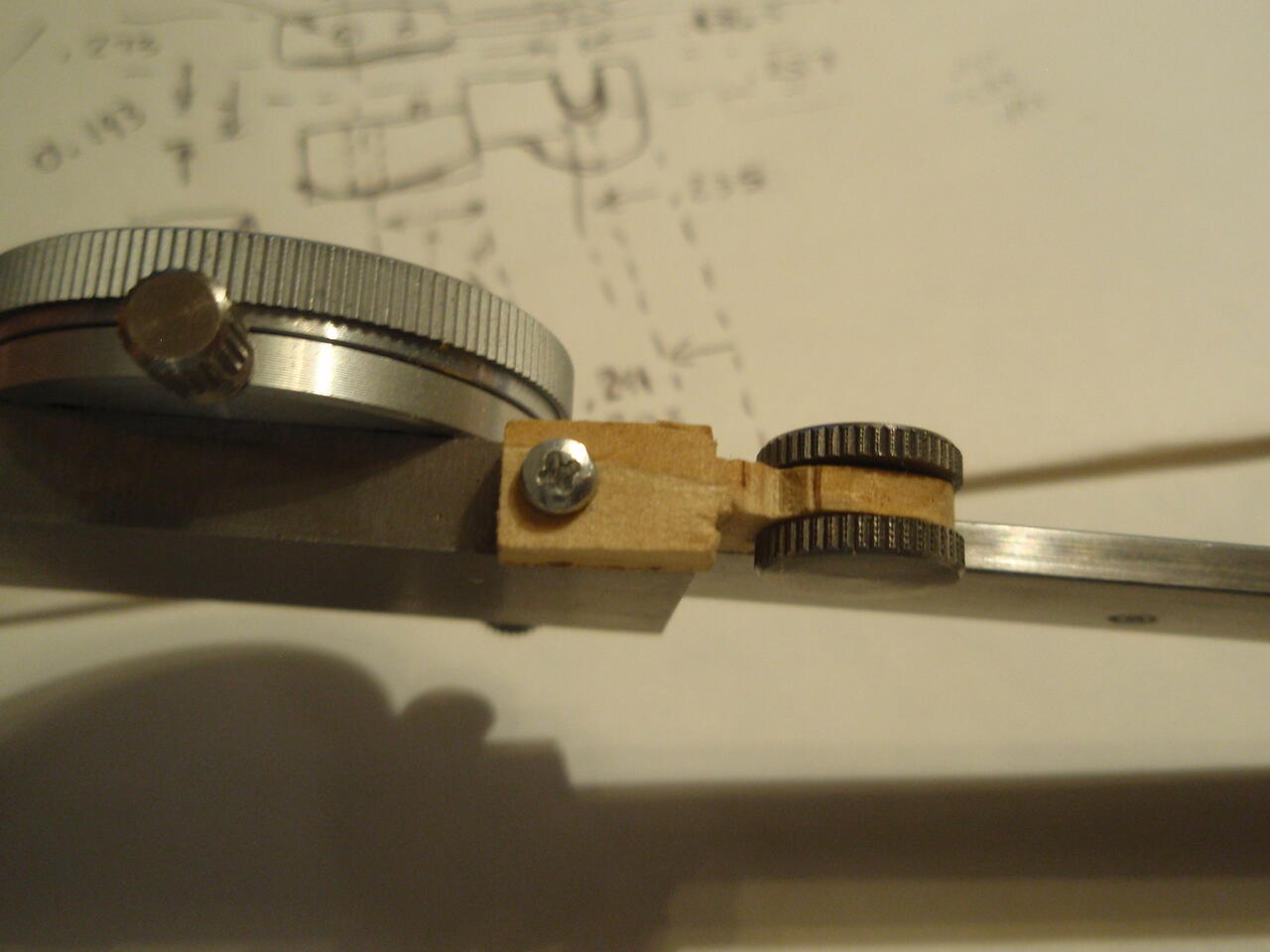

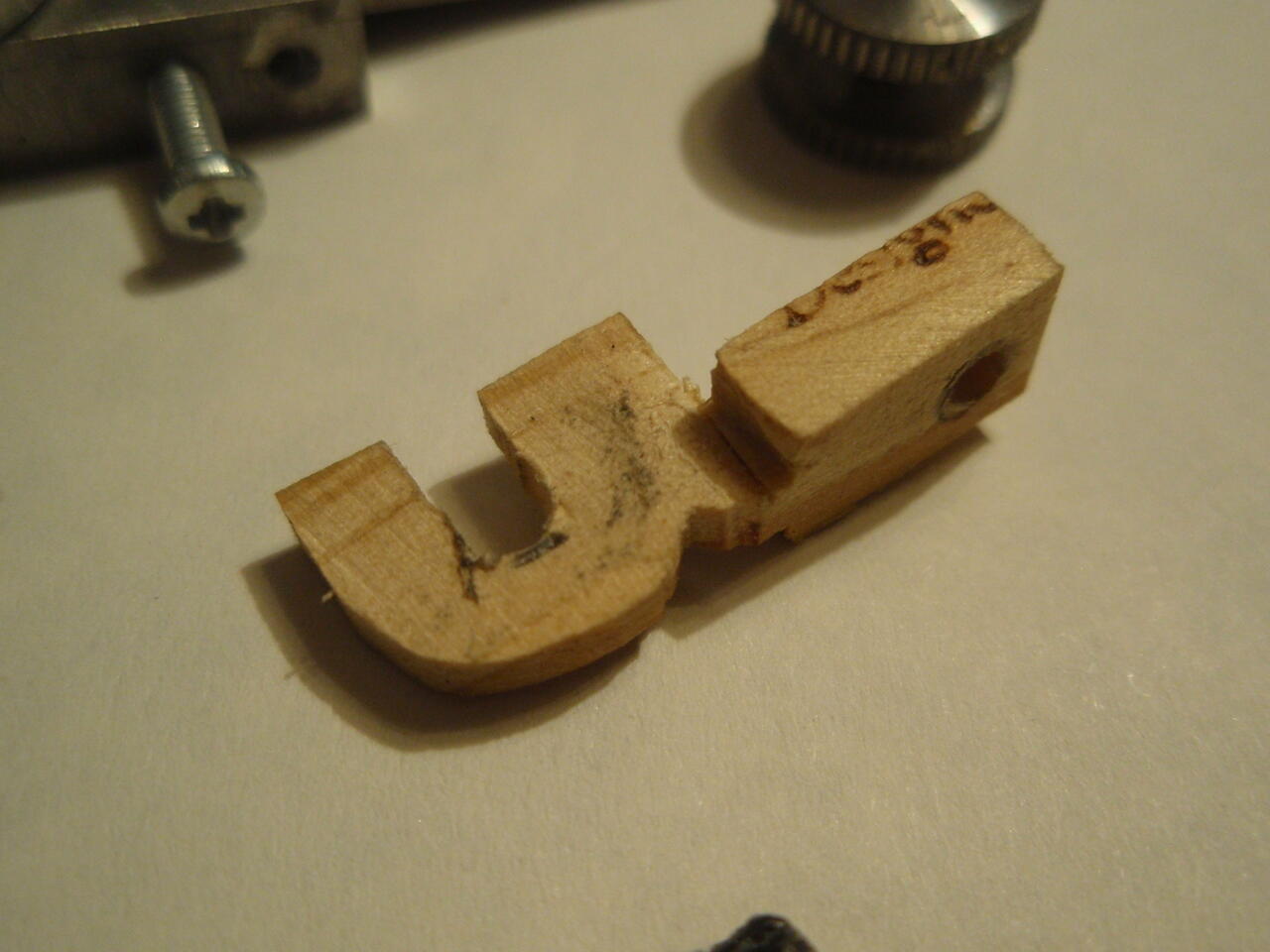

    Anyway, I decided to make a replacement part,,, took some measurements
    Click image for larger version  Name:	P2080232.JPG Views:	0 Size:	77.8 KB ID:	842815

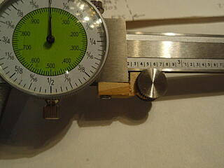

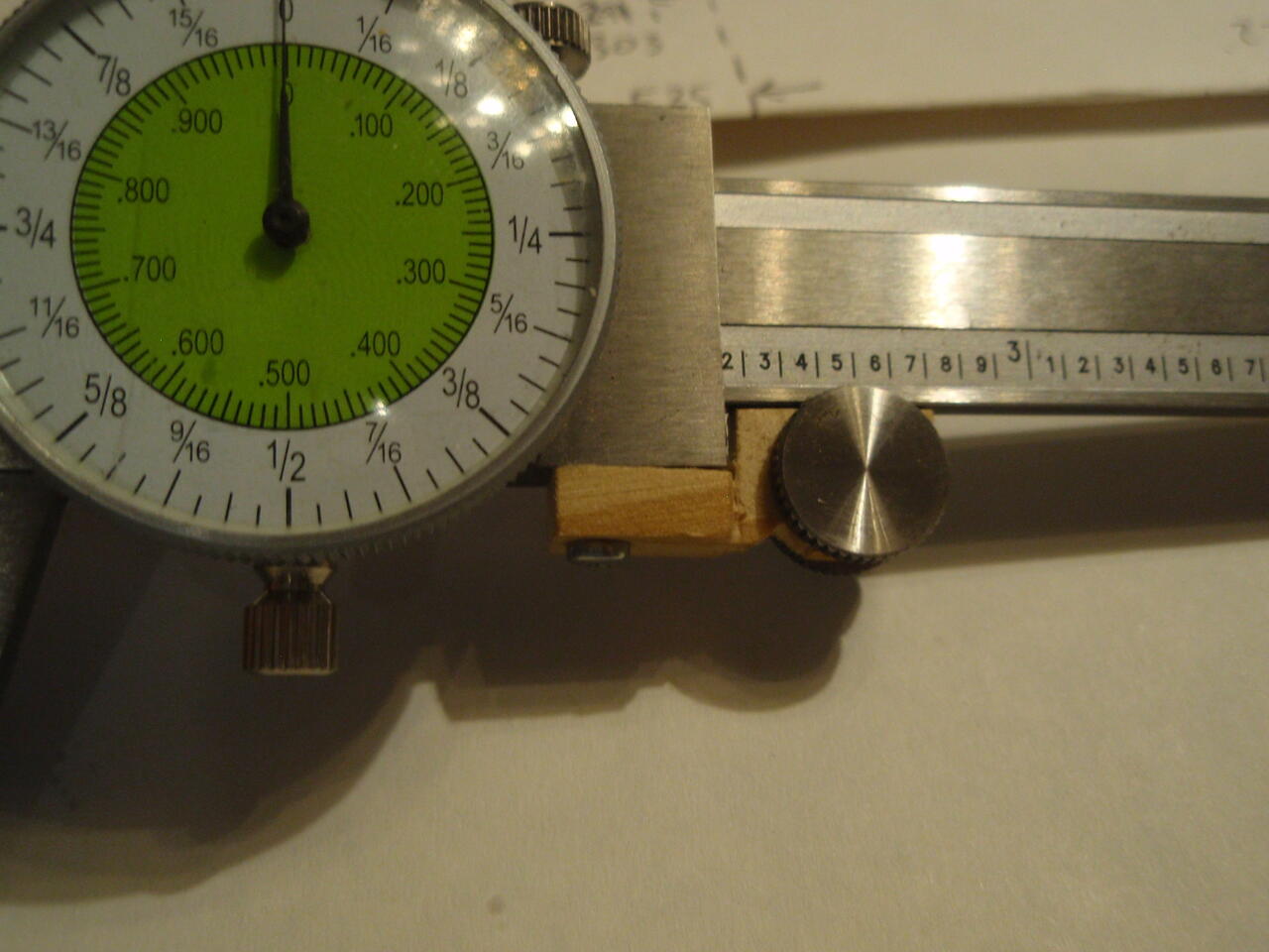

    and considered 3 D printing, using aluminum, but hey I have lots of scrap wood stuff.
    A hour later

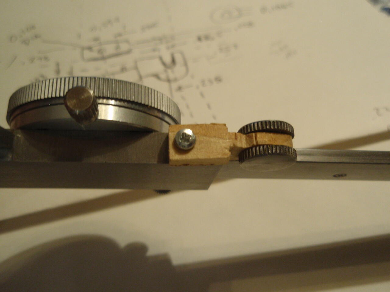

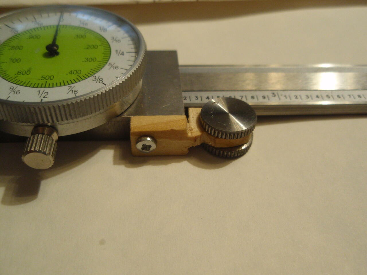

    Click image for larger version  Name:	P2080235.JPG Views:	0 Size:	79.8 KB ID:	842816 Click image for larger version  Name:	P2080233.JPG Views:	0 Size:	86.0 KB ID:	842819 Click image for larger version  Name:	P2080239.JPG Views:	0 Size:	69.4 KB ID:	842813 Click image for larger version  Name:	P2080236.JPG Views:	0 Size:	69.9 KB ID:	842820 Click image for larger version  Name:	P2080237.JPG Views:	0 Size:	95.3 KB ID:	842821
    Scrap of wood the about the right thickness. Drill press, 12" bandsaw, 1/2" chisel, sandpaper and needle files and of course, a set of HF digital calipers.
    Success! Works well. Smallest and most precision thing I have made from wood!
    I should probably smooth off the edges and paint it, but hey, it was fun.
