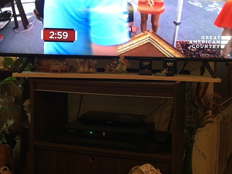

      Pappy (Don), I have the same thing... a old 30"-wide TV stand with a TV base like yours that have 34-35" apart forked legs just like yours.
      I have a black laminated particle board 36" wide just under the TV overhanding 3 inches on either side of the original TV stand.
      With the legs less than an inch away from the edge it seems a bit dangerous.
      I have considered doubling the shelf board for more sturdiness and also adding a lip (not just a wraparound) that will hide the edges and also keep the legs from falling off the shelf if someone bumps it.
      The other option is to double the shelf and them put depressions in the top shelf to retain the legs. As the legs have a shallow angle, it will take more like a wide stopped slot to retain them right.
      What has stopped me is that it takes two people to get the TV off and then put it back on and the missus can't really help me with the lifting.
      You might consider one of those two options.

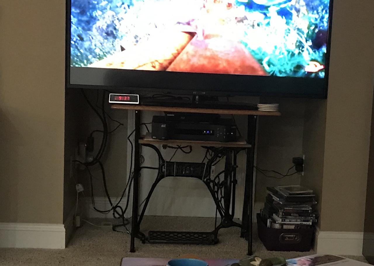

          Kinda like this? An old Singer treadle frame with 3/4” oak top and a 54” tv with swivel base. ( not a pretty combination for a living room, but it will work until I get a real cabinet built) I think you are overthinking the project.
            The base on the older TV is similar to yours. New stand will be similar to yours and your right, I am probably over thinking.(and over engineering). For the top of the cabinet I will probably laminate a piece of 1/2" to a piece of 3/4" plywood. The shelf will actually be the bottom of a box, possibly with a tinted glass door.
