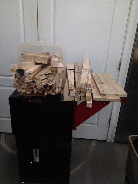

ID:	832989Who has ever questioned the amount of scrap is created when making a project?
    Recently I purchased 29bf @ $4.75/bf of 1 1/2” thick x 7” wide x 14’ long Ambrosia Maple to make tapered legs for Tiny Tables. I’ve always been aware that there was a lot of scrap wood created making tapered legs but I guess I’ve never gone to the trouble to bundle up the scrap beside the cut out legs. Here is what my 29bf of wood looks like. The pile of scrap in the clear plastic bucket is the scrap, the pile of squares are 7 sets of legs and the 2 boards on the right are going to be used for a table top. The 2 boards would have been 1 more set of legs but a really big knot and rotten spot made that section of board too short for legs. It’s hard to tell what the ratio of usable wood to scrap is but by weight I’d say it was 60% scrap to 40% usable wood.
    If this was a legitimate business venture it would surely fail.

    I can't see the picture.

      I guess it would have to depend on your project and of course the style you are looking to execute. Obviously, something like tapered legs, beveled panels, or turning is going to produce a lot more scrap than square legs, flat panels, and squared edges. There is simply no way to avoid this, IMO.

        If I'm using rough lumber (and we're not talking about the wastage from jointing and planing), I'd estimate at least 1/4 to 1/3 of the wood goes to scrap. Usually the board isn't wide enough to get one more piece or not long enough to get one more piece or you have to work around a defect. I have not been able to escape it unless I want to redesign my project to use different sized pieces of wood.
        For your tapered legs, I'm wondering if you could get 2 legs from a skinnier board by cutting out one tapered leg then flipping the offcut board end to end to cut the other taper. Maybe you're already doing this rather than cutting legs out of square stock.

          I don't know if you turn pens or not, but in the pen turning world, the most worthless cut-off knots, gnarly or punky wood (3/4 x 3/4 by 5 1/2 inch) turn out to be the most expensive pieces of wood if bought from those who sell to pen turners and sell for $5 to $7.50 each. (Plain straight pieces sell for $2.00 - $4.00). Pieces with live edges are cut lengthwise to allow half to be wood and half cast resin. These 3/4 x 3/4 by 5 1/2 inch blanks sell for $12 to $20. Cross cut pieces and mitered crosscuts (3/4 x 3/4 by 5 1/2 inch) sell from $2.50 to $5.00 depending on the uniqueness of the grain.
          AS to straight uneventful grain pen blanks, several people on the IAP (Pen turning forum) work in training under privileged and handicapped people. Several people donate their uneventful wood cut into blanks to these folks just for training. Even when a newbie comes on and asks about getting started, several people donate a couple of dozen blanks to help get them started. (Bear in mind, one very helpful condition is to label each blank with the kind of wood it is, either with a magic marker or label. IF they are all the same wood, just note it on the box or in communication.
          Looks like you have money on your hand that you don't realize!

                      These are tapered legs, 1 1/4” x 1 1/4” x 25”, tapering to 5/8”, cut on 2 sides. It would be nice if I could find boards 1 1/2” thick but the sources I have rarely have anything but 1” rough cut that I slice into 1 3/8” x 25”, plane then glue up into leg blanks. It seems that I always have an odd piece of waste wood after each slice. Then there is the 2 wedges created. The shavings from the plane and saw do go to the garden compost pile, but it still looks like money to me.

                        Looks like a lot of shot glass shelves in there if you make a shot glass cabinet or 10. Looks like there might be a lot of door frames for the same cabinets as well.

                            Most of the scrap is from roughing out the legs. 1 1/2”x 1 1/2” x 25” , milled down to 1 1/4” x 1 /14” creating 2 nice paint stirrers. Then 2 sides tapered 20”” down to 5/8””, creating 2 long wedges. Not much good for anything. Not even enough for a pen blank. I don’t throw them out because someday I might come up with a use for them.

                              Do you have a lathe? Because those look like pens waiting to happen to me...
