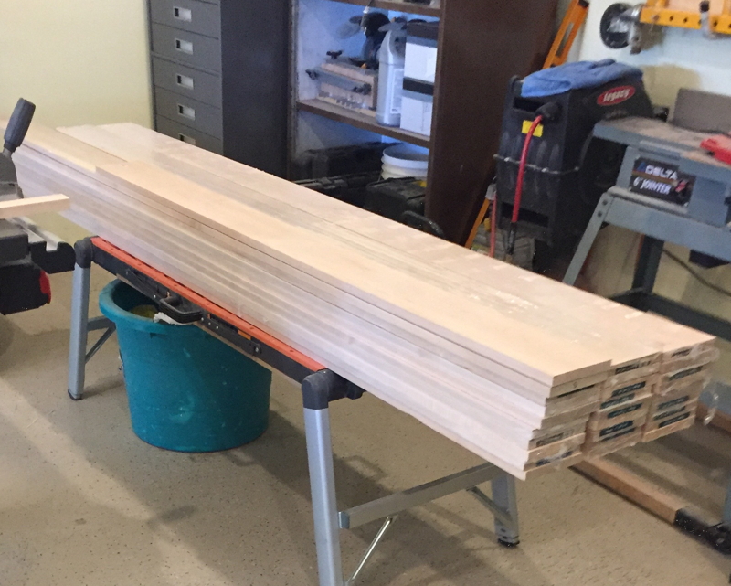

    This kicks off the final phase of remodeling our house. I just picked up the new kitchen cabinets minus the drawers. I expect assembly to take me about a month. They'll eventually be shaker style frameless.
    Cabinet Sides and Backs
    Doors and Drawer Fronts
    I always feel better when I have the material home ready to start making sawdust. LOML won't let me make the cabinets for this house (she thinks the kitchen will be torn up too long) or I would be trying to assemble a pile of material too.
    How are you going to cut it up? I would use my track saw a lot - and the BT3100 and router table for the doors. I did one kitchen a long time ago out of oak plywood and solid oak raised panel doors. It was a lot of work but I enjoyed it - and the result.

          The cabinets will be complete before we start the demolition so it won't change the time the house is torn apart, which will still be 6-9 months. I'll definitely be using my track saw to break down the sheets after I edge band the long edge of each one.

            The kitchen is 14 x 24 with an island and we're redoing the master bath as well so it is a lot of cabinets. Materials are about $7k but even Ikea and Cabinets to Go were $20k plus.
            Since the floor in the house isn't level, I plan to build a 4" base and level that to set the bases on. You're right, it saves material, makes them easier to build and easier to level the base. When my wife said she wanted frameless vs. face frame cabinets I secretly leapt for joy.
