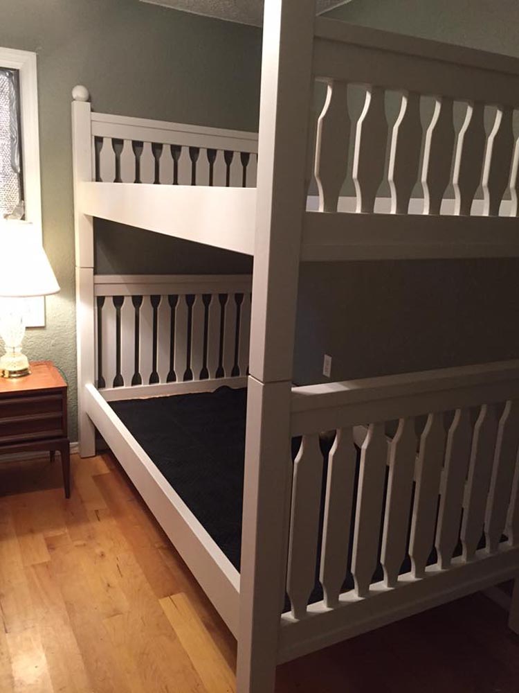

                          I had 80 spaces between the slats and bed posts in this link:
                          http://www.sawdustzone.org/filedata/fetch?id=801129
                          I placed one, lined it up, nailed it with Ryobi 16 gauge cordless nailer, added a spacer before the next. Not all were absolutely level. Even after assembly, most needed sanding to bring it level.
                          I have a Fein, the original multi-tool. It took care of it without a problem. I think I used 2 pads total. The space would not allow sanding pad to get totally between them, but the triangle allowed me to turn it to cover the space. I had to sand each spacer from both sides. Worked well. I am not sure how much difference in power and finesse the other multi-tools have, but the Fein didn't skip a beat in bringing everything into size and control was fairly easy.
                          Fein's pad does not have metal, but a thin hard nylon like base to its hook & loop pad.
                          Before I got started with the sanding, I kinda regretted not making sure everything was level to begin with, but I made up my mind that I had to do it and it took about 2 hours. As one friend said to me once: "My dad always told me - Son what you need to do is Just Get Started!". I never forgot that wisdom and I made up my mind to go and do it, but I had to just get started.
