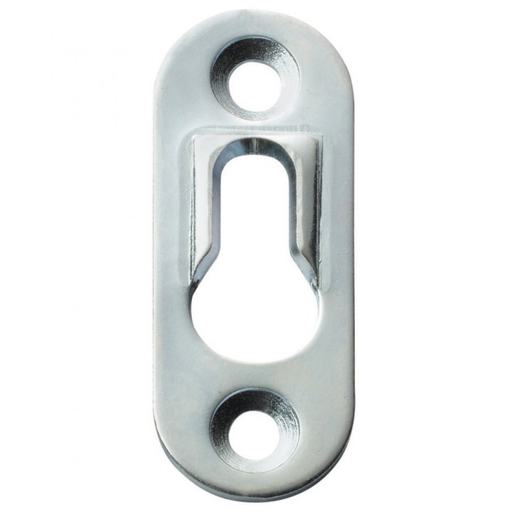

    • 3752
    I've had really good luck using 2 keyhole plates on the back of heavy wall hangings. They are available at Lowes, HD, Rockler and are probably for sale at hardware stores.

    • lombard
      • 35
      • Merritt Island, FL
      Almost exactly what I'm looking for. I can make due with that. May use several of them, hog out a bit of the back of the pieces (to allow a nearly flush mount), install the hangers, then fabricate a plate with matching screws that can be hung on a wall however the recipient prefers. Mount the plate, hang the gift piece on it.
      I must have been having a brain fart when I was searching. Coulda sworn I did a google search for keyhole hangers. Guess not.
      Thanks!
