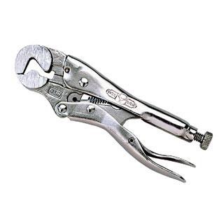

                  • 3791
                  For the stubborn nail or brad that just won't come out or the pliers slip off i have several sizes of this type Vice grip. It has a nice flat fluted grip surface that you can clamp down hard on the stubborn nail. Yea, I'm all about using the right tool for the job and this was designed for really gripping a nut or bolt head but it has the round edges that jack the nail right out of the wood. I have a 1/8" piece of ss about the size of a coaster that I lay on the wood to keep from making it up. Using old barn wood for my projects requires the use of a lots of different nail pulling tools. When I am finished pulling nails i set the board on 2 5gallon plastic buckets and sweep it with my metal detector, then pull the rest of the nails I missed.

                            • 3791
                            In my experience a stubborn Brad or one that had been in the wood for a long time is there to stay and usually they break off. The vice grip I have the most success with is this one, the one I forgot to post the photo of.
